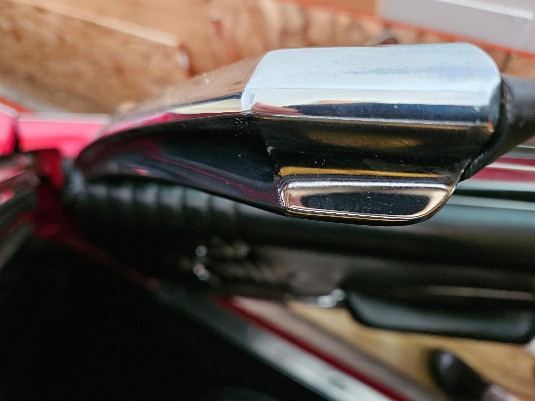

I just went out and took pics of my windows (68 Holiday). The drivers side roof rail seal profile looks different than the drinkers side. I've been aware of this since day one but never really investigated it.
Mind you this is an earlier production Z code 68...09C.
Im 99% confident the drivers side is OE (born with) from the Fremont plant. I replaced the drinkers side with a 68 Chevelle bone yard assembly, as the car got broken into many years ago while at a Dead concert. The thieves busted it out to gain access to my stereo. I still have the OE frame.
Not 100% sure but the driver side profile looks like it could be for a vert?
Time for all you 68 owners to observe and report out for data purposes....Mike.
DRIVERS SIDE
DRINKERS SIDE
