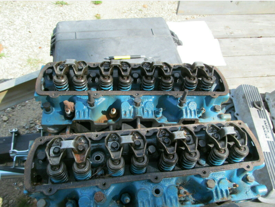

Next item on the list, Rocker Arm Adjustment. She will be running right before spring.

Glad you got it fixed. Stock rocker arms are fixed, no adjustments.
Old Jan 17, 2022 | 10:13 AM
droldsmorland's Avatar
CH3NO2 LEARN IT BURN IT
Posts: 5,636
From: Land of Taxes
The KISS method is always the best troubleshooting advice.
FYI unless someone installed aftermarket adjustable rockers or push rods there is nothing "adjustable" under the rocker covers on a stock 350 like there is on an Old School SB Chevy.
If you hear rocker noise you need to replace the worn parts (which will lead to MAW$). Make sure you are not hearing an exhaust manifold/head pipe leak.
You could get temporarily lucky replacing one or two trunnions (pivots) and rocker sets. But if it's making a lot of noise it could be deeper or more than just R&R-ing a few arms and pivots. Inspect the wear points on the pivots and rockers. Make sure the exact same parts go back in the exact same spot if you reinstall the used parts to include push rod ends. You will want to roll the pushrods to check for straightness.

Oooph. Thanks for saving me the time and preparing me for the cost. I’ll browse the forum for similar topics. Thank you.
