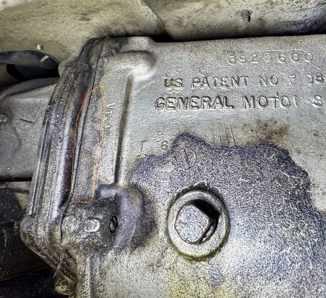

The transmission case is a 1970 and is coded as an M20. "P0K24A"
You would have to clear some more goo away to see if it's stamped with a VIN. Either way it's not the original trans for the car, though it could be an original 4spd car.
