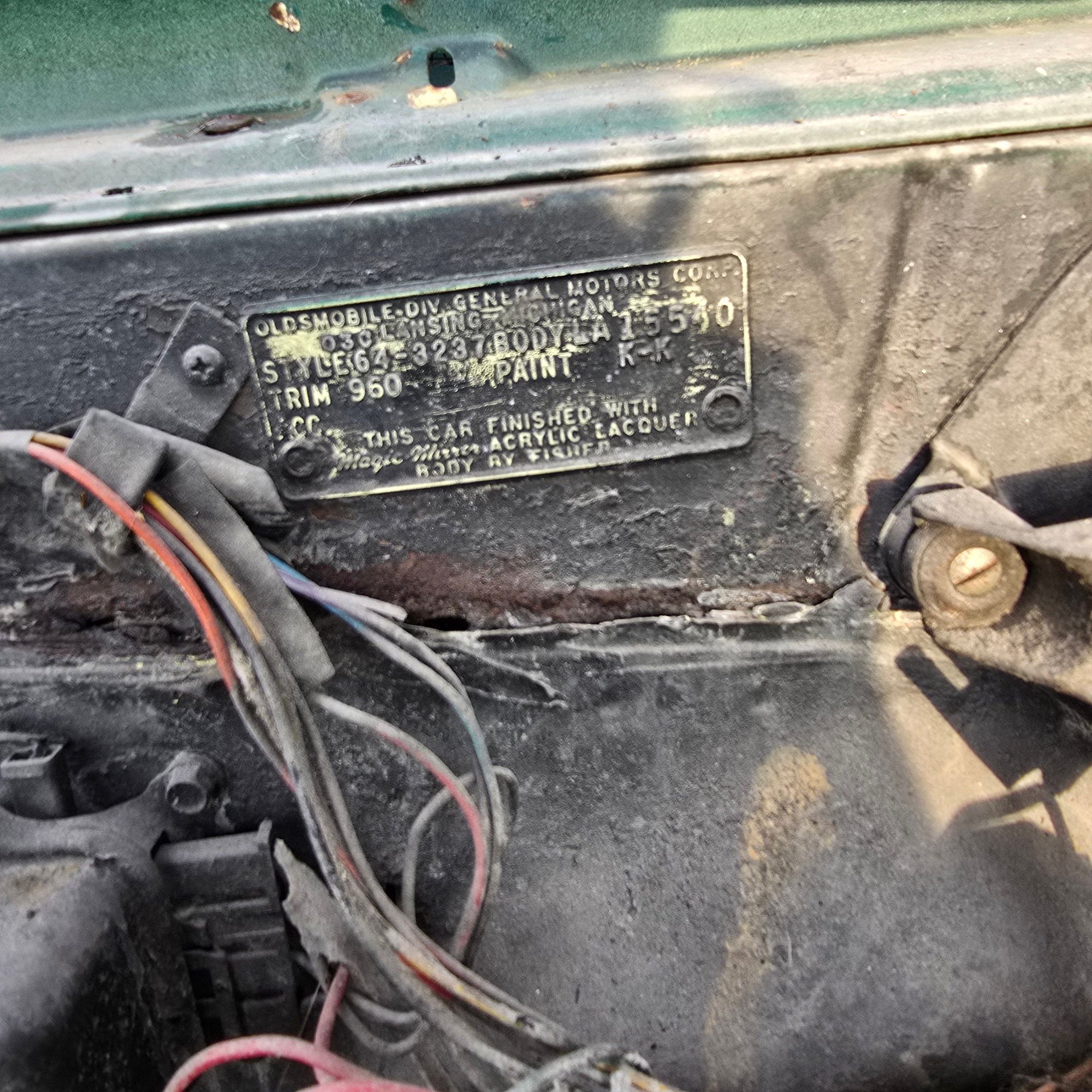

Can some decode this for me

Build Date, 3rd week of March
1964
Holiday Coupe
Built, in Lansing
Fisher Body Unit Number (15540)
Trim, Black (interior)
Paint, Tahitian Yellow, both top and bottom
ACC (Accessory) factory installed options

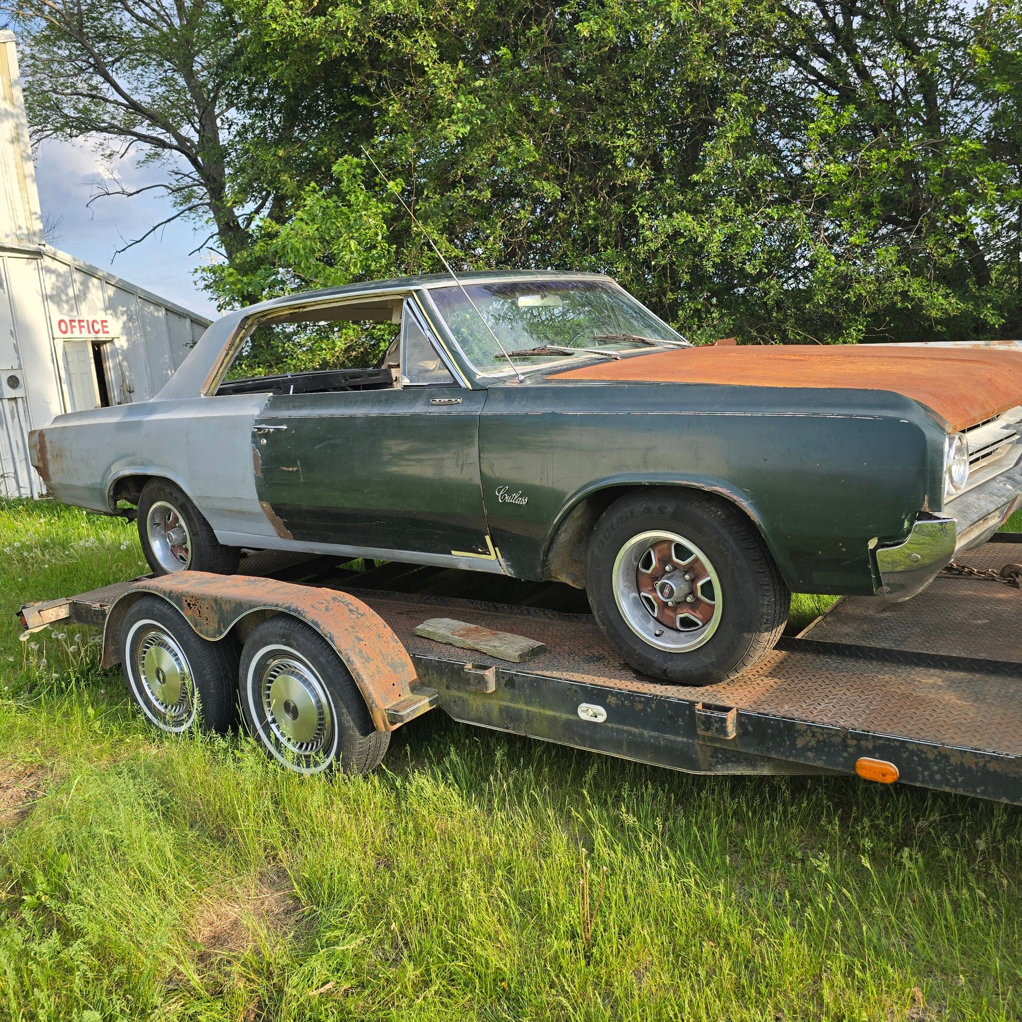

I didn't see and holes punched for trim.
so .I'm assuming this was a trim delete

There is no such thing as a "trim delete" option. 3237 is a Cutlass Holiday Coupe. Every 1964 Cutlass left the factory with the same trim. In fact, except for the base F85 models. every single Olds A-body in 1964 came with the side trim. Either the holes were welded up or the cowl tag has been switched to an F85.

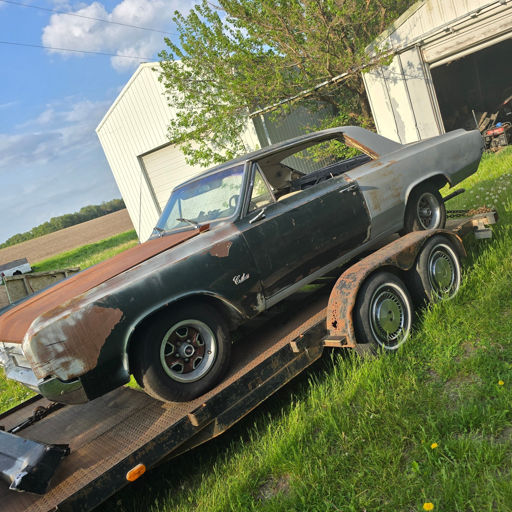

The Cutlass emblems aren't in the correct place either, and the emblem on the passenger side appears to be from a 1970s car, so I expect those green doors and fenders are not from the original Tahitian Yellow car. They may have come from an F85 originally. There also appears to be a skim coat of bondo on them. Check the rear quarters for filled holes. Also, what is the VIN? The second character of the VIN will be a 0 for a base F85, a 1 for an F85 Deluxe, and a 2 for a Cutlass.

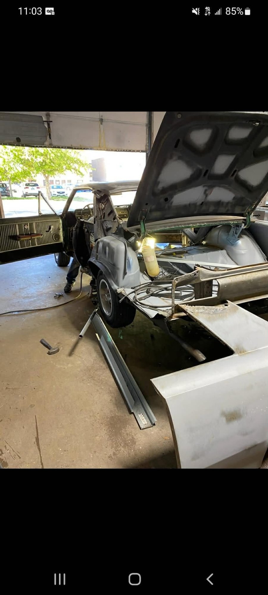

the rear quarter are new to the car
this car was more solid of a project than the 66 i have ,I wanted to do a project with my son. The floors and trunk floor are new along with the quarters. Trunk lid and hood are also solid.

I don't think it's "factory" installed options. I think it's options that were installed by or provisions made for by Fisher Body. Seat type, window tinting, trim options, that sort of thing. For example, many cars had various engines as options. None of that is in the ACC section of the cowl tag.

Correct. This car has no Fisher-installed options other than the base equipment for that model.

A real 1964 442 would have the 2L ACC code at a minimum to show the cutout in the floor pan for the four speed shifter. Of course, there were a lot of 1964 Olds A-body cars built with four speed transmissions that were not 442s. These also have the 2L code, so this is not proof that a car is a real 442, but the absence of the 2L code proves that the car is NOT a 442.
