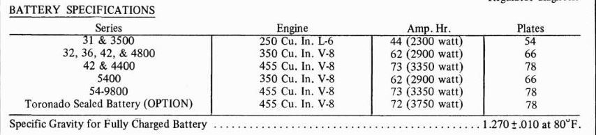

Originally Posted by Mossy
Battery is shot and need the specs on a replacement. 1971 S model with the 350. Thanks
From page 12-79 of the 1971 Olds Chassis Service Manual. A '71 Cutlass S is a 36-series car, so you want the second line.

Thanks everyone. I was in a hurry and ended up with a group 24 with 700cca/875ca which is what interstate recommended. But it sounds like 36 is ideal?
