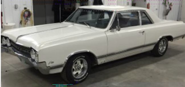

I just acquired a 65 F85 Sports coupe V6 2sp auto. ( It looks like the V6 is called an F85, if it was a v8 they called it a Cutlass?). Anyway
this cars has std brakes and std steering. Power brakes I can figure out but how hard is it to upgrade to power steering?

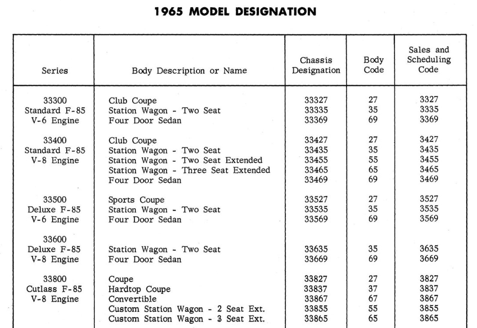

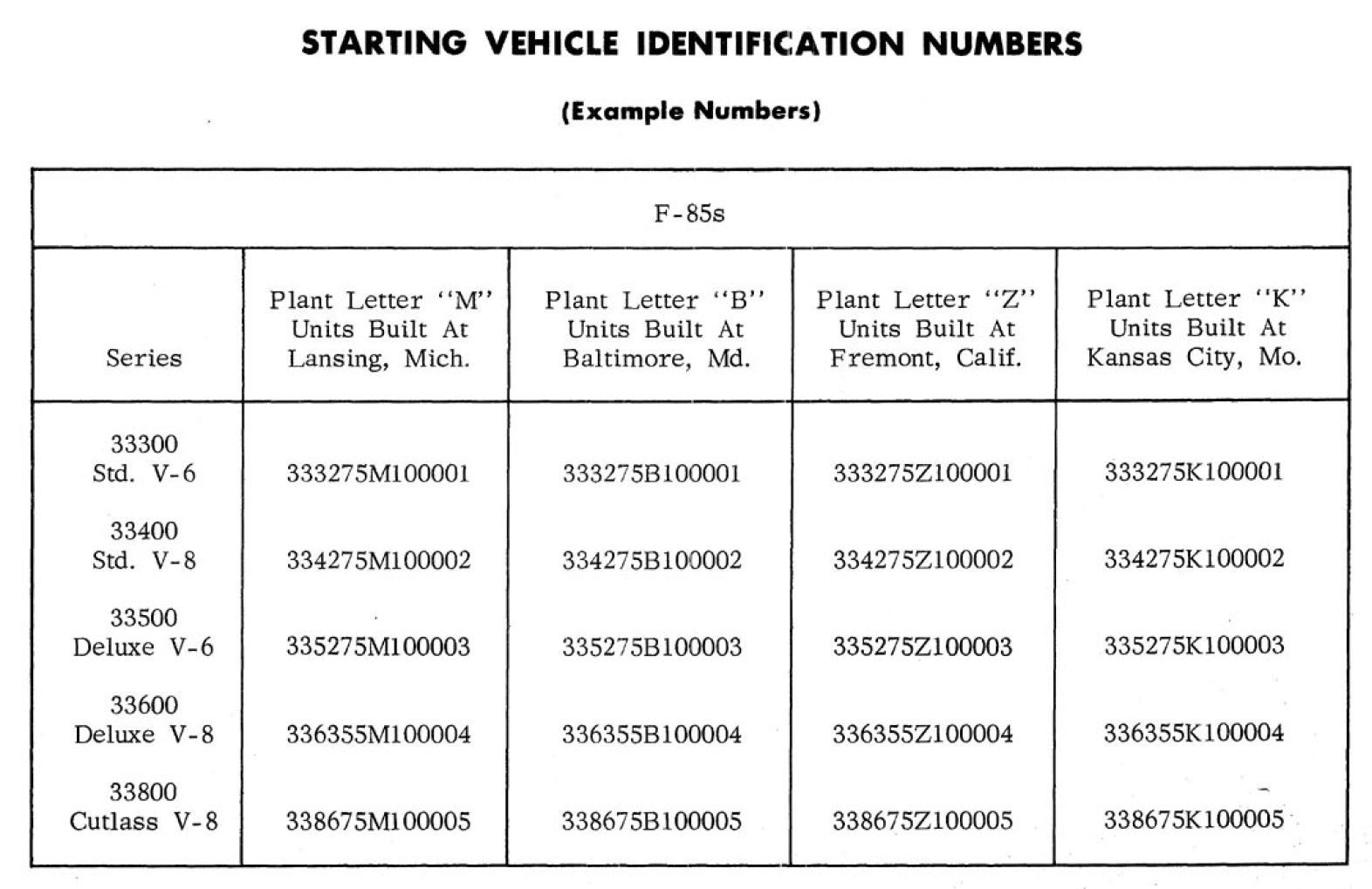

The VIN. Those "Model Code" numbers in the table represent the second through fifth characters of the VIN. Your photo shows that the car is NOT a hardtop, by the way.

Olds used both Sport Coupe and Club Coupe to refer to post cars. Typically the lower end cars were club coupes and the higher trim cars were sport coupes. As an example, the V6 Sport Coupe was really a Cutlass Sport coupe but with a V6 instead of the Cutlass V8. Club Coupe and Sport Coupe body shells were exactly the same. Hardtops were called Holiday Coupes in Olds marketing speak.

From the '65 Olds Prestige brochure. The OP's car has the chromed, rather than body-colored, B-pillar, which makes it a Sports Coupe and not a Club Coupe. His car is like the light green one shown in the brochure. The Club Coupe, shown at the bottom, has a body-colored B-pillar.

The car is just home. Quick check of the plate says 33527. That would be F85 Deluxe, Sports Coupe.
