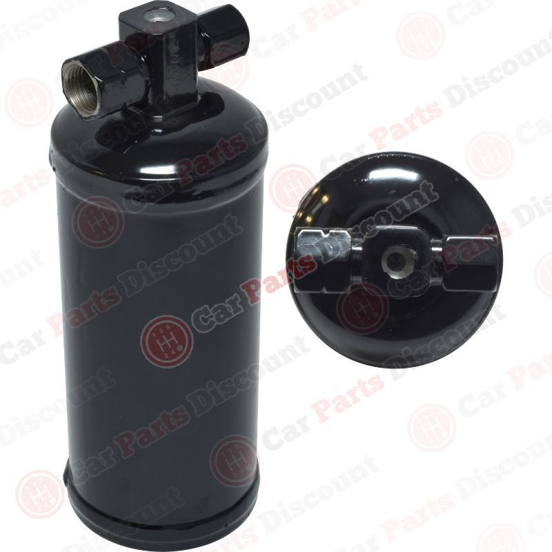

So without gauges, you should be able to look at the small round window on the drier to assess the state of charge. Bubbles or streaking in the window mean low charge.
Below is a pic of the drier I grabbed off the internet showing the window on top.

My cousin, the previous owner, said the ac has frequently been a problem over the last few years and her mechanic said it had a leak somewhere.
It seems the drier has been replaced with one that doesn't have a sight glass. According to her records she had a new drier and rebuilt compressor installed in 2008 and again in 2011. Evaporator core also replaced in 2011.
