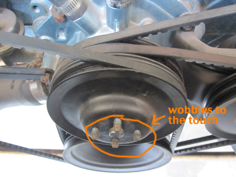

Well, after further review, it looks like it is the water pump. I watched it and it definitely shifts when turned on and the noise happens when in sync with the rotation and tilt of it (tough to describe) so it looks like the barrings are shot.
So that is going to be a 100 piece, and will need to get paint to get it to match. Is it a tough piece to replace myself or should I take it to a garage?
My mechanic skills on a scale from one to 10.. .probably a strong 3 haha. I am good and following instruction.

Just to make sure, I took better footage that shows the water pump kind of tilting which I believe is the issue. Can we say that replacing that will fix it 100%?
Here is the video: http://www.youtube.com/watch?v=ayvTIxBEoPg
Thanks for all the help
@highlander, thanks for the heads up.
Old Aug 11, 2010 | 03:49 PM
citcapp's Avatar
Joined: Nov 2007
Posts: 9,127
From: Rathdrum, Idano
The water pump is shot plain and simple that's why it is wobbling. Replace it.

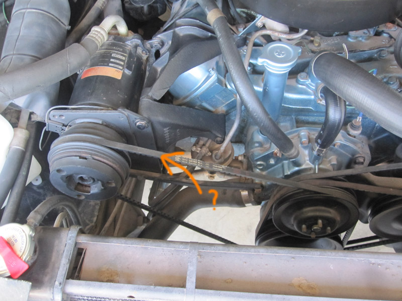

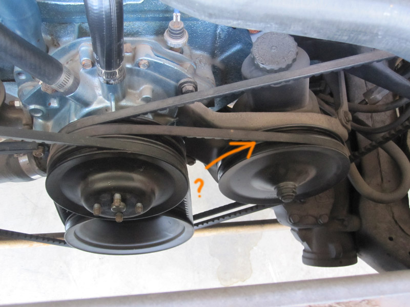

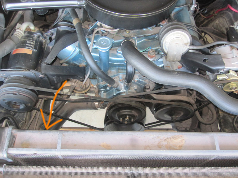

So my first attempt didn't get that far. How do you take off the fan and fan shroud. I unbolted the shroud, but can't take it out because the fan is in the way (along with the radiator). After I unbolted parts of the fan, I tried moving it and it wouldn't budge. Am I on the right track?
Old Aug 26, 2010 | 01:34 PM

<snip> How do you take off the fan and fan shroud. ... Am I on the right track?
Yes, you're on the right track. You have to reach inside the fan shroud, take off those 4 bolts (nuts?) you have circled, then remove the fan and fan clutch as a unit. It helps if at least one of the belts is tight enough to help hold the fan, but loose enough to let the fan rotate to access all of the bolts. The shroud can then be lifted out. (Sometimes the fan and clutch is really stuck on there, but you can get them to release from the front of the water pump.)

The only thing I can think of being a problem is putting the power steering belt back in.. Does anyone know an easy way of adjusting the power steering belt? I couldnt figure it out when I had my car all torn apart. I actually had to take my car to the mechanic after putting everything back together all because I couldn't get this belt on.. 71 cutlass

There is a 9/16 bolt behind the pulley that you need to loosen so you can tension the belt.

I see some of the questions I am going to ask have been answer (above) but I just want to double confirm my next steps on this. My wife and I were finally able to get off the fan so now I just want to double check on some of the next steps.
Just to confirm, because the water pump shaft seems to wobble, this is probably because the internal bearings are shot?
Taking off the alternator's belt seems easy, just unbolt the adjustment to let it slide inward.
Where do I go to loosen the A/C belt?
Also, where do I go to loosen the power steering belt?
After those are off, I need to drain the radiator fluid (or before taking off the belts?) I assume I should just do this at the lowest point possible?
And after that, its pretty much taking off all the other tubes and such connect to the water pump then cleaning it as mentioned above.... then all that in reverse.
Thanks for the help in advance. I wish I new more about this haha.
Old Aug 28, 2010 | 10:17 AM
svnt442's Avatar
Posts: 4,293
From: Palm Bay, FL

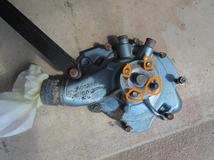

You need to put at least two of the nuts back on the pump and reconfirm that it's loose. The pulley will wobble like that as it is loose.
You need to loosen both the lower bolt and the pivot bolt for the alt to move freely. And forget to disconnect the negative battery cable first.
The adjustment point for the A/C compressor is almost straight down from the top bolt on the bracket. You can see it in the picture. Loosen both bolts and the compressor should move. It's been a while since I've seen one in person so there may be a brace on the back as well that would need to be loosened.
The P/S adjustment bolt is located behind the pulley. You'll need a 9/16" open end wrench to get at it.
The pet-**** is on the drivers side (I think) and that is where you drain the radiator if you need to.

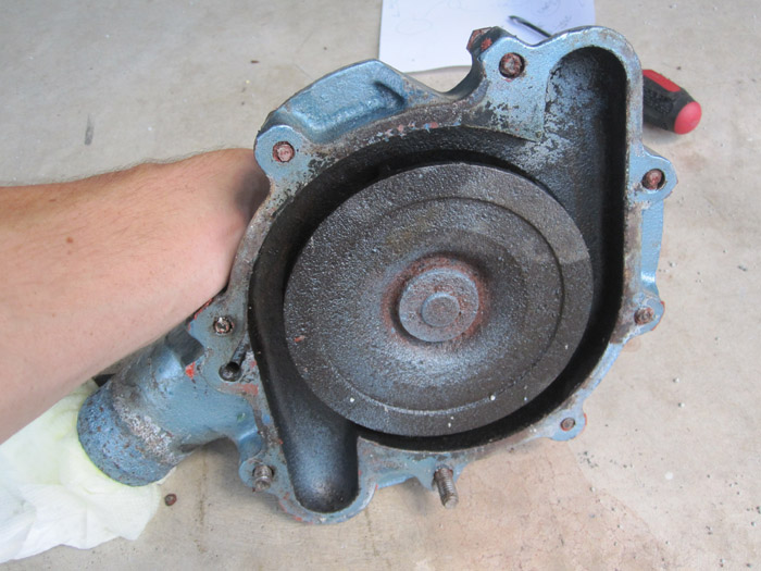

Looks like its the shaft of the water pump that wobbles:
http://www.youtube.com/watch?v=ayvTIxBEoPg (from above)
Since I've never seen the inside of a water pump, is the entire thing going to need to be replaced or just a section?
Old Aug 28, 2010 | 10:51 PM
svnt442's Avatar
Posts: 4,293
From: Palm Bay, FL
YIKES!!!! That squeaking is the impeller hitting the timing cover I think. You might want to replace that as well.

The water pump is replaced as a unit.( I remember when you could rebuild them!) There is only the housing,impeller,shaft and bearing-fairly simple.And as avove,check the plate behind the pimp to make sure ot isn't scored. On lubing the hoses,use the grease,don't use any oil.I have see quicky mechanics just stick a finger in motor oil and swipe it around inside the hoses to get them to slide on easier.That is the beginning of the end for the hose,they don't mix. The small bypass hose can be hard to get on,take your time and make sure it it seated all the way on. If the hoses need replacing,do it now,be carefull if you replace the heater hoses.Do NOT just take the clamp off and twist-you may end up with the neck of the core also.Personally,I like to cut them off about an inch past the end of the inlet/outlet,and carefully slice the hose to remove.It doesn't take much to cause a leak there. ---bil

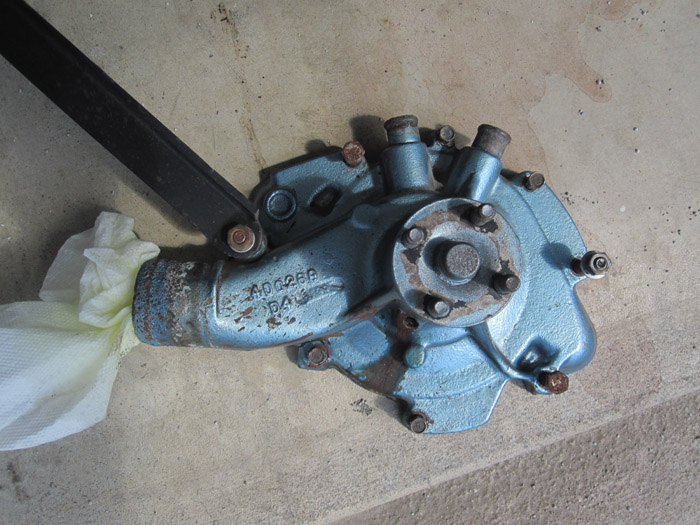

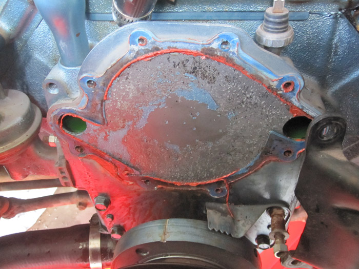

I was able to successfully take off the water pump with your help. In the meantime, I went ahead covered the holes to prevent possible rust since I don't think I can make it to autozone to get parts today. So which grease should I get for putting the tubes back on? All but the radiator tube was fairly simple to get off. This may also sound dumb, where exactly are the gasket and thermostat?
So just to make sure, my next steps are:
1)Buying pump, paint so pump can match, grease and sealant (blue goop) . (right? what type of grease and sealant)
2) Paint pump then clean both ends,
3) Apply sealant
4) Bolt new pump
5) Grease tubes and put back
6) Put back belts
7)Put back fans, fan guard, and other
8) Put in radiator fluid
9) Drive happily
Am I missing anything and is there any else that might cause problems?
Again, thanks for all the help. After this I plan I posting "instructions for dummies" to maybe help the next new cutlass / mechanic to try this out.
(Orange glow is from a sled I used to catch the radiator fluid.

Got a new pump, and bought the correct paint for my engine color. I unfortunately found out that my engine was actually painted the incorrect blue when it was rebuilt, but own well. My question before I start having to put this on... is how to I get these bolt / screws off the front of my old one on too my new pump without stripping the screws (was able to get two off, but the other two are stuck in the old pump pretty well)
(old pump)
Old Aug 31, 2010 | 08:22 PM
  #36
bil's Avatar
bil
Joined: Aug 2010
Posts: 301
From: Westmoreland,NH-Malibu CA
Spray some Breakaway or similar product,let soak.Tap around the studs lightly-not the studs themselves.You want to kind of shake things up and let the penetrant work.Take two nuts that are the right thread,put one on,them thread the other down to it.Start to turn the BOTTOM nut off.This is called double nutting,it can also work to lock a nut in place,The pressure of one against the other keeps it from turning.Make sure you arent twisting the stud off. Now that you know how to do that,you may want to take the easy way,take one of the studs you removed,and get two more at a hardware store.No cheap Chinese junk,and the same length.Remember that they are spinning and the wrong size can cause balance problems. ---bil

Great new guys! Buddy of mine and I have successfully changed the water pump!!! (I think)
Now the slightly bad news...
1) didn't have the alternator belt on tight enough, it jump off and I pretty much have to replace it.
2) Probably need a little more radiator fluid
3) Accidentally left my glove box open and the little light killed my battery.
But after charging and testing I tried for the first time to start the car.
A little smoke came out and it didn't sound so great.
10 minutes later, smaller amount of smoke, still died.
10 minutes later again, started up great! Sounded 100x better then before, almost like a new car!
I hope I did everything right. Thanks for all the help guys! I'll try to post picture of the entire process for the next guy that needs a water pump replaced.
