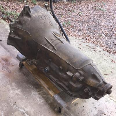

Anyone use a Hughes TH 350 with the 2.75 first gear? Thinking about using it with a Gear Venders.

Trying not to mod too much from stock architecture. I would go 200R4 if it was bucket seat console shift but not a great solution to the column shifted bench seater plus the TV cable bullshit. 44k mile untouched barn find too
