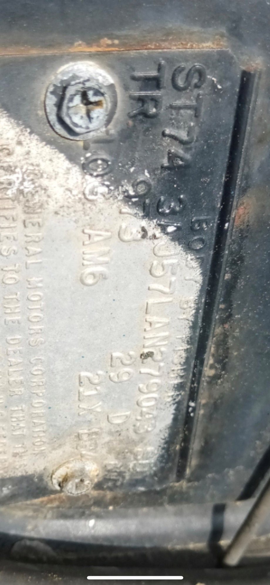

I'm in the process of purchasing a 1974 Cutlass with a 455.
the cowl tag has the following:
ST74 3AJ57LAN279043
TR 973 29 D
L0G AM6 21X B34
Can you help confirm if a 455 belonged in the car?

Nothing on the cowl tag tells you the engine size. The fifth character of the VIN will tell you the engine.

As I stated in response to your other post, you're looking for a T, U or V code in the fifth position of the VIN. An X also designated the W-30 455, but I don't believe that was available in a Cutlass Supreme.

Your VIN plate will read: 3J57U if car came with L75 455, and 3J57V if a L76 455. Both 455s came with dual exhaust in the A-body cars. K is 350 single exhaust, M is 350 dual exhaust. All 1974 engines were 4 barrel carb. 4 in 6th position designates 1974 model year and M in 7th position = Lansing assembly plant.
ST74= 1974 model year
AJ= Cutlass Supreme, 57= notchback coupe, LAN= Lansing plant, XXXXXX= Fisher Body sequence number which will likely not match the VIN.
TR973= blue cloth and vinyl interior
PNT 29= Eclipse Blue (dark metallic blue); D= blue vinyl roof cover
AM6= 60/40 divided power seat w/center armrest
B84= body side and front fender mouldings
Can't find LOG or 21X option codes in my books. The 21X has frustrated a lot of us.
*edit* looking closer that's 10G. It's in the time built field but 10G makes no sense as there weren't 7 weeks in October (10). Possibly 10C, 3d week October 1973?

21X indicates the "Big Four" interior color package. The dash, kick panels, carpet, and parcel shelf (the four items in the "Big Four") were a darker blue than in standard interior cars.
