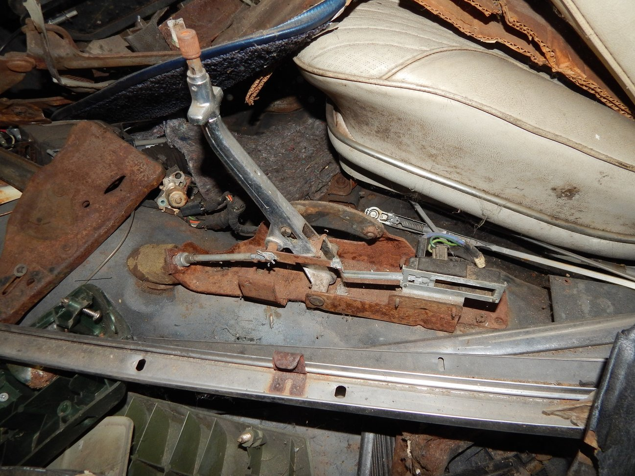

Working on a 1970 Cutlass Supreme. A bit confused on the neutral safety/reverse light switch. As in where is it? In the console?
This car is a floor shift automatic with the original shifter. It has been converted to a 2004R.
I am trying to get the reverse lights to work but, kinda want to know where exactly the switch is before
taking a bunch of stuff apart.
The nuetral safety feature works-it starts only in park or, neutral so, that means the switch in there but, I have no power to the reverse lights.
Fuse is good so, switch wiring....

My 1970 Supreme had a Dual Gate and the switch was behind the shifter, under the console. I think the regular floor shift cars have the switch in the same location, but use a different switch than the DG versions.
edit:
I found this from an old thread. It's a 69 but should be the same:
https://classicoldsmobile.com/forums...switch-123947/
edit:
HeyThanks!! That helps alot!
