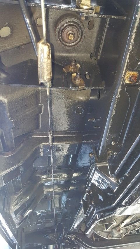

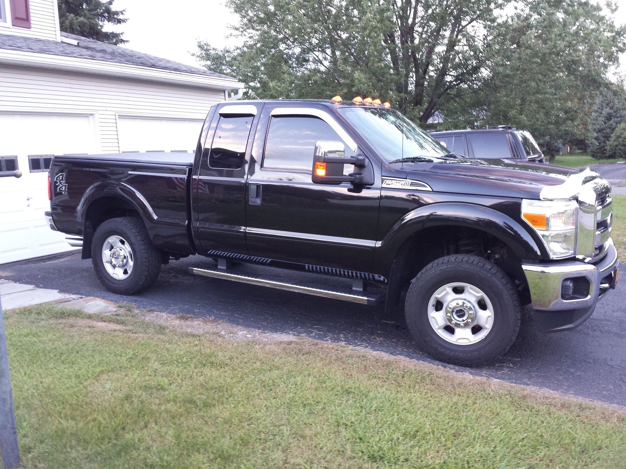

Never put a salted frozen vehicle into a heated garage. The heat accelerates the oxidation.
Anything that lives in a humid, damp, wet, salty environment needs to be treated with a corrosion retardant such as Krown, LPS, Corrosion Free, Fluid Film, or similar...NOT ZIEBART. Tar belongs on the driveway not your undercarriage.
How can anyone take a $60-80-100K truck out into a corrosive environment without treating it. Trucks and cars are just too expensive to sacrifice. Within 5 years a vehicle will be rusted. Not through the fenders yet, but gone enough to not come back.
You will double triple its life and trade value by treating it. Brake fuel lines stay nice. No crust. My truck is worth more than I paid for it.
The Krown has preserved it. Its not 100% desert spotless but there's zero rot.
This 2011 was driven daily until 2019, in salt. 95K miles. Its my huntin haulin babe trollin feel good driving a real freeman truck truck.
Freshly Krowned: Note the condition of all the fasteners and the Ford plastic rear well liners. Those wells go a long way of diverting the **** from the underside of the box.

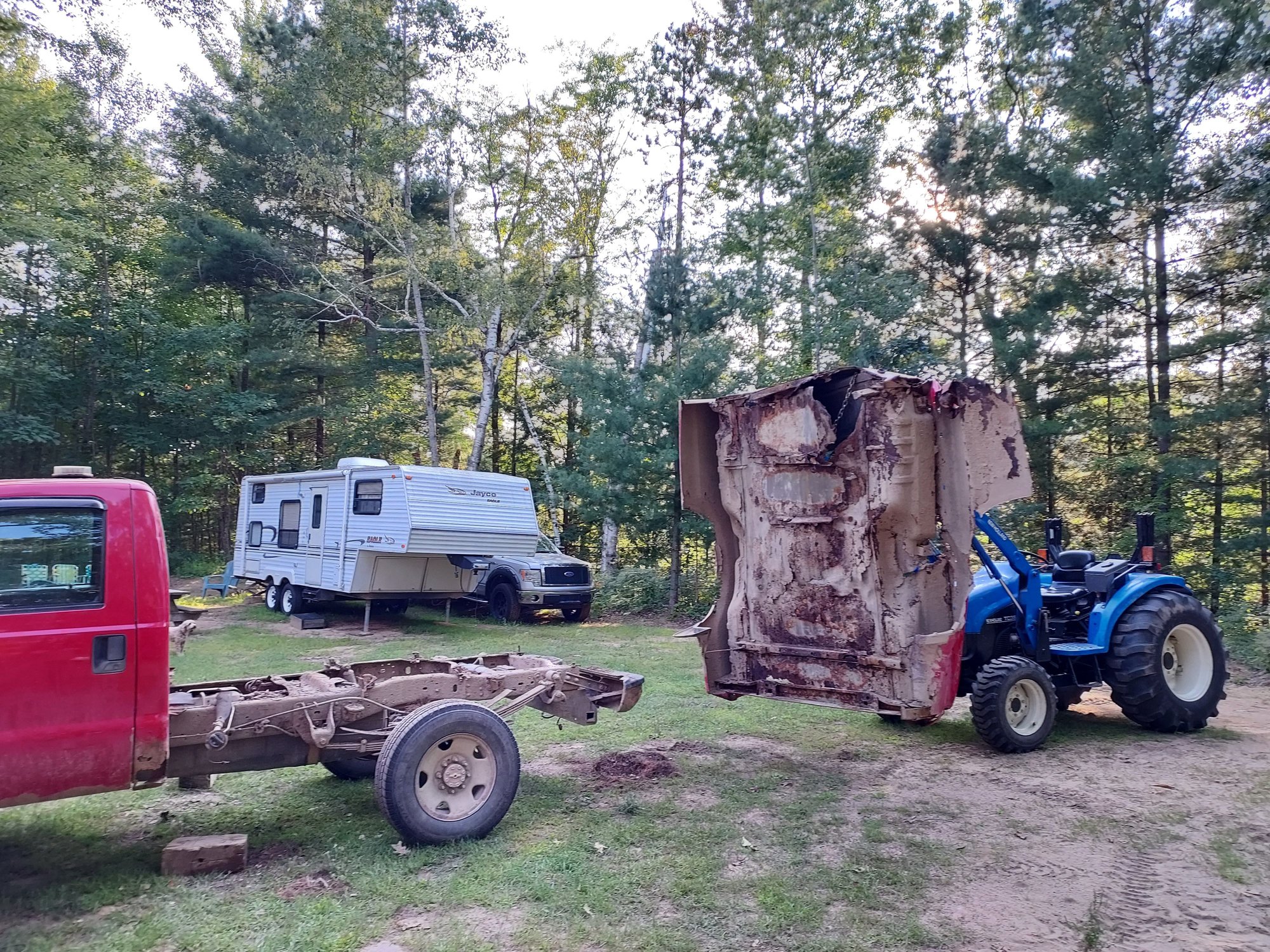

Rusty? I took my box off the easy way!!

Looks like Greg might have worked flat rate in a dealership!

One of the first things I did when I bought my truck was spray a bunch of 3M internal panel treatment. I took a few of the screws out that held the sill plates in place. Same thing with any open access holes in floor braces or body mounts.
Cheap insurance!!
