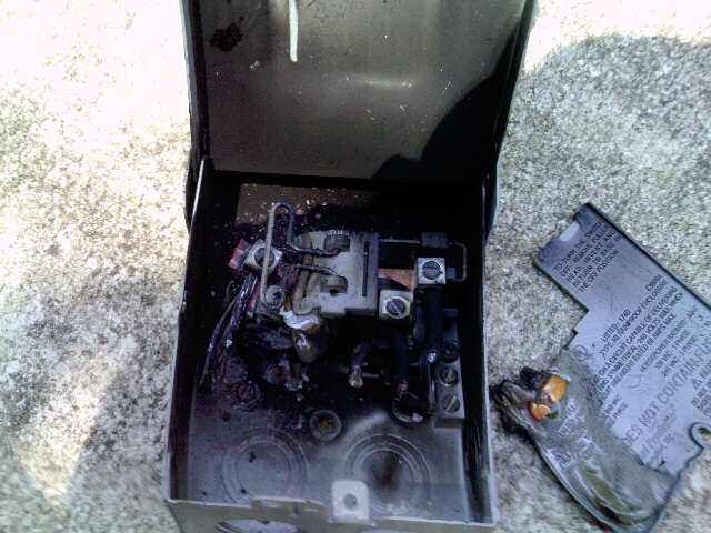

I would make sure to change any aluminum wiring you find with copper. Reason being aluminum contracts and expands with heat way more than copper does and over time leaving the aluminum connection loose and possibly arcing and creating yet more heat and possibly start a fire.
Minimum make a habit of tightening any aluminum connections you may have at least once every few years.
This happened at my rental house just last summer. Luckily my breaker tripped before it started a fire but it was smoking bad. If it had been any higher amperage, it would've sat there and just welded until it caused a full blown fire.
If you plan to live or have to change it anyways then go with the 200 amp, if you plan to flip it or rent it out then stick with a 150 amp. I wouldn't consider a 100 amp panel on a decent sized house especially if you plan on running shop tools, air compressors and saws. Just my .02c
