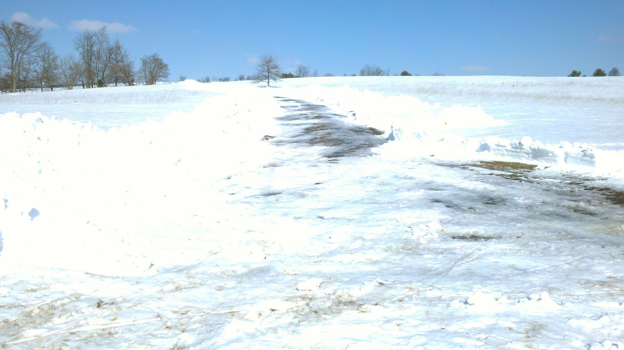

Finally got dug out with a backhoe 6:00 Tues evening. Farm road is barely passable with my crewcab dually 6x6, but at least it's icy.
View from the top of the hill looking south:
From the bottom of the hill in front of the house looking north:
And this is the public road, plowed by VDOT:
