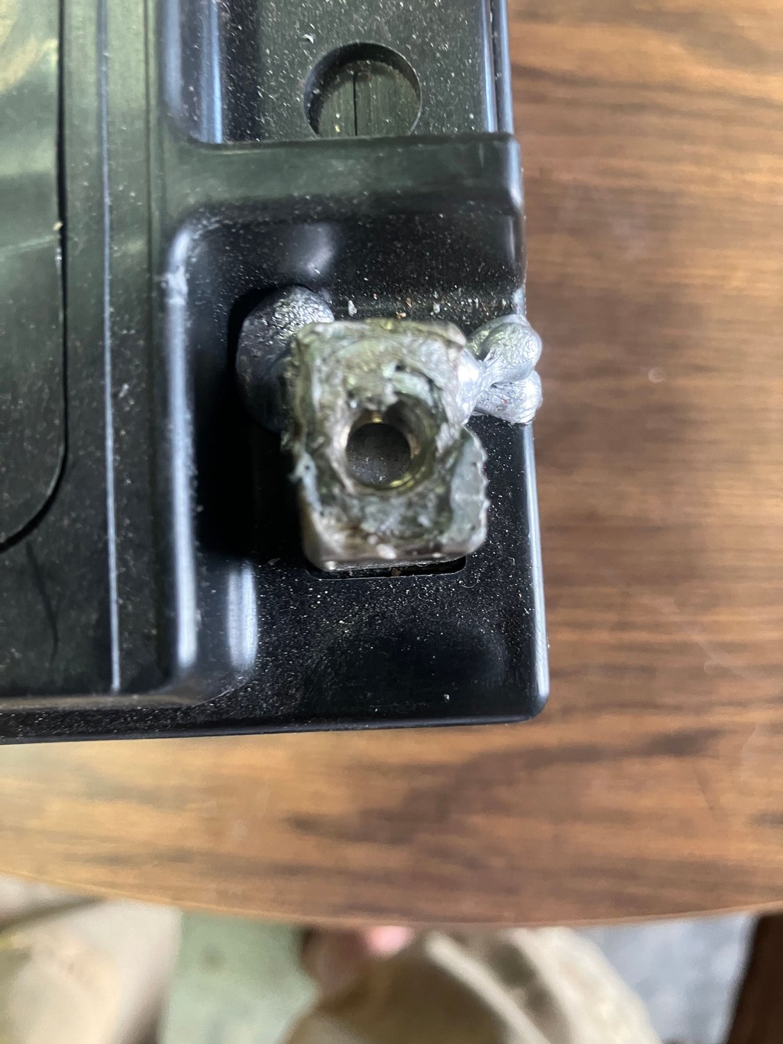

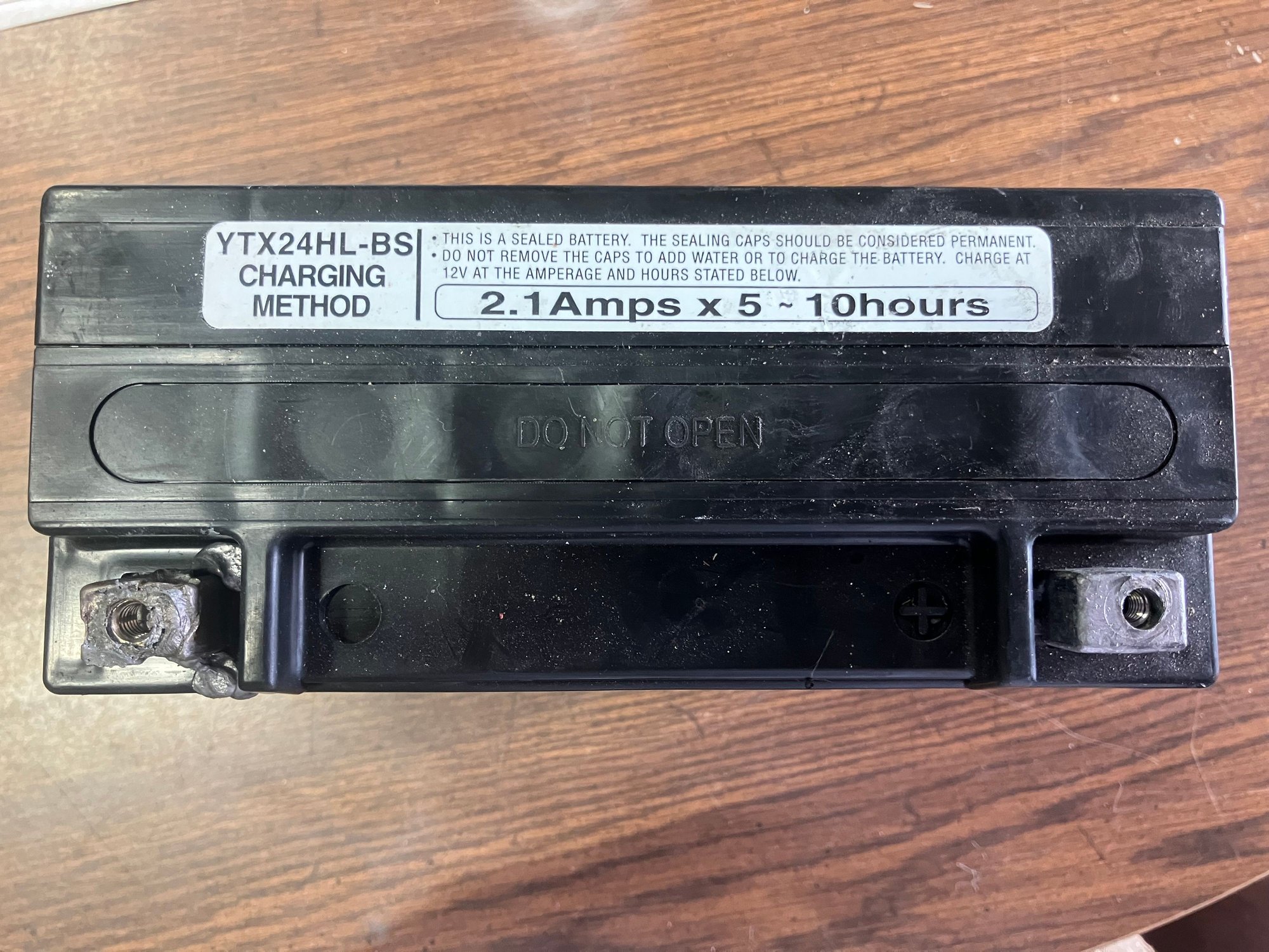

Does this look right to you?
Didn't take long finding the lumpy biscuit on the Indian Motorcycle hard start issue. Check this $hit out. I've never experienced anything like this on a car, truck or motorcycle I can recall - "maybe" some other piece of machinery over the past 55 yrs - "maybe". At any rate, negative battery cable was loose as were the several other ground cables attached to the battery. Of course the 1/0 largest cable ([-] ground battery-to-starter) was loose, as well. Not sure if it was initially faulty battery or cables came loose resulting in a faulting battery or what? Going to remove the several of the ground cables, clean them up &/or replace them. Battery is not that old but $hit happens & I don't have the patience or time to deal w/ the manufacturer, battery age, faulty, warranty, etc. I did some research on this battery before purchasing it. I doubt it's the starter itself. I put on a HD starter ~6 yrs after I purchased the motorcycle because these beasts require significant current flow & the OEM starters were a known issue. Oh well....proceeds from the mystery buyer will buy me a new battery.

Posts: 15,445
Norm, that's even worse than letting the smoke out of an electrical device.
If that block is lead, its melting point is around 620ºF.

Norm that is crazy, all melted like that. Never seen that myself. But if all that mess was loose then there was copious amounts of arcing going on.
Kenneth - You bring up a great point I hadn't considered w/ much attention. Good point. I'm curious if this resulted during riding (starter not engaged but loose wiring) or possible the loose wiring as part &/or parcel to the trickle charger attached to the battery? Maybe a spike through the man-cave electrical system of some type, perhaps? You know, on several occasions during any given year a house might get several really, really, really fast & rapid ON/OFF cycles (milliseconds) as a power/utility company resets a breaker bar, etc. Hell, I'm guessing at this point and you know it. Yes, pretty sure that's a lead block. It's like a battery thermal runaway, eh?
Old Oct 4, 2024 | 03:34 PM
  #56829
Posts: 26,299
Mike - I thought same - significant arcing between battery anode post and the several ground cables. Firecracker hot is what I thought. Like significant firecracker hot as Kenneth pointed out.

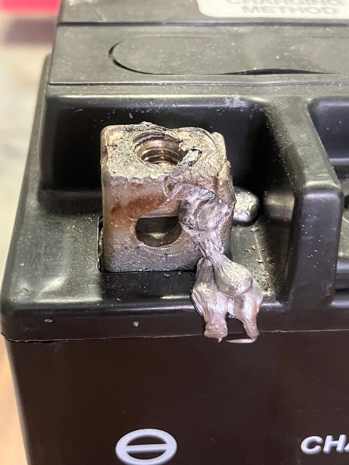

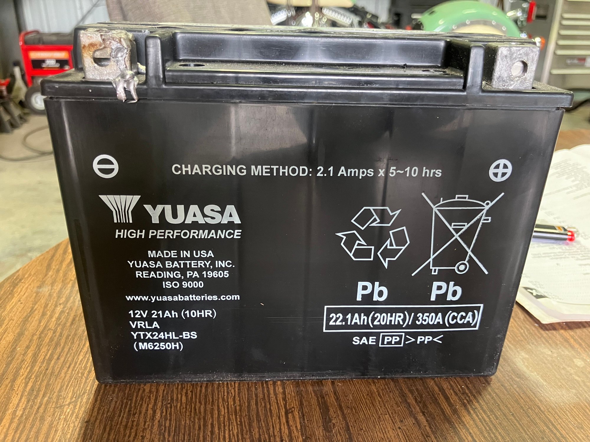

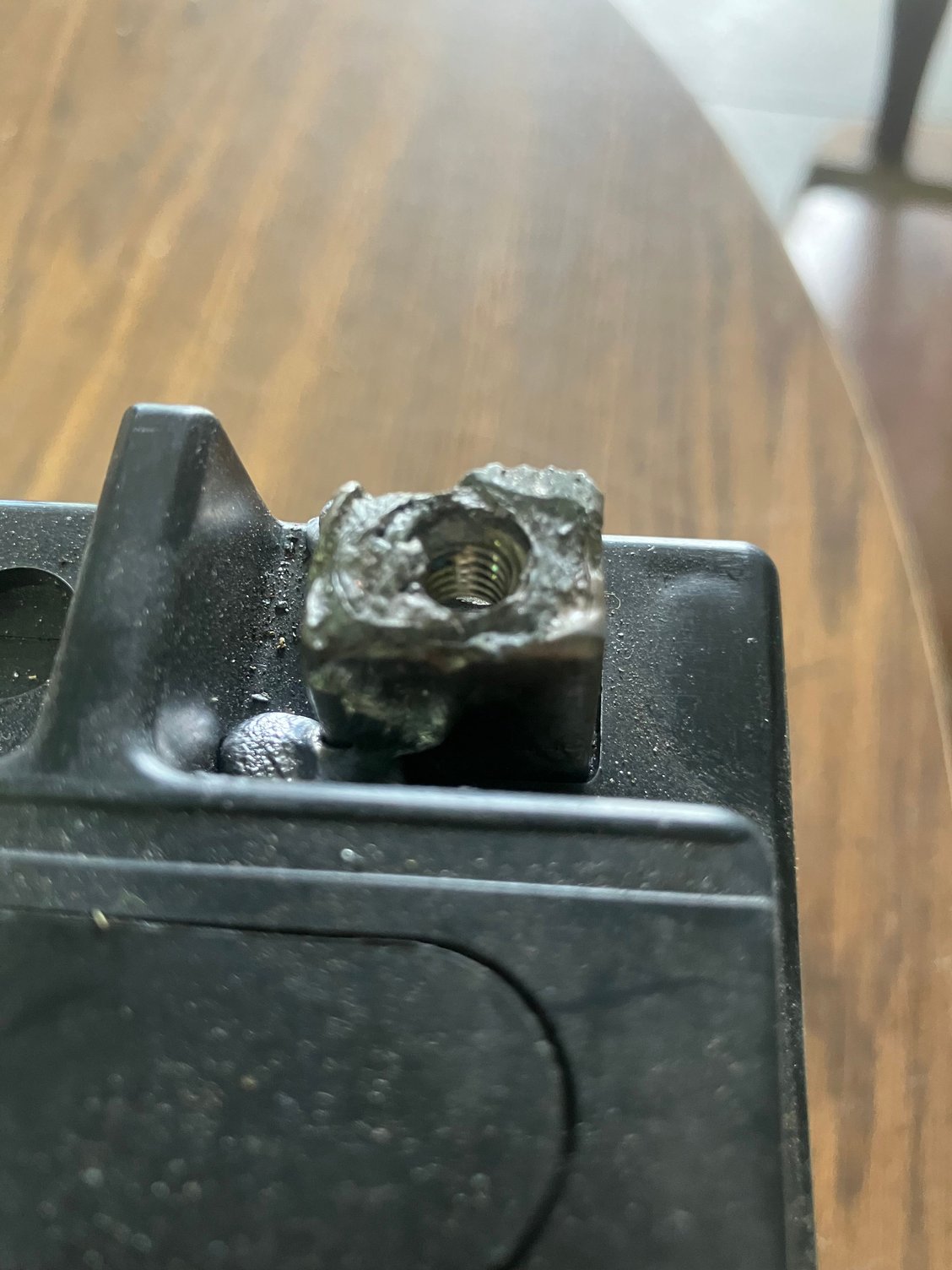

I think Mike's correct - the Pb battery anode meltdown resulted from arcing & produced this significant amount of heat.
The anode battery post hold down bolt became loose most likely from riding yet possible the bolt &/or embedded nut in the anode post are faulty. Additionally, this may have resulted from my failure to double-check bolt tightness at some point.
During periods of riding the battery is continually being charged & the trickle charger is always on when not riding. Both the loose bolt and wires were arcing while riding & while on trickle (finishing) charger.
I'm going to experiment & test this battery - the melted Pb is on the surface - the Pb anode melted. I think I can remove that melted Pb w/o any ill effects. Insert the bolt, fully charge the battery via my 2A - 6A battery charger overnight & see if I can get >13V. Disconnect the charger & monitor free-standing battery voltage over several days. If no loss of voltage I'll call the battery good. Check continuity of my ground cables R&R any which are bad, reinstall same battery, attach wire cables & monitor stand-alone voltage on the motorcycle over several days.
I could have avoided this issue most likely had I safety wired that ground anode bolt. It doesn't have a through-hole in the bolt head for safety wire but I can drill a through hole. I'll find an attachment point where I can safety wire from the bolt to an attachment point.
