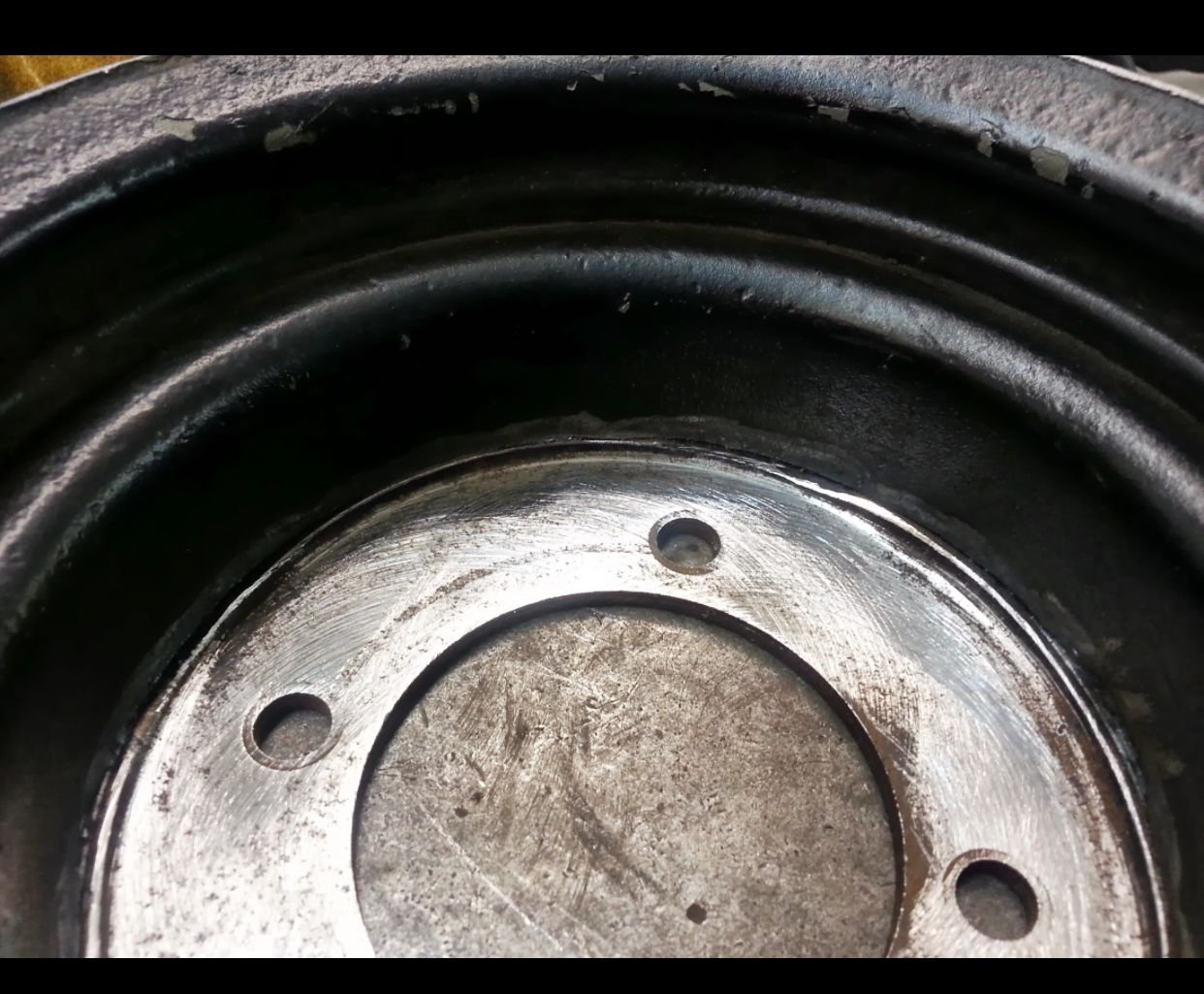

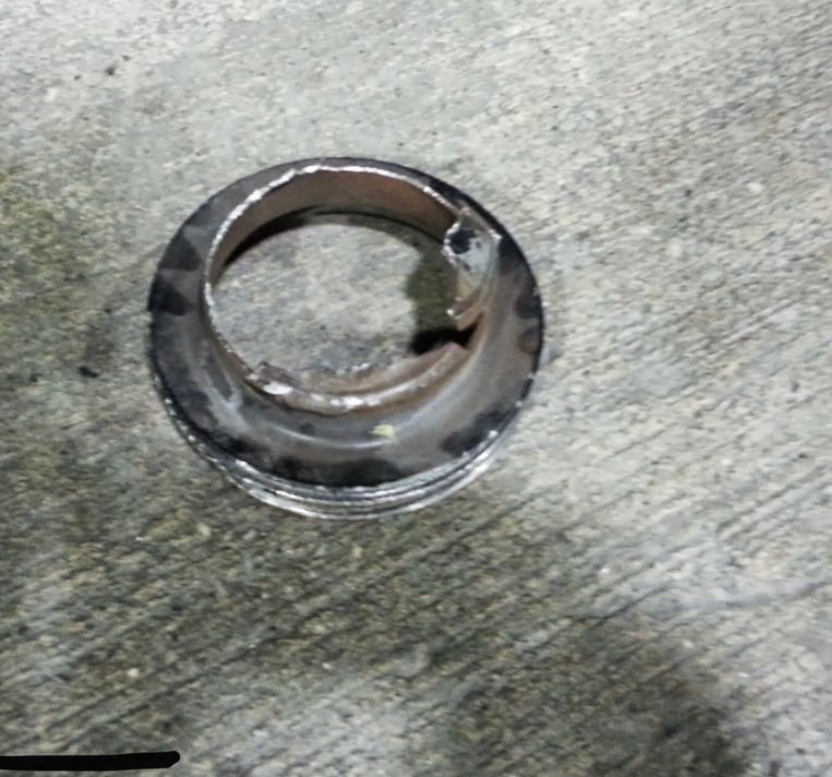

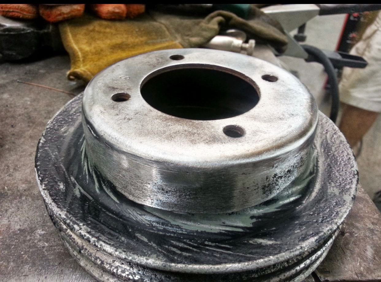

I had been hearing a faint ticking noise in my car that I assumed was just a minor header leak. I didn’t pay too much attention to it, it was very mild. We were cruising thru Red Bud Illinois when the faint ticking suddenly became a loud banging noise. Before I could pull over, I felt a big bank, the noise stopped, the charging light came, then the entire car/trailer felt like I ran over something in the road.
Turns out the center of the crank pulley cracked, abd came off the engine!! The pulley flange was still bolted to the balancer, the jolt from the car/trailer was me running over the pulley.
Once again, how/why in hell does something like this happen?! I did have the stiffening plate inside the pulley flange. My next thought: how am I going to get this back together?! Where am I going to find a NON A/C crank pulley for a Olds?
Lucky for me, the automotive gods were smiling on me. As I mentioned earlier, this happened in Red Bud Illinois, about 3 blocks from the V8Tv restoration shop.
https://youtu.be/y2UiSXxd0YM
Someone called the shops owner (Kevin) and told him someone needed some help. He just happens to have a Olds crank pulley, except it was off a engine with A/C. He chucked the A/C pulley in a lathe, and cut away the pulley part leaving the flange. He then cut the broken flange of of my pulley, and then welded them together.
bingo!!! Back on the road!!

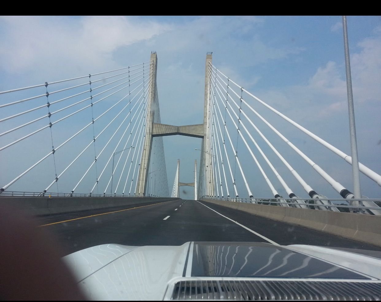

I decided to sleep a few hours and then head out early the next morning. I drive along the route, taking the required pictures to verify I actually drove the route, all I’d going well, until I get to the bridge separating Illinois from Tennessee. The checkpoint/photo I need is at a strip club, unfortunately I can’t get near the club because the are filming a scene for the movie Gone Girl!! They had all the equipment trailers and other crap blocking the way. Worst of all, they open the bridge for just a few cars to cross, then close it again to film, then open it up, let a few cars cross, etc. I wait 3 hours to get across the bridge.
Ben affleck and I think Rosemond Pike are in this car filming for the movie
Maybe someone in readerland is familiar with this bridge?
Once again, Ben Affleck and Rosemond Pike, the hood of my car on view, waiting patiently for my turn to cross the bridge.

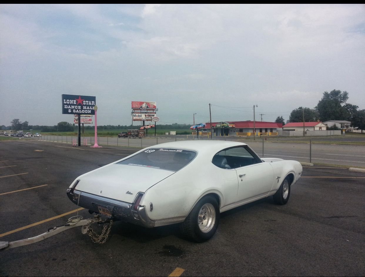

The strip club is in the background
Another pic of the strip club. The lighted sign is what I’m suppose to take a pic of, with the car and registration number in plain view.
By the time I finally made it to the next track, I missed the cutoff by 15 minutes. I called my buddies ahead of time, told them to meet me in the staging lanes. My plan was to unhook the trailer and at least make one pass to collect a timeslip. No luck. The crank pulley cost me Quickest Olds that year. 😡
