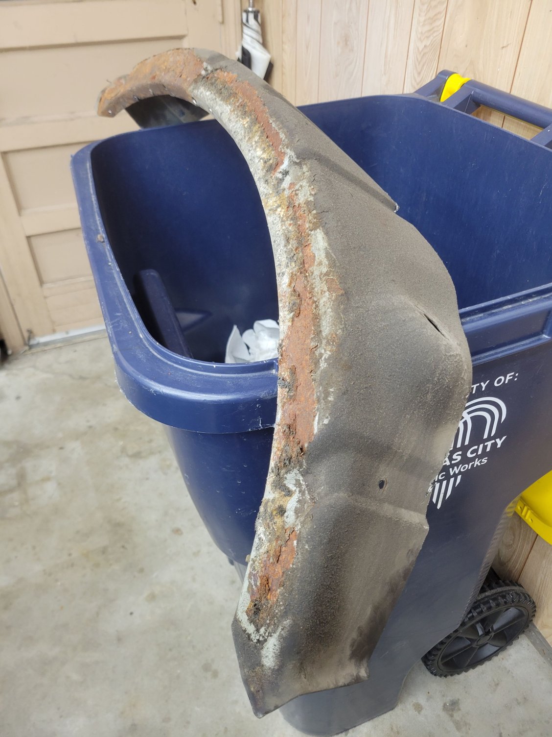

Looking for something to dissolve foam.

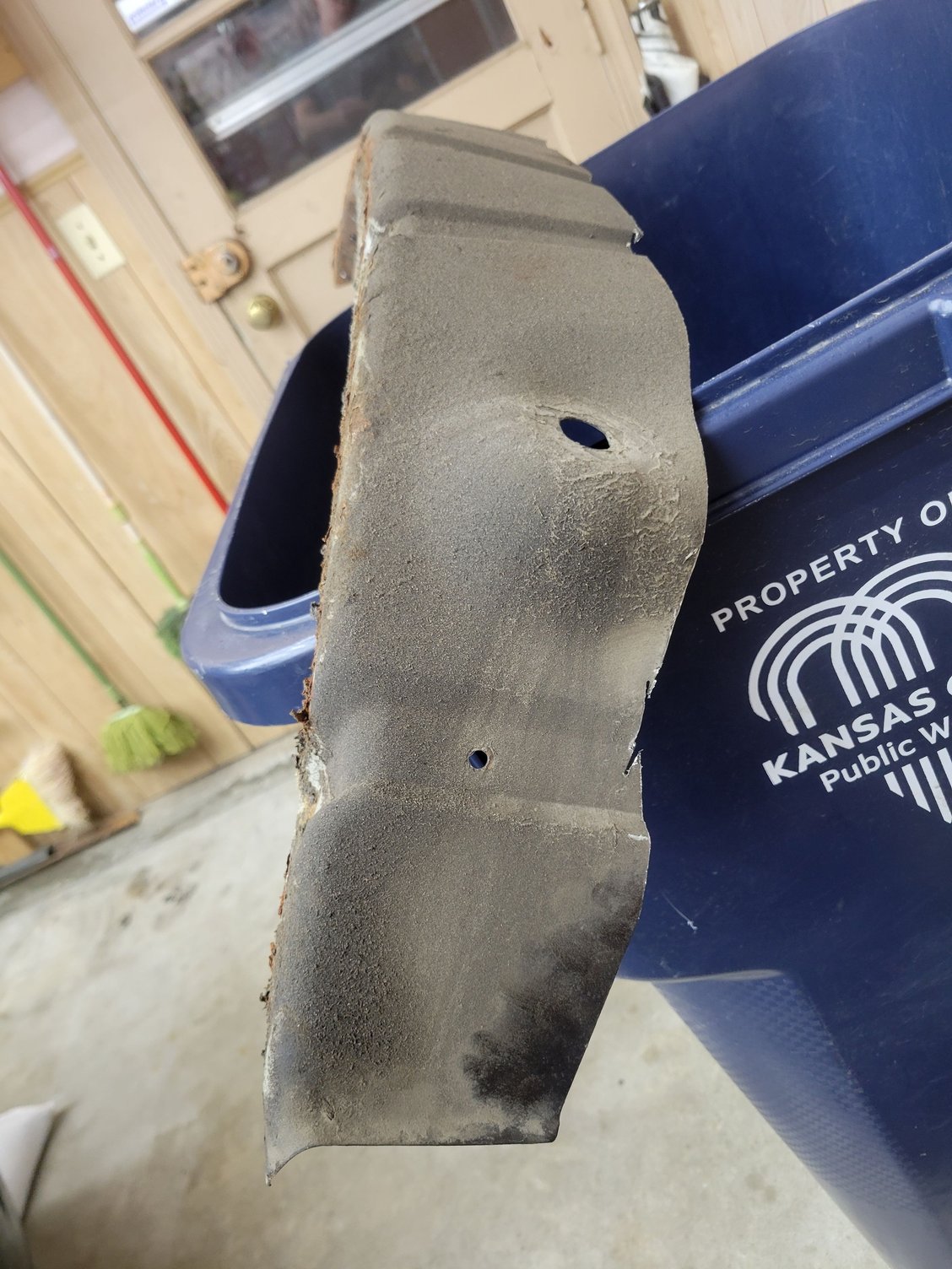

So my 2001 F250 just started to show signs of the infamous wheel well cancer. In an effort to stop it, I removed the inner wheel well and discovered some type of factory applied foam in-between the two panels. I'm going to treat the metal and try to reverse/seal/stop the rust and hopefully save the bed. But, the foam is still on the other side. My thought was, find something that will dissolve the foam, allowing me to clean and treat the area before the rust has a chance to start without cutting the panel out, as I had to do on the other side. I've tried Brake Cleaner and Acetone to no avail. Do any of you guys have any suggestions what might actually work? Last pic is the stupid foam. Help me save my truck.

The problem with heat is I don't want to damage the paint. I'm afraid to get it hot enough to melt, it would burn the paint. And I can't get to the foam without cutting it apart like in the pic, which I'm trying to avoid on the other side.

I guess I should clarify. I want something to pour between the two surfaces to dissolve the foam so I don't have to cut it apart. I have no access to the area unless I cut it apart.

That is a possibility. Tonight I soaked my test piece in paint thinner. While it didn't dissolve it, it did seem to break it down to where high pressure water or air might blast it out. This weekend I will try to soak with thinner, dig out what I can and wash or blow out the rest. Fingers crossed!

Paint thinner for the win. Soaked yesterday with paint thinner in a squirt bottle. Today I came back and started digging with a long wire with a hook on the end. The stuff just crumbled apart! I was even able to blow chunks of it out with the air hose. Granted, I didn't get it all, but tomorrow plan to get more thinner ( I used all I had) and soak with more applications then continue to dig and blow it all out. I even thought of getting fishing line, spanning the entire top, and having someone on both sides to "saw" the rest of the foam out. Not complete but major progress in an effort to save my bed. Btw, the stuff on the ground is the foam, not dirt.
