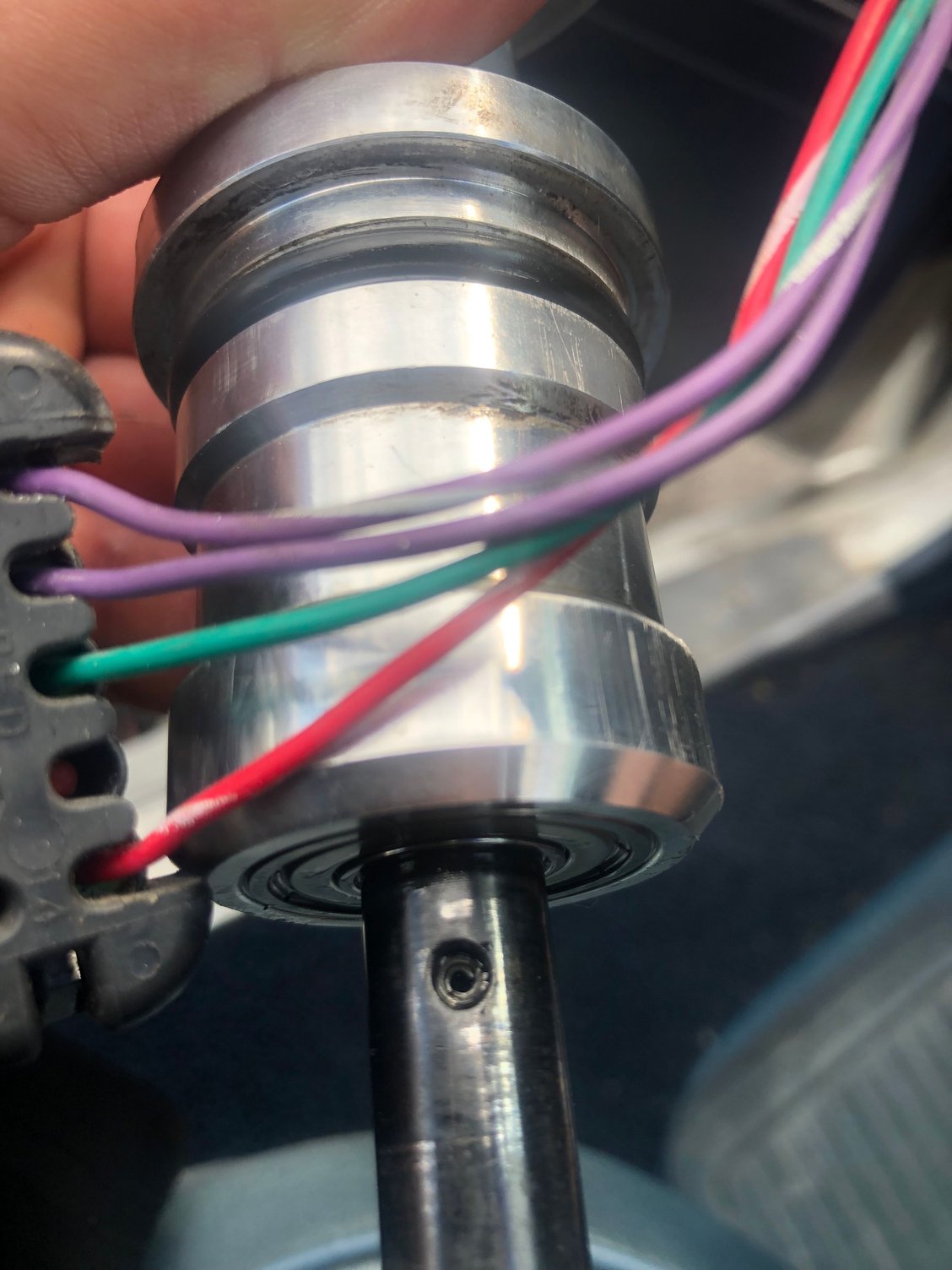

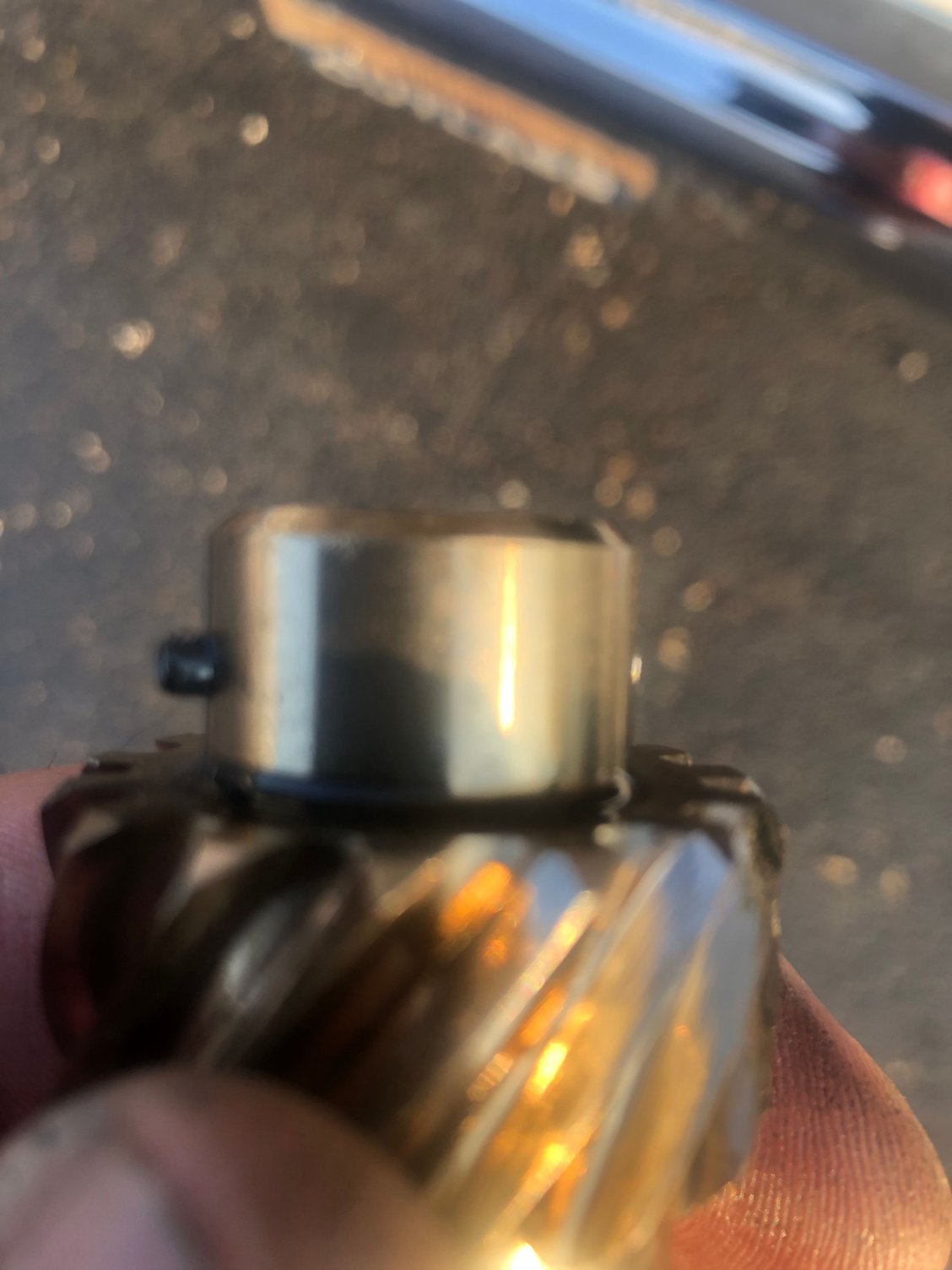

Old Aug 4, 2021 | 05:10 AM
Posts: 6,105
I was sweating bullets worried about the other pieces of the roll pin getting caught in places that could do some serious damage. Turns out my concerns are unwarranted, the rest of the roll pin is still in the gear!!!!
Pin in the distributor shaft. How in hell does something like this happen?! The oil pump driveshaft is keyed to the gear, the gear is driven by the camshaft. The distributor shaft isn’t under a load, the shaft spins freely in the distributor housing, so why did the pin break?!
Old Aug 4, 2021 | 06:09 AM
rocketraider's Avatar
Oldsdruid
Joined: Dec 2007
Posts: 10,629
From: Southside Vajenya
If this is a coiled spring type pin, those things are near impossible to break or even cut with a saw. Good ones, anyway.
Guess you just got a bad one.
Glad you were able to get the gear and pin out intact. No sign of damage on the gear?

Old Aug 4, 2021 | 06:24 AM
Posts: 6,105
The engine has plenty of oil pressure. Even if the oil pump was seizing, the gear would strip or the shaft would twist. The only thing the roll pin does is line up the distributor shaft with the gear.
