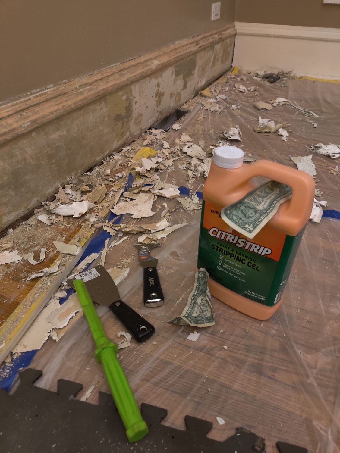

The citrus stripper I tried just now seems to be working good. But will take a few rounds. I'm ok with that . I don't want to remove the trim because again it's really brittle and I'm not the most experienced at this. I enjoy the work but it's also a learning process for me. I don't know what kind of wood they are but I know most of the wood from siding to floor joist are cedar I believe.

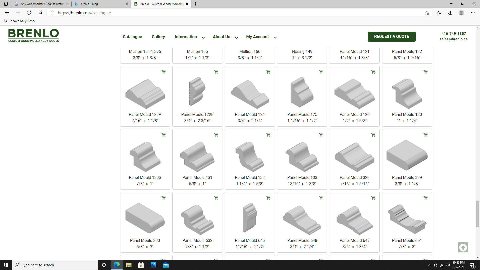

I've worked on a lot of heritage houses with that style of trim.
Whats your end goal with it? Repaint? if so, why strip all the paint off only to put it back on?
There is no easy way to go short of replacing it as close as you can. Looks like a flat wood board with a panel molding wrapped over the top. "Bolection Molding"
If you do decide to take it off it will break apart. You will find all sorts of great big nails holding it in place. Nothing like what is used today.
Strippers are messy and will take multiple coats. Heat guns work but the work wreaks of burnt paint so much that the house will hold the odor. Do it outside if you can.
I think you would need something like panel moulding 132

I did 2 rooms already.in the past 9 years but this one is the biggest and so far hardest. I mainly want to strip it to bring the sharp details back to the trim. It seems the citrus stripper is working pretty good so far. It will need coats but honestly I only get a few hours here and there to work on the room so it works out good to let time work for me . Everything is in pretty good shape. Not doing a full demo or restore job just trying to rejuvenate what's there the best as possible least evasively as possible. As far as finishing the plaster walls I'm a body man so I'm actually pretty good as sanding mud and flowing the patches out pretty good. I'm sure I got alot to learn but my approach as mentioned is to be as least evasive as possible while bringing life back to things. When they updated the electrical they patched in the sections they used 5/8 drywall and all the outlets look 3d lol. In the other rooms I went to much thinner dry wall shimmed out from the lats and smoothed it all out.

What I learned. I really like the citrus strip. It's not the fastest and I was not keen on using it but it was the cheapest . For me this is a pick at it little by little project. I did one section it the opening let it sit with no plastic and 24 + hours later it was still soft but not super gummy so the mess was really minimal. I just needed to scrape and catch it and into the garbage can. I been plugging away at this project since January and the goal is to have it done ready to furnish by October. I think I got enough time. Anyway I appreciate the suggestions and they really helped me be more careful actually hearing the experiences. Disregard that big section of previous repair that looks half scraped. It seems someone blocked off the once used fire place and it was actually done decently so I have to blend the corners into that wall and repair what I messed up. Live and learn.

I haven't been covering because it seems to dry really slow. I'm trying to get it when it's still somewhat soft soni can scrape it and make less of a gooey mess. So far it's worked. The one section I been working in took 3 hours so far like an hr an evening . I can live with that. I just gotta get on a regiment.
