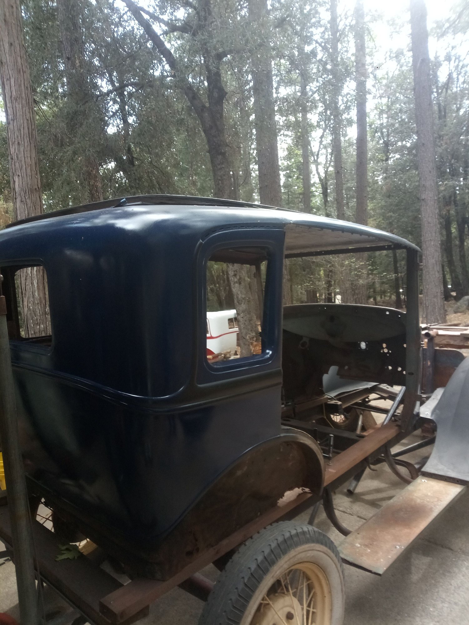

Frank has some interesting projects he is working on and that is not all of them and I enjoy going over there (next door neighbor) and playing cars with him. Sometimes I'll get a call" can Tedd come out and play" I know he needs a tool or advice, or coffee. Just like a couple teenagers and his adult kids think we are nuts..... Doubtful he will come over to the Olds side but then again I would slip over to the Studebaker side should I somehow end up with that 33....
33 Studebaker, about 80 % there
57 210 Chevy, trunk full of trim and other stuff, it's a runner
Love those headlights
Yard art, for the life of me I can't think of anything I would do with it but it is fun to speculate.
More stuff
Can't find the 23 roaster T body and fire wall there is other stuff but I can't find the pictures.
