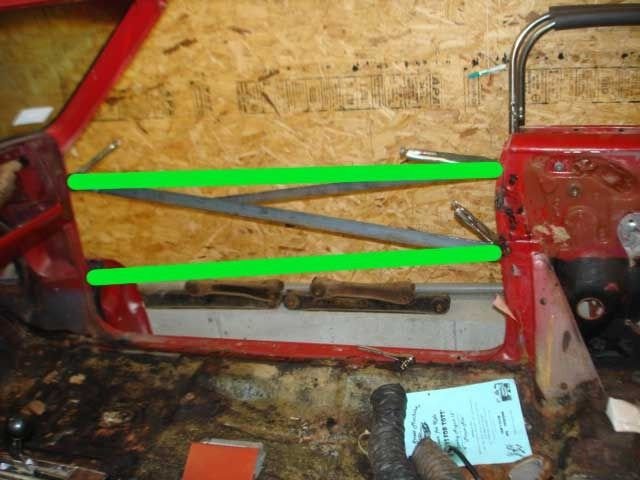

I used roughly 3/16 inch plate and angle iron. For the striker part I took a piece of flat stock and bent it into a 90* angle. The I drilled a hole in it, removed the striker bolt and bolted the plate behind the striker bolt. I also made another plate that bolts to the hinge holes using the original bolts. I welded a piece of angle iron between the plates. The upper brace is just welded to the angle iron and tacked to the door edge. I did not brace it across the body although that's an option.

Thanks for sharing. I was thinking about doing this (green), but your option looks good. I just want to make sure there are no bad surprises. My striker bolts do NOT want to come out, nor the door latches. Hopefully by the time I get to it the Kroil will let me get the body bolts loose.
Maybe this would be better?
