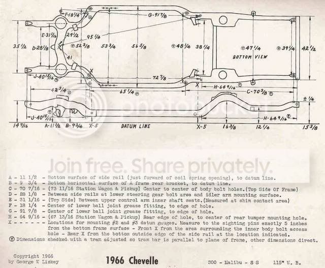

This ought to be very close to what you are looking for.

Thank you for the reply 'oldcutlass' but I don't see anything in your post ie. pics or links, just the text of your post... ?

I can see the pic.
From that it looks like there’s a measurement of 65.25” between the frame mount on the front of the side beam and the frame mount at the rear of the side beam. I believe both areas are full boxed fore and aft of that mount so I bet 60” would be on the verge of fine.

Ok 'oldcutlass' I refreshed the page several times over a few minutes and now I can view an image of frame and dimensions for a '66 Chevelle - yes that is VERY helpful. Thank you!
At a glance I'd guess using the QuickJack 5000TL would be b a r e l y able to lift the car (as designed to be used) having the rubber blocks at their maximum distance of 60 inches. I say ' b a r e l y ' only as it relates to distance and not as it relates to weight, this car is well below the maximum capabilities of the QuickJack 5000TL. Seeing the area on that image where it shows 65 1/4 inches is where I used to (iirc) deploy jack stands, ie. just between the 'circular holes' in horizontal plane... *if* I could be certain the rubber stacking lift blocks would have enough material engaged in those 'boxes' I'd be okay to lift, then lock, the QuickJacks, I would go ahead and buy one. Problem solved if I go to the next size up but that could mean I wouldn't be able to use it on the other four cars here.
That diagram is very helpful. I am hopeful that someone on the forum can definitively say that they are safely using the 5000TL on a '64-'67 A-body or do some explicit measurements explaining exactly where they measured from and to. Is there enough of the 'boxes' within a 60 inch distance (I think the rubber blocks are each 4 inches long)?? I hate to trouble anyone, it's only because the car is inacccessable to me. I dislike the idea of having to spend another $540+taxes to get a measely extra 3 inches at each end by buying the 'frame extension kit' - I have a very, very limited budget.

Thanks 'Rallye469' I agree on "so I bet 60” would be on the verge of fine." The car doesn't have many miles but it is old, and Canadian, and someone has driven it like it somehow deserved to be punished, a lot, so the more support surface area the better. But I am getting the feeling so far that it just, might, maybe, be doable - any 'bet' that didn't work out would be more expensive than useful though lol.

Thus far oldcutlass has provided a very helpful diagram of a '66 frame (same as mine afaik) that gives nominal dimensions. The only thing I could do with that now is measure, on my screen, and then 'scale' another measurement and overlay that onto the diagram - matching reality depends on the accuracy provided in the diagram and in the scaling process. I've done exactly that and my determination is... if I'm accurate... that the full 60 inch reach of the QJ frames 'appears' to land on the innermost areas of the 'boxes' at either end of the side portion of the frame, just barely. Probably okay for a '68-'72 A-body that I think is 3 inches shorter in that area than mine. It's just too close for me to drop that amount of money, then possibly faced with faced another expense to follow. Like I said above I am hopeful someone who owns a '64-'67 can provide a 'real' measurement or 'testimonial' about the QJ 5000TL and their car. For context I have a 'long reach, low lift' trolley jack (107 lbs) that lifts from 3 1/4 to 24 inches and plenty of stands and steel ramps, the jack handle is long for inside my cramped space and the incremental jacking and placing of stands takes time and energy I'd rather spend on the car.

Maybe you have done all of this math already, but here’s what I came up with.
The diagram below is from the 1967 Olds Chassis Service manual showing the lift points for all 1967 models, whether it’s A-body, B-body, or C-body.
The wheelbase for all 1967 (and ‘64, ‘65, and ‘66) A-bodies is 115 inches, so that’s the distance between the front and rear axles in the diagram above. If we can assume that the diagram is to scale, we can print out the diagram (I didn't try to do this on my computer screen), measure the wheelbase in the picture with a ruler, and then set up a proportionality.
Starting at the zero end (top/front axle) in the diagram, the front lift point is at 1.875 inches on my piece of paper. Setting up a proportionality, 1.875/6.125 = x/115. For this, x = 22.3 inches. So the front lift point is 22.3 inches behind the front axle.
For the rear lift point, which is at a point 4.625 inches from the front axle on my piece of paper, 4.625/6.125 = x/115, and x =86.8. So the rear lift point is 86.8 inches behind the front axle, or 28.2 (115 - 86.8) inches in front of the rear axle.
The all-important spacing between the lift points is 86.8 – 22.3 = 64.5 inches.
So now you go to the Quickjack site and look at the various models.
The 5000TL has a maximum lift point spread of 60 inches, so, as you suspected, this will not work.
The 5000TLX has a maximum lift point spread of 66 inches, so this should work for you. The price difference between these at the Quickjack website is only $40. I don't know what it will be in Canada, but I'm guessing that getting the TLX will be cheaper than getting the TL with frame extensions. The 5000TLX has a minimum lift point spread of 43 inches, which may or may not be fine for the other cars you mention you might want to use this with. The 5000TL has a minimum lift point spread of 37 inches. You might want to see what the lift point spead is on the Mazda and Nissan you are talking about. If it is less than 43 inches, then you might be better off with the 5000TL plus the separate frame extension. This will cost more, but it will give you the most versatility. Use the 5000TL with frame extensions when working on your Cutlass and without the extensions when working on the other cars.
The A-bodies of that era all weighed about 3500 lbs, so the 5000 lb lift capacity of these models should be fine for you.
