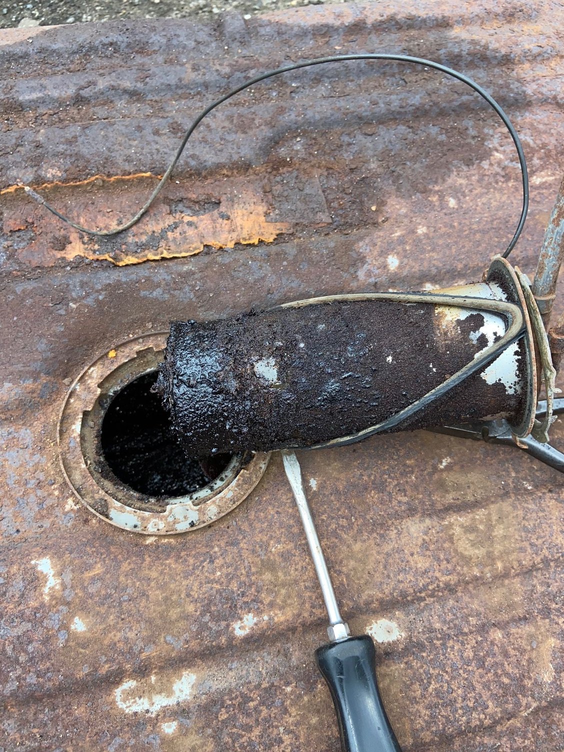

Old Mar 23, 2023 | 01:42 PM
jpilk99's Avatar
Joined: Mar 2023
Posts: 266
From: Bolton, MA
Well, got the old tank home and am back to believing she's served up her last tank of gas. Pretty dang rusty, almost rotted at seams, and taking the sending unit out revealed some pretty ugly shledge etc. See pics. Just can't seem to find one that I can be confident will fit - but maybe I get as close as possible and then make adjustments.
