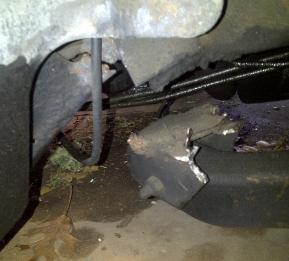

So my car tried to kill me again. The left side front lower control arm broke off of the frame. It looks like it was an old repair that gave way. It's really very jagged and rough. It was the rear bracket that gave way and the front bushing is really torqued over holding it on.
I know that it's possible to fix this, but is it worth it? I'm also worried about getting the alignment straight on this. How hard is it going to be to get this welded back into the exact right spot. It's no show car by a long shot. The interior consists of the rear seat and two worn buckets that aren't original. It's pretty much rust free and solid, but the body is in primer.

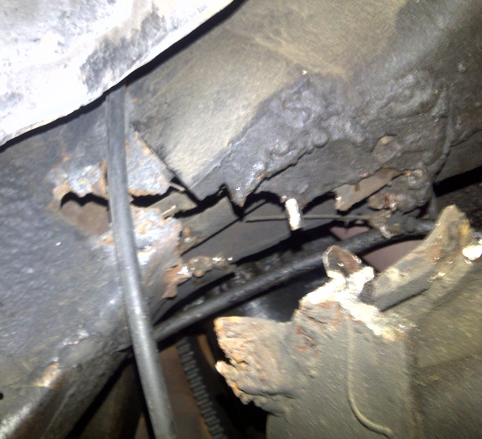

That section of frame looks pretty well-rotted behind the failed area!
If I am seeing that right, then it is time to weld in a new frame section.
Glad you kept it in control without extra drama!

I haven't poked around in there to see how solid things are yet. If that rail has to be cut out close to the firewall to weld on a whole new piece I don't know If I have the room or ambition to do it. Pulling the motor, all of the suspension on that side, fenders, bumper, radiator. Really just gutting the front of the car. If I did decide to do that, then I would be looking at months of down time. I'd also get a real bad case of might=as-wells and re-build the engine from the low comp late 70's model that's in there now to something more fun. I put about 12,000 miles on the car last year so it normally gets driven quite a bit.

I can't comment on how fixable that is without actually seeing it in person, but it looks to me as though it would have to be plated to a decent distance in all directions, and therefore would require some fabrication.
I agree, the hole looks rusty - you need to determine exactly how much rust there is before you contemplate fixing it.

Ouch! that looks pretty bad. Glad your'e ok.
That needs to be looked at by someone with experience very carefully. It might be a canidate for a replacement frame. Theres no telling what other areas of the frame are weak also. I usually see these models rust out bad in the rear frame areas too.

Might be cheaper and quicker to find another frame. If its weak there it might be weak in other spots. Plus a good clean frame is alot safer!!

Looks like somebody applied the "if you can't weld good weld lots" rule. I'd agree with the other posts. You'd have to take a good long look at what is actually rotted/rusted away. I'd also be concerned about how it would've affected the other mountings. Replacement frame is the way to go. Sandblast, fresh paint it'll look factory fresh.
