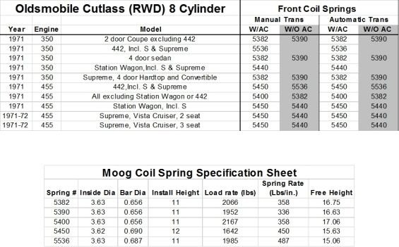

I hear ya, but the MOOG catalog lists 5 different springs for the different variations of the same model vehicle. Not saying that UMI doesn't know what they're doing but I did notice that Norm's car appears to be much higher both front and rear than my car.
Here's a comparison shot of Norm's car with UMI springs from his post referenced above and my car with Moog springs. The rear of mine sits a bit higher than it should but the front is the correct ride height per the CSM.

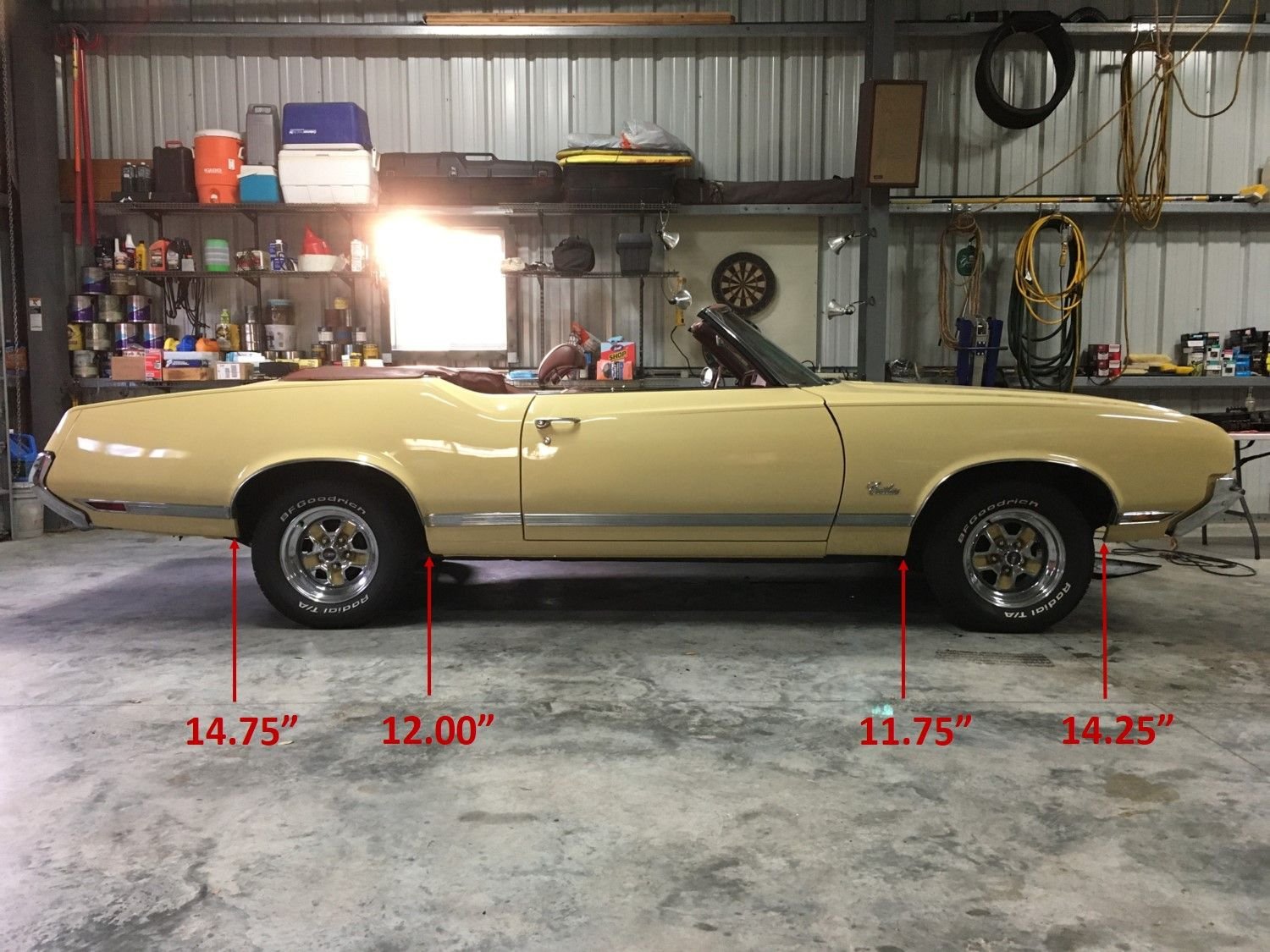

Floor is perfectly level. 15" wheels, 245/45R15 tires. Measurements (below) are exactly as stated +/- 1/16".
EDIT: Corrected tire size. Thanks Kenneth.

The height of my car behind the rear wheel is similar at 14.5" (I know mine is a bit too high), but my front end is 2.5-3" lower. I have 25.5" tall tires (245-60-15).
I thought maybe some of the difference was tire height so I was gonna look up your tire height but something ain't right about what you posted.
15" wheels, 245/45R18 tires.

When you figure it out let me know.
Old Aug 8, 2020 | 10:07 AM
Posts: 26,014
Ah! I fat fingered the tire size. You’re right.
245/45R15
Ooops
245/45R15
Ooops
