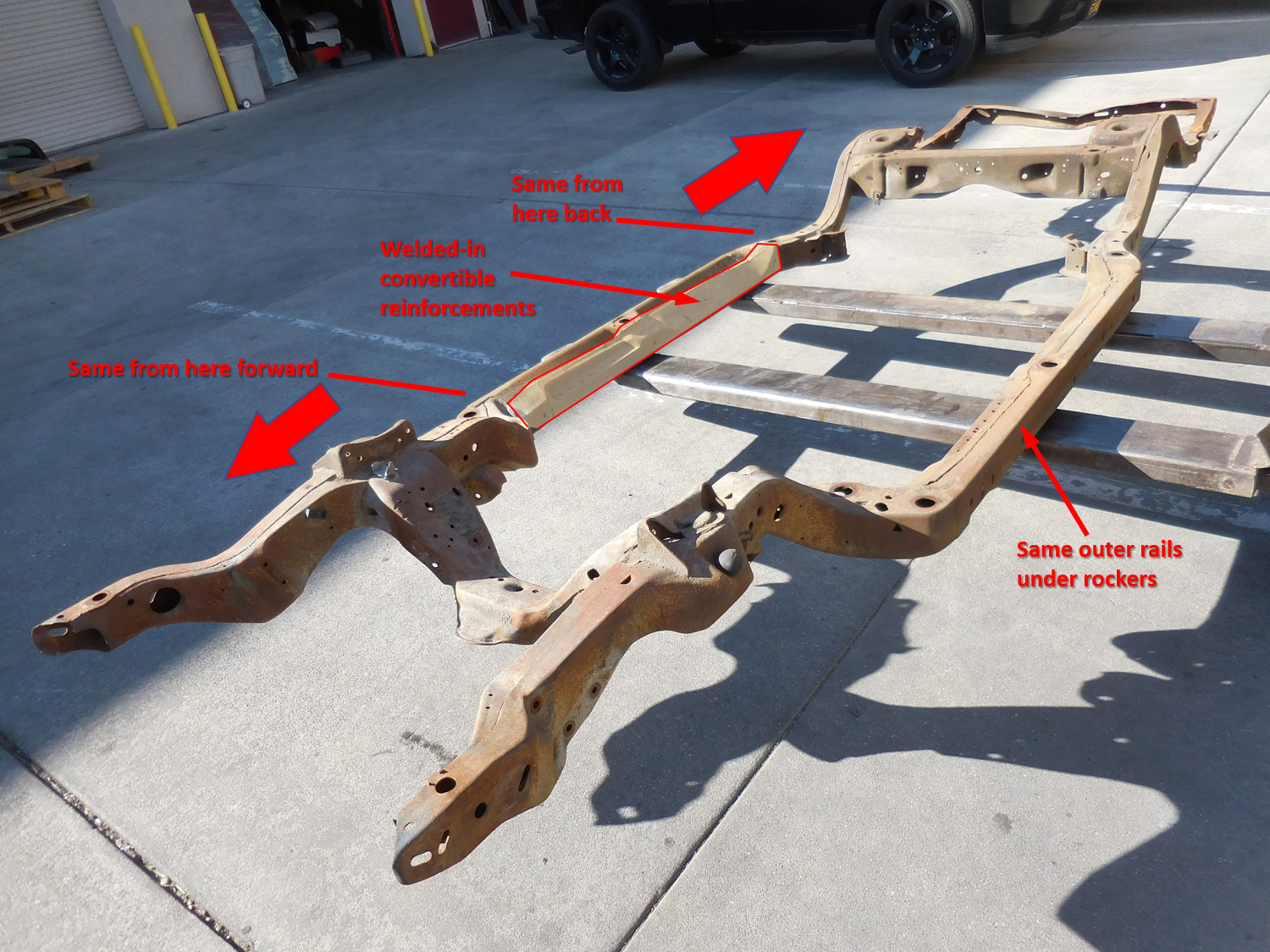

No one reproduces frame rails for A-body cars. Good frames aren't that hard to find. What, exactly, are you calling "rear frame boxed rails"? All A-body frames are boxed over the rear axle, but are open channel from there to the back bumper. The non-convertible frames are the same from the rear suspension attach points back, so any 68-72 non-wagon frame is a potential donor. The only part of the convertible frame that is different is the added reinforcement of the straight rail section under the rockers.

Thank you very both very much for the information and clarification!. The frame rails over the rear wheels seem to be the only part of the chassis that has rust holes and I would like to replace. I may even have a donor car frame now that I know the rear section is the same.
Convertible middle rails and reinforcement boxes look good. Is there any part of the front frame that is rust prone and I should check while I'm at it??
