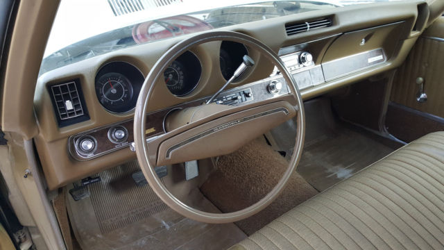

Did the 69 hurst olds come with steering wheel options? I see a different one on this car, also are the H/O emblems on the front fender set too low? I'm not trying to nit pick just curious. I love the car either way.

That is the normal 1969 steering wheel. The three spoke N34 wheel was an option that was not standard on the H/O.

That's a 1970 -71 steering wheel, '69 should look like this:
Old Oct 11, 2020 | 07:30 AM
Posts: 50,730
You're right, thanks. Coffee hasn't kicked in yet.
The N34 was still optional in the H/O, however.

The steering wheel is a 70 as pointed out, someone perhaps swapped it out for the 3 spoke that looked a bit neater, IMO. I like the 70 look better than the 69 one anyway.

Pic of steering column seems odd too but maybe deceived by looking at pic from a phone.
