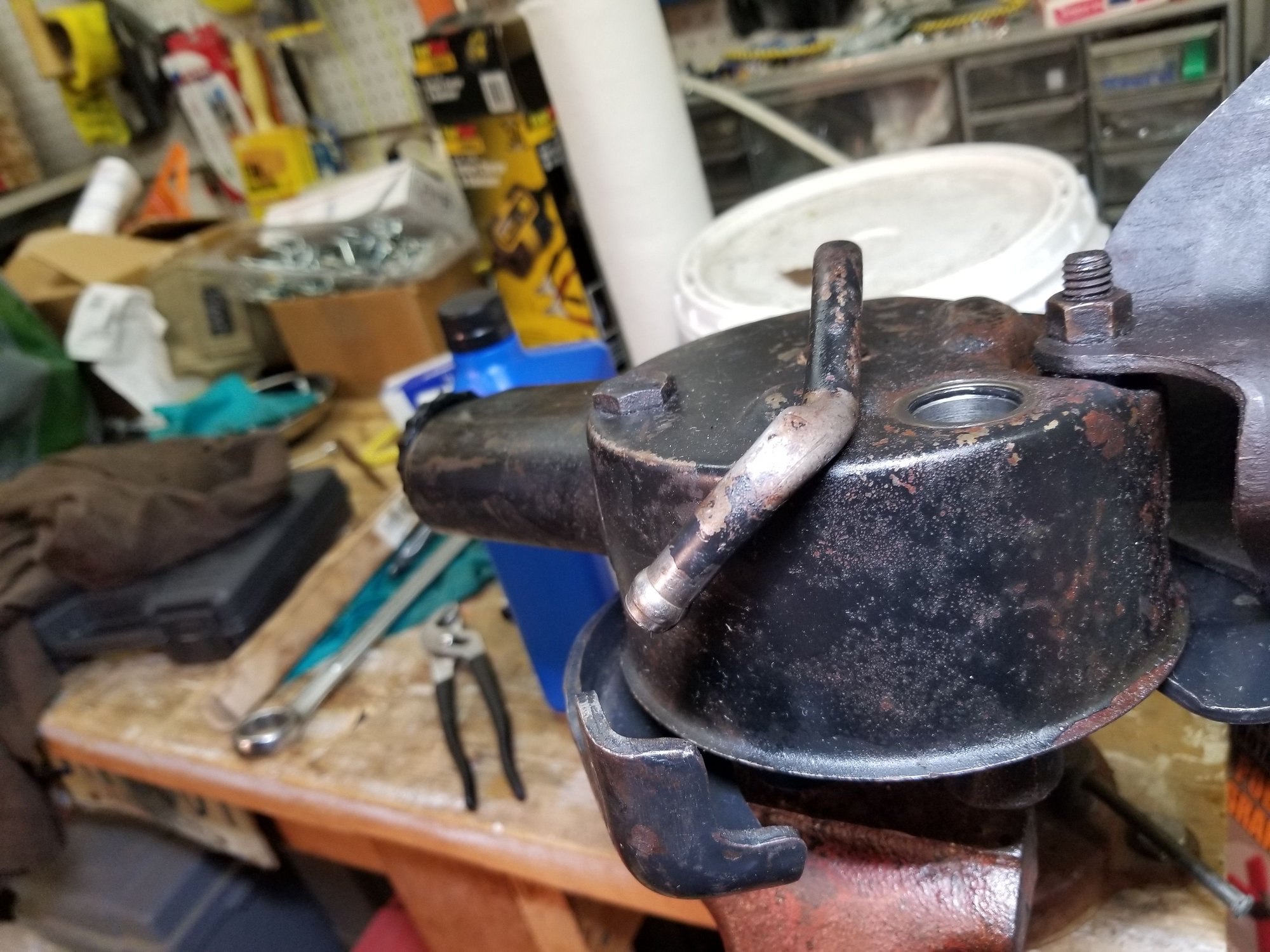

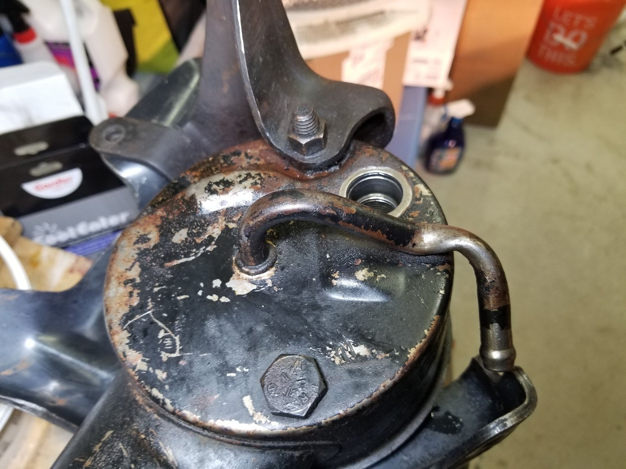

Slightly off topic. Is this low pressure side tube compromised? Crimped? Or were they built like this?

Where do you find one of those contraptions that will wash dishes and bake a cake at the same time? Sounds like a revolutionary idea!
