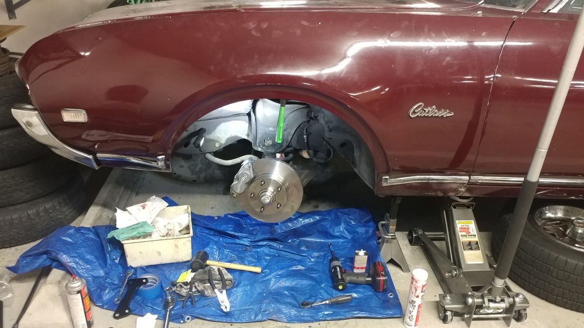

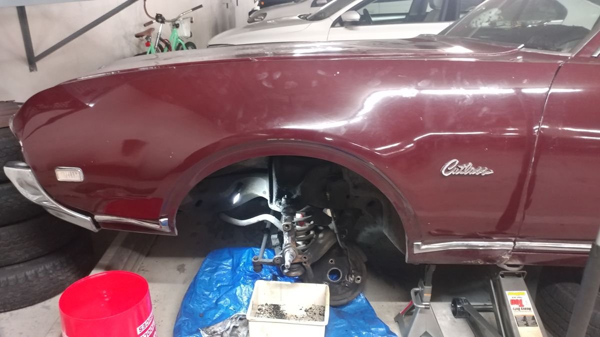

I see a lot of posts asking about a front drum to disc conversion on 68-72 A-Body. I was looking for the easiest solution and honestly, I after how many times and how much money was spent on rebuilding the front drums over the years, I wish I found this kit sooner. Had this kit for a while and was going to pay to have someone install it but lack of funds and the desire to drive my car again got me to just take a stab at it myself and I am glad.

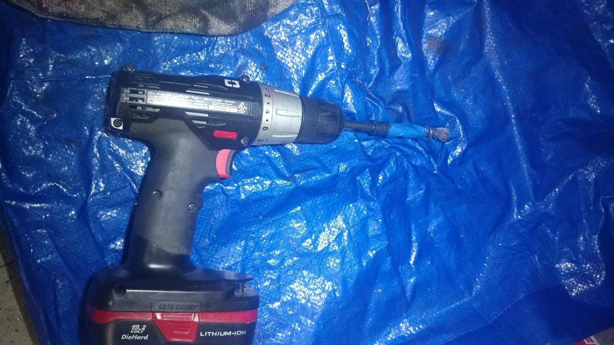

The kit includes everything you need to convert the front drums to discs using the stock drum spindles. It comes with a caliper mounting adapter plate. The only modification that caught me off guard was I needed to drill out the top spindle mounting hole 1.25" deep to 37/64 and tap it to 5/8-18NF. It was pretty easy with cutting oil and cordless drill. Found the bit and tap on Amazon for $17 total. It includes braided steel lines and fittings as well which is not shown in the last picture.
I learn as I go and this was easy enough for me to get done over a couple weekends, watching a couple videos and reading the instructions. Someone with experience can probably get it done in 3 hours.
