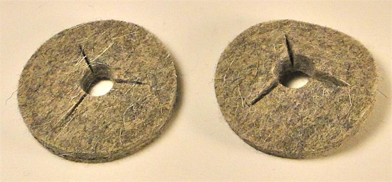

If the brakes are fine otherwise, I vote for a deteriorated silencer. On the back of the booster under the rubber "boot" where the actuating rod goes through, there's a silencer to muffle the "whooshing" sound it makes when the brakes are applied. Usually made of felt or breathable foam.
I did not know that.
My cousin says unless the swooshing sound bugs me i could leave it be. Leaving it alone will not hurt anything or cause damage. What does dirty brake fluid look like ?

Learn something new every day. I always thought they were just there to keep dust and dirrt out.
