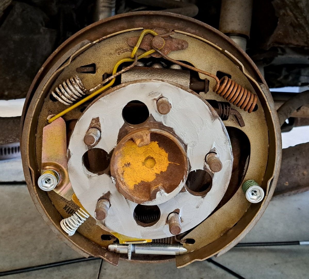

Here's some pics of the driver side after I put everything back together.
Old Mar 31, 2025 | 10:57 AM
jaunty75's Avatar
Posts: 15,194
From: southeastern Michigan
Ha Ha! I see your problem. You have two rear shoes on the same side. The two shoes are identical. They shouldn't be. I'll bet if you pulled off the other side drum and looked, the two shoes would be smaller and identical.

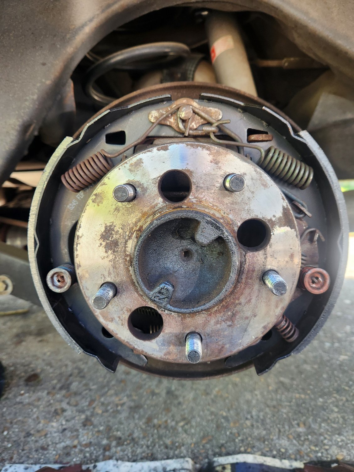

Here's a photo of the rear brake, driver side, on my '73 Delta 88 after I redid them. The front of the car is to the left. Note that the front shoe pad is shorter than the rear shoe pad. I've made this mistake before in doing a brake job.
You need to remove the rear shoe on the other side and put in place of the front shoe on the driver's side, and then put the shoe from the driver's side onto the rear of the other side.

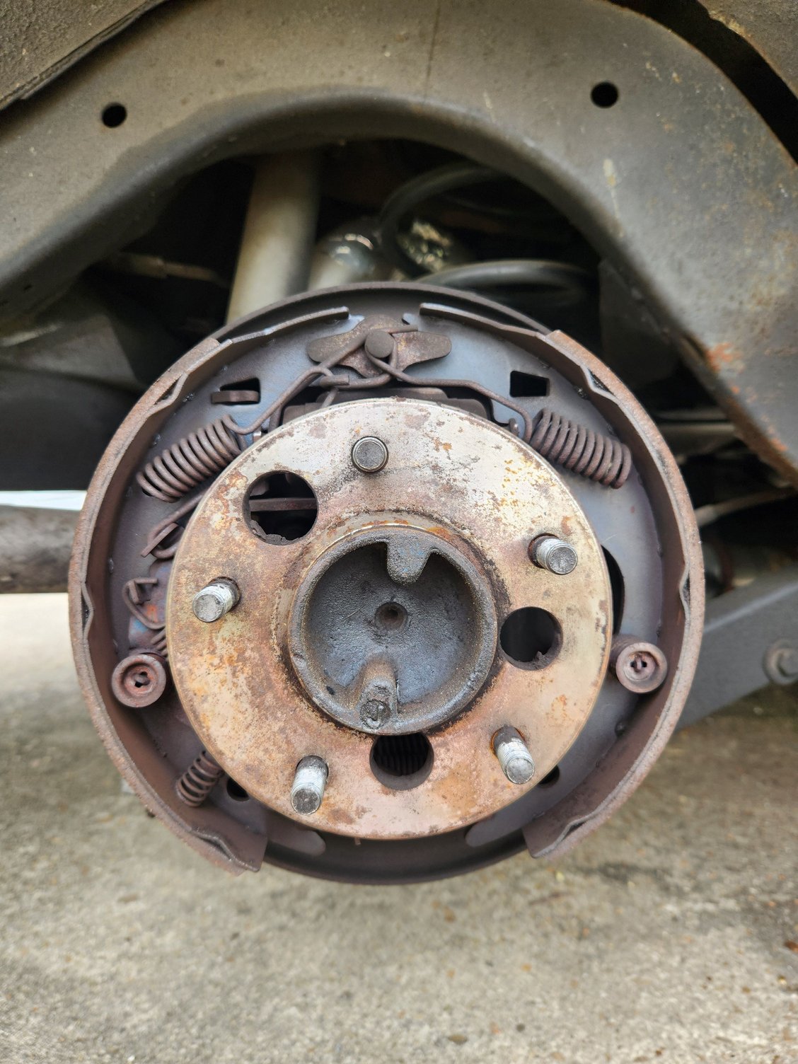

Just for yuks, here's the passenger side brake. The front of the car is to the right. Note how the front shoe is shorter in length (goes less far around the circumference) than the rear shoe.
Old Mar 31, 2025 | 11:07 AM
Posts: 12,810
I think baby needs a new pair of shoes. They don't look like the ones I see in the CSM.
I'll check it, but how would that cause the problem?

Here's the diagram out of the '73 chassis manual. I'm guessing '72 is the same. The front of the car is to the left, so this is the driver's side. The shorter lining, or "primary shoe," is to the front. The longer lining, or "secondary shoe," is to the rear.
Old Mar 31, 2025 | 11:29 AM
jaunty75's Avatar
Posts: 15,194
First of all, you wouldn't get equal braking power from each side. Secondly, you have too much brake shoe area on the driver's side, and the system can't adjust to compensate for it. So you're getting too much frictional heating, which is why that side is so much hotter than the other side and why it even locked up on you once. I would fix the problem right away. If it didn't matter where you put the shoes, they wouldn't make them two different sizes.

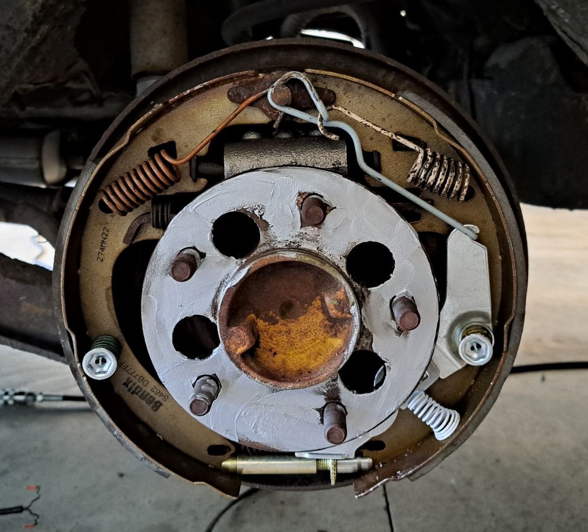

Well it looks like I got some work to do...here are both sides as of now...
Driver side
Passenger side
Old Mar 31, 2025 | 11:47 AM
jaunty75's Avatar
Posts: 15,194
Yup. You have two front shoes on the passenger side and two rear shoes on the driver's side. I wouldn't drive the car any distance until it's fixed.
You have the LONGER shoes on the driver side. That's why that's the hotter side.
I got my pictures mixed up...this is the driver's side...shorter shoes
Passenger side...longer shoes
