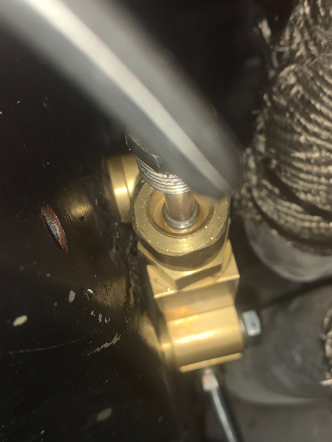

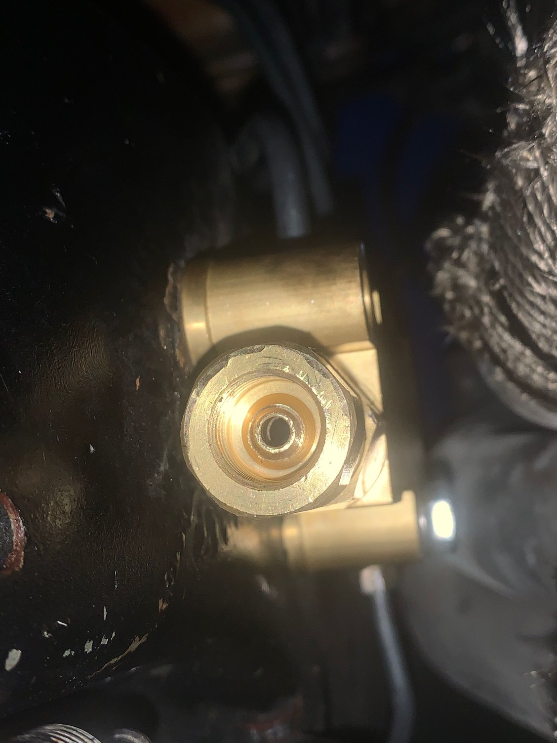

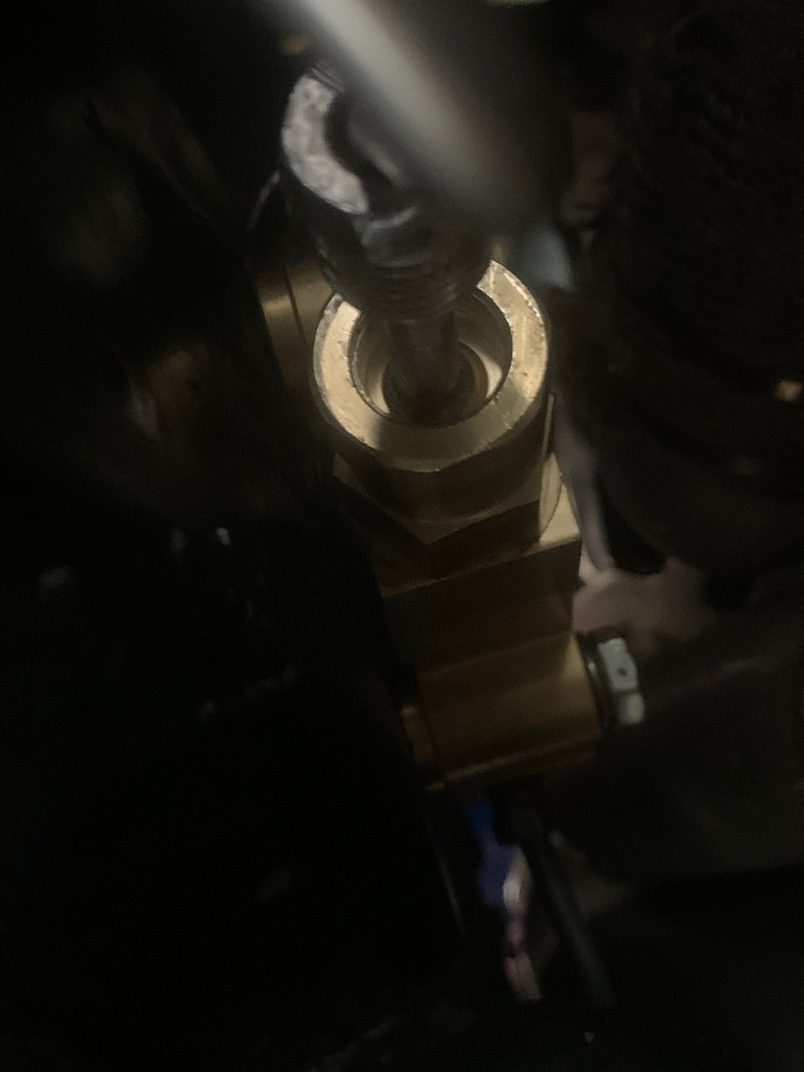

pressured it all up again and found the leak. It is the Rear brake hard line connection where it attached to the valve.I had to drop the header to get a line wrench on it backed it off and reseated and tightened it more till it wouldn’t give. Pressured up again and it started leaking again! backed of off again and made sure the hard line was square and tightened the nut and pressured up and still leaking.
This hard line was brand new 1000 miles ago from OPGI. I compared the new valve to the old one that I thought failed and the connection is same.
based on what you see in this photo does it look like the hard line was not Flared correctly?
Old Mar 2, 2024 | 11:07 AM
Posts: 50,857
Well, it's impossible to tell without a photo of the flare on the hard line, but that fitting on the combo valve is trash.
Consider next time don't be so ready to throw money away on replacing new parts that can't be the cause of the problem.

Post a picture of the hard line flare, if it is bad it will damage the surface to which it mates. My guess is that it is bad now even if it wasn't from being connected to the surface in the pictures supplied.
Old Mar 2, 2024 | 11:22 AM
Posts: 50,857
The flare in the steel line likely wasn't going to be damaged by the soft brass combo valve fitting. More likely is that the flare on the hardline caused those gouges.
Old Mar 2, 2024 | 12:56 PM
Sugar Bear's Avatar
Posts: 4,126
Agree, which means it is likely they will both need to be replaced at the same time.
