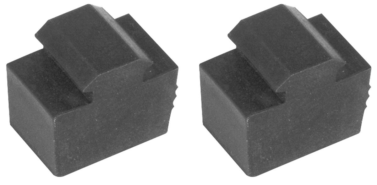

Are these the ones?
http://www.opgi.com/p/brakes/2385/176/MMP5220.html

Unfortunately, no. The piece I'm looking for is a round, donut shaped piece about .75" thick and 1.25" in diameter with a hole in the middle.
Again, of all the things not reproduced.....!
Thanks, for looking.
