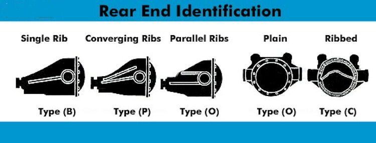

The original would be an 8.5" 10 bolt rear. Look at the side of the center section for two parallel ribs, and on top for a boss where the rear brake hose is mounted.

The original axle would have been a corporate ten bolt 8.5" with the Olds-unique bolt-in axles. The center section is the same as the Chevy 10 bolt but the outer wheel bearings and seals are unique to the Olds application. A photo of the axle will help confirm what you have, since it sounds like the car has been mucked with.

If it really is a 3.31, then it is likely an 8.2" 10 bolt rear, and there are more than one flavor of that rearend. You would need to look at the sides of the center section to see the rib configuration to help ID which one it is.
https://classicoldsmobile.com/forums...r-axle-155066/
thank you, judging by his pictures on the ad, I believe its a type B with plain cover.

Here's a link to one of our member's business page (monzaz, Jim at JD Race). He has images and descriptions for identification, and also part numbers for bearings and seals. If you have any questions, call or e-mail him as he is extremely knowledgeable and is an excellent resource.
http://www.jdrace.com/content/diff_id/10bBOP_Buick.php

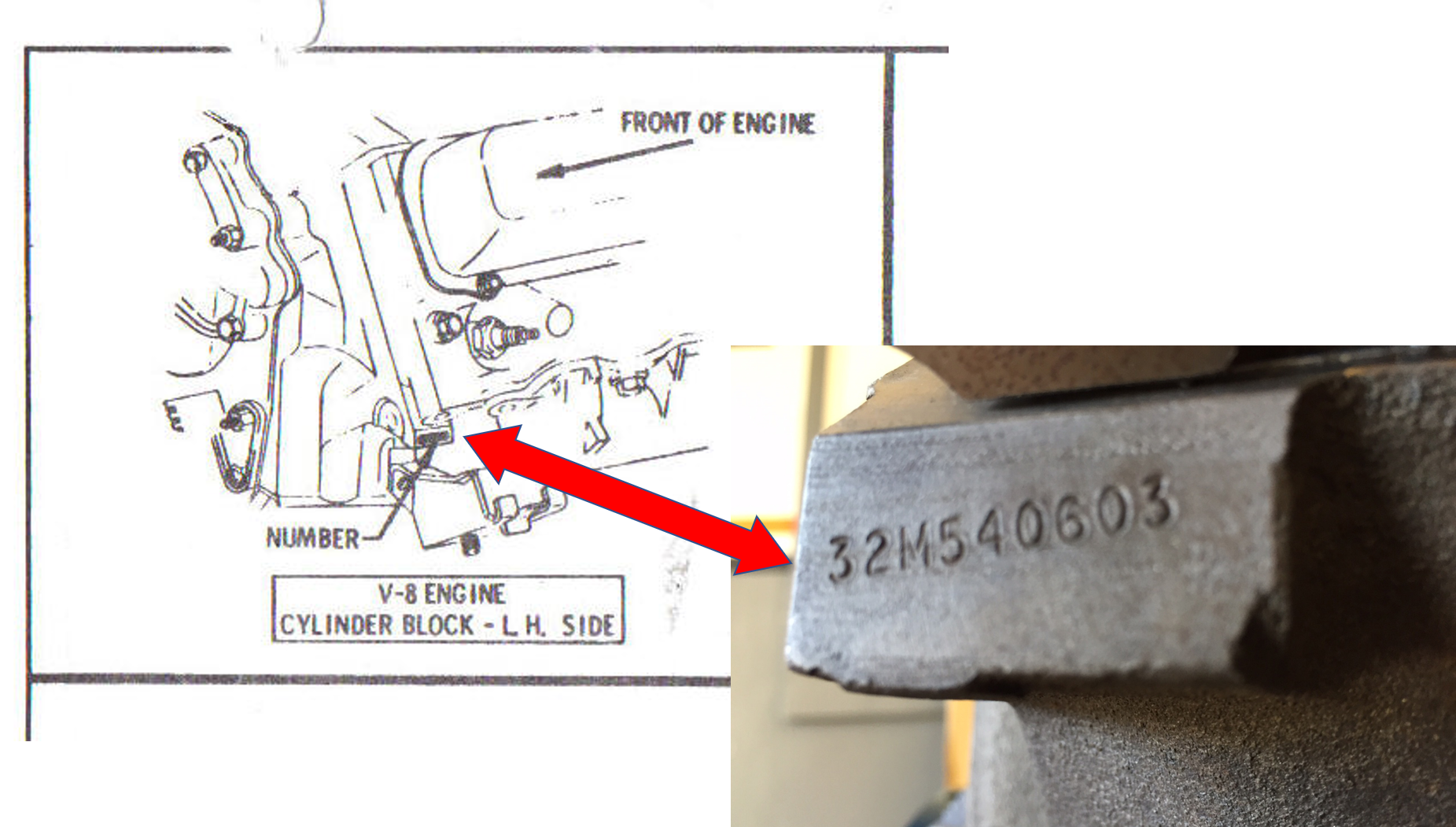

hey Joe, where would the vin be on a 350? Going to see if they lied about numbers matching. If they did, I think it's time for a lawyer.

Phil, have a look at this thread. Post #4 will show you several photos of the vin location on the block.
https://classicoldsmobile.com/forums...i-have-171184/

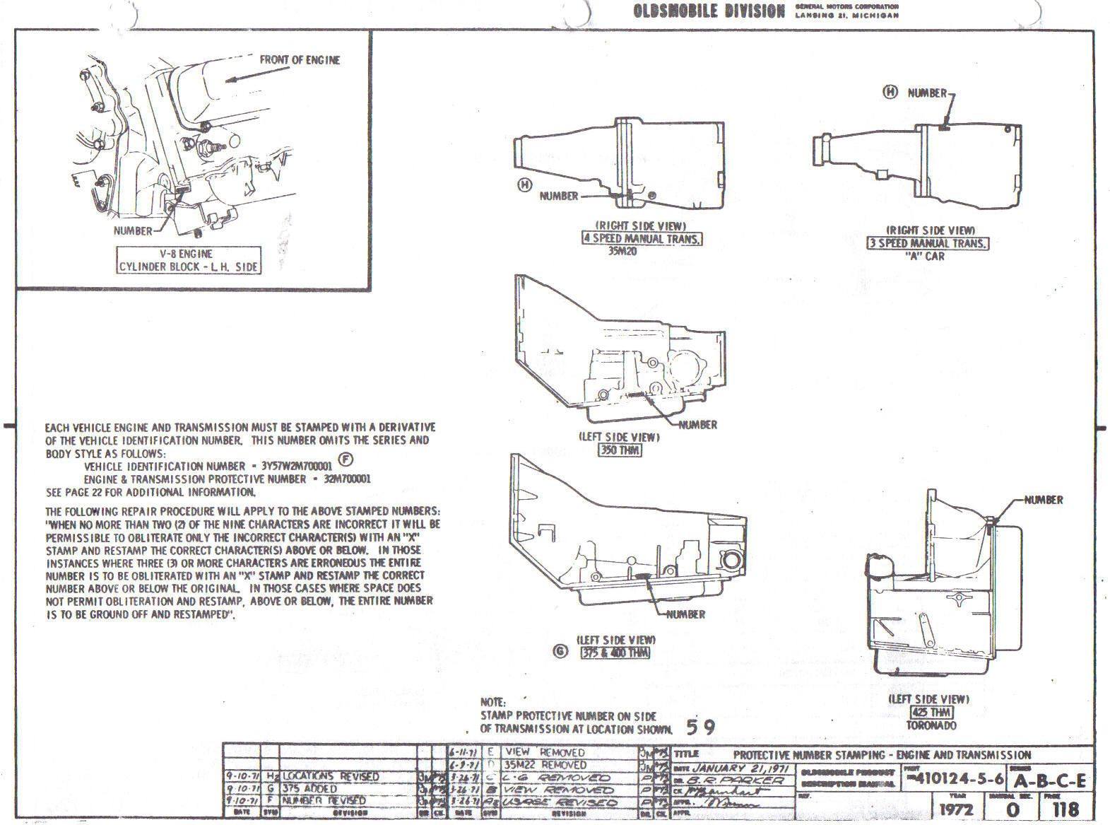

It's in the same place on every 1968-90 Olds block.
There's also a VIN derivative on the trans that should match.

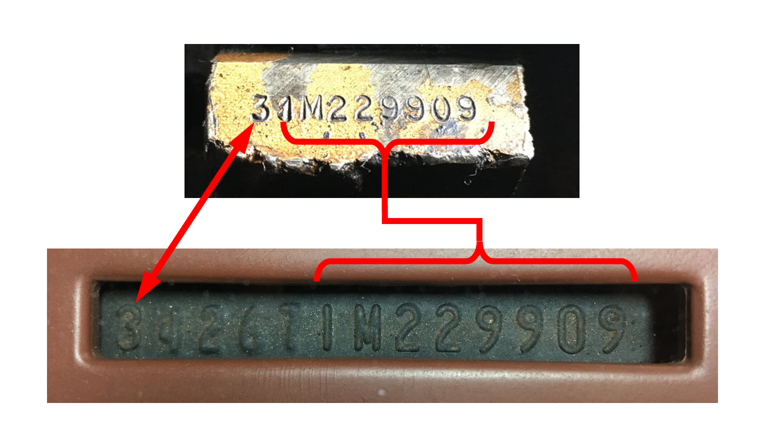

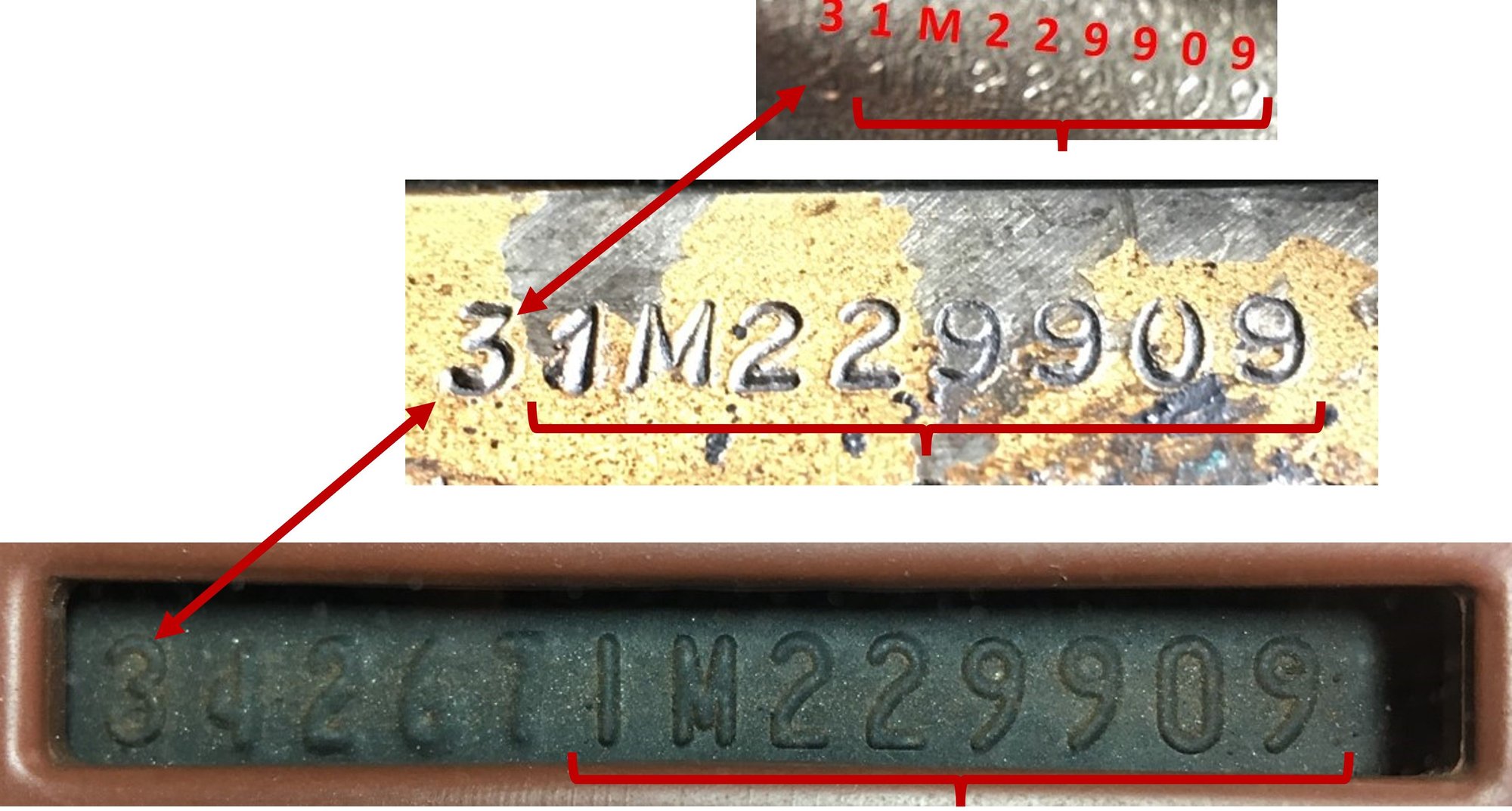

For completeness, here's how the VIN derivative matches the VIN.
