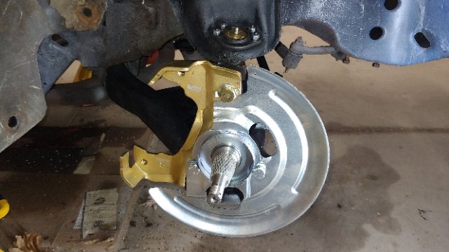

Step 1: Install the steering arms, backing plates, and caliper brackets. This was pretty straightforward and everything lined up nicely. I was concerned about the far bolt hitting the sway bar link, but after installing the new inner/outer tie rods with sleeves and testing, it doesn't turn that far.
Step 2: Pack the wheel bearings, and put them in the rotors, install the seal, and put them on the new spindles. Not too bad either, and such a nicer/cleaner look.
Step 3. Put on the calipers. This was a little tricky, as they just went on too tight and didn't want to hammer them on. The issue is the bottom part of the caliper doesn't fit EASILY onto the caliper bracket, there's some finagaling involved. But after carefully assessing the fit, I was able to get them on, and the rotors still spun. Pics are later for this.

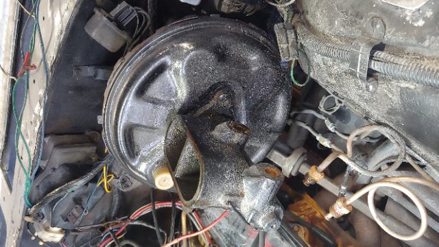

Step 4. Start taking off the master cylinder and booster. The master cylinder came off just fine. The booster bolts are just hard enough to get at to make life difficult, and I could only get in there with a wrench. And the bolts/nuts had been painted, which made life even more difficult.
In the bottom of that picture, where the brake lines go down, there's a hollow bar. Nothing runs through it, and I don't see what the purpose of that is. The book doesn't show this either, but it definitely looks stock. Any ideas what that is and
what is there for?

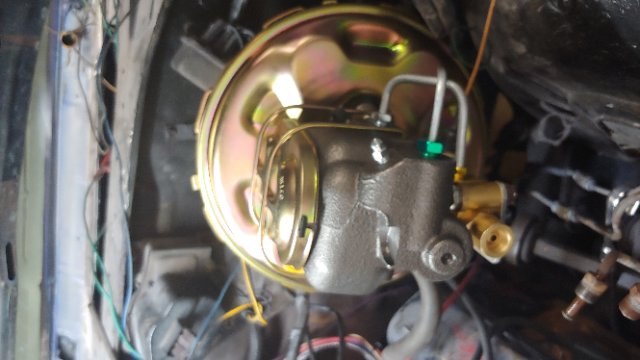

Step 5. Install Master cylinder. I installed the new proportioning valve to the master cylinder before putting it in the car, as it was easier than trying to assemble it in the car. But this thing is HUGE compared to the other one.

I had a couple other things to do, like grease everything, install the sway bar bushing, sway bar links, and I also had to finish putting in the radiator fan shroud. When I did take it for a spin, the brakes were super mushy, then really hard and didn't really grab until the end of the brake pedal travel. I went through and bled everything again, including the bleeders on the master cylinder and noticed I wasn't getting a lot of fluid out the rear wheel cylinders. I checked the union, and had a big leak there. After tightening that up, and re-bleeding the rears, It was getting a lot more fluid. Took it for another spin, and it stops really well. The pedal is a little soft in the beginning, but then feels more solid. I'm going to go through and check everything for leaks, and bleed one more time, but it stops now, which is better than what it did before.
what is there for?
My guess is it's the tube for routing the positive battery cable to the starter.
