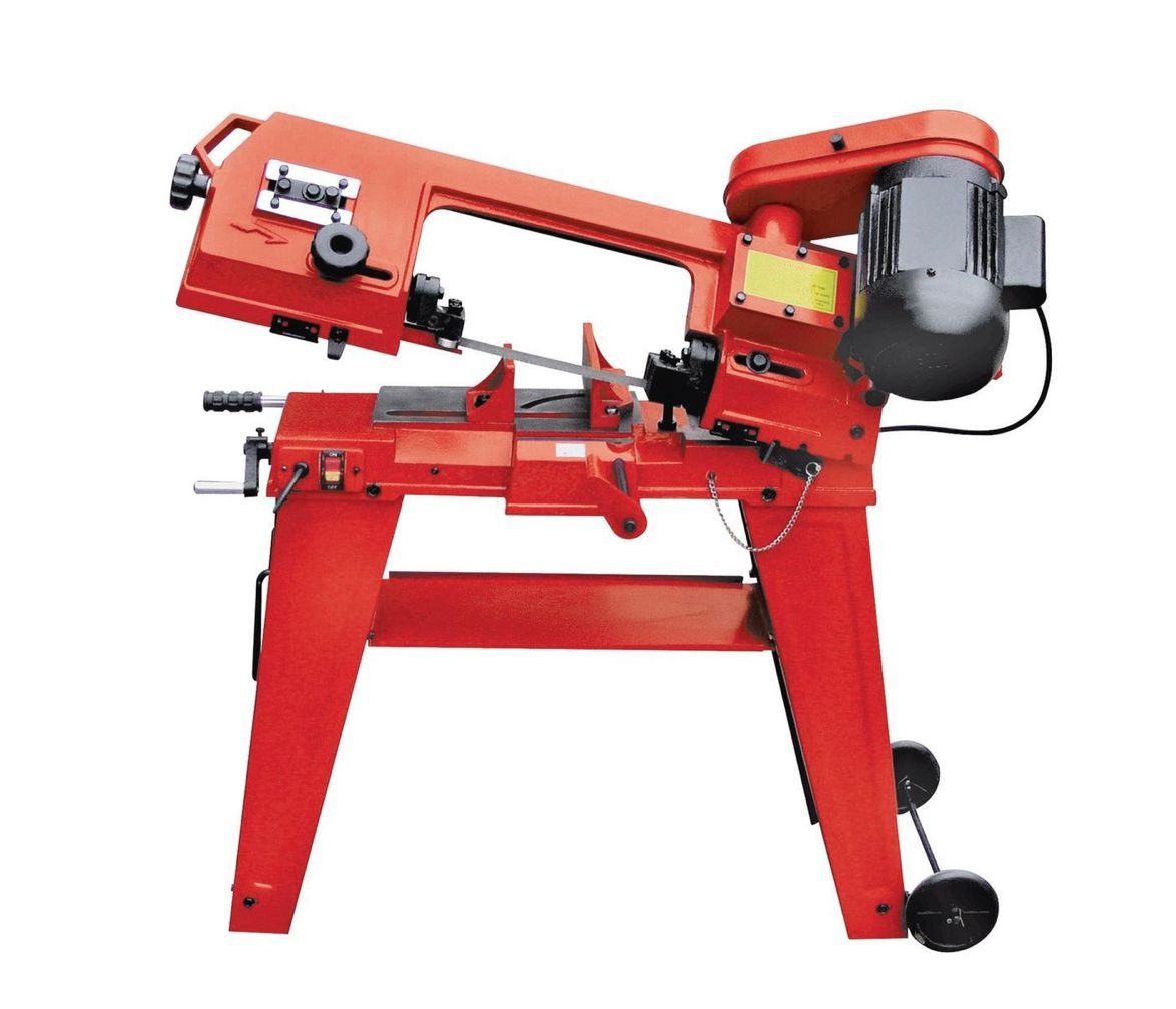

i found a big horizontal band saw on cl like the one pictured but bigger, i cut a lot of stuff w this, not so much for cars but more general stuff

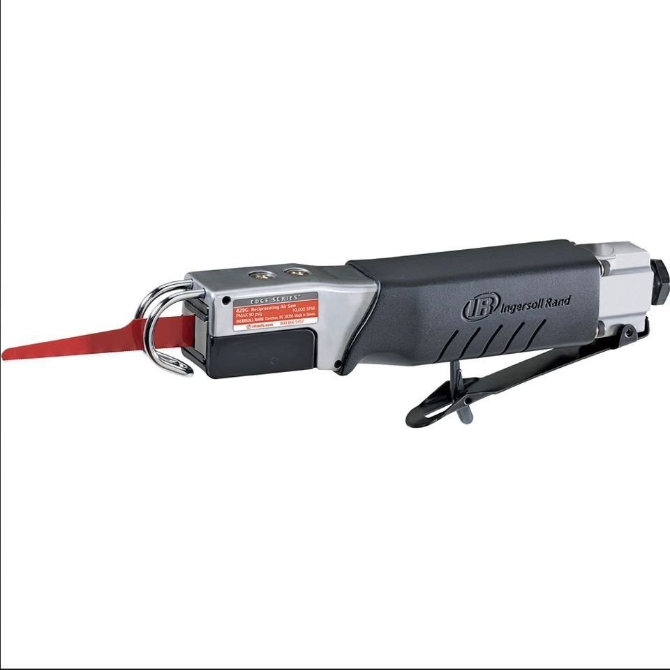

the air saw was super nice for floors w a shorter blade. I used that because its small and can fit up under the dash.

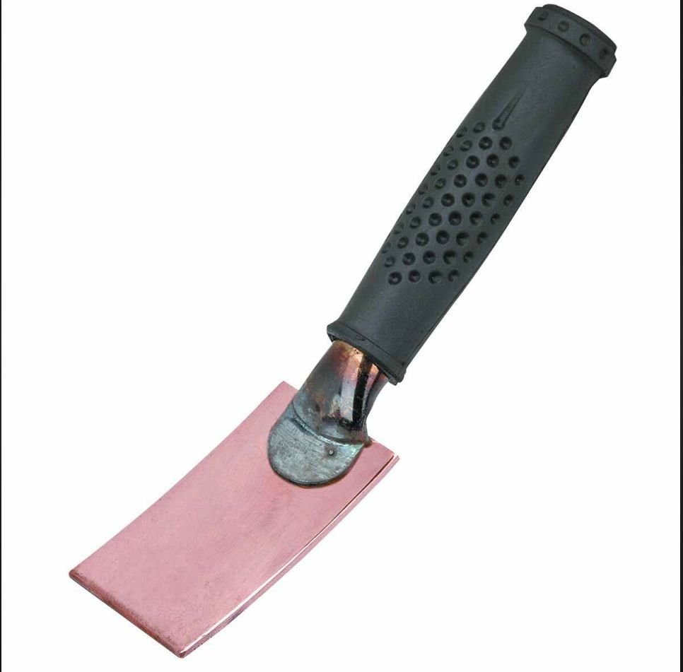

the spoon was good when i was burning thru sheet metal w less than great fit up

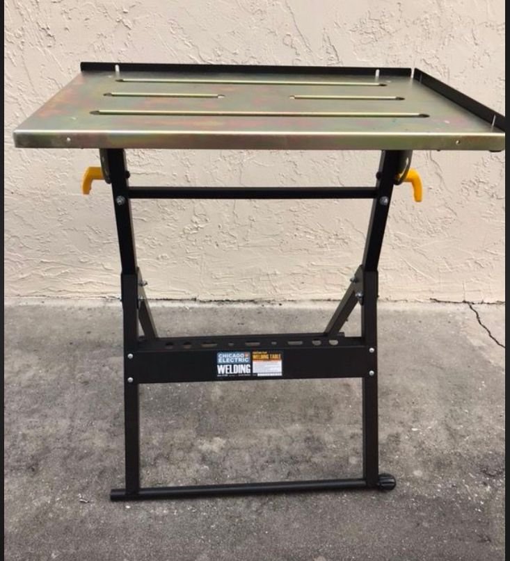

the table is a common one i got it on amazon. It angles its sturdy and its folds flatish for good storage.

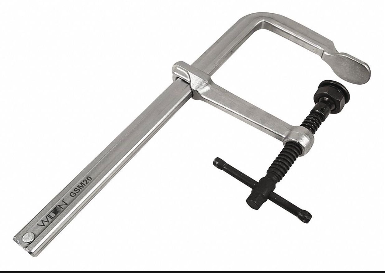

the f clamp or bessy clamp is great for holding stuff and has a big size range.

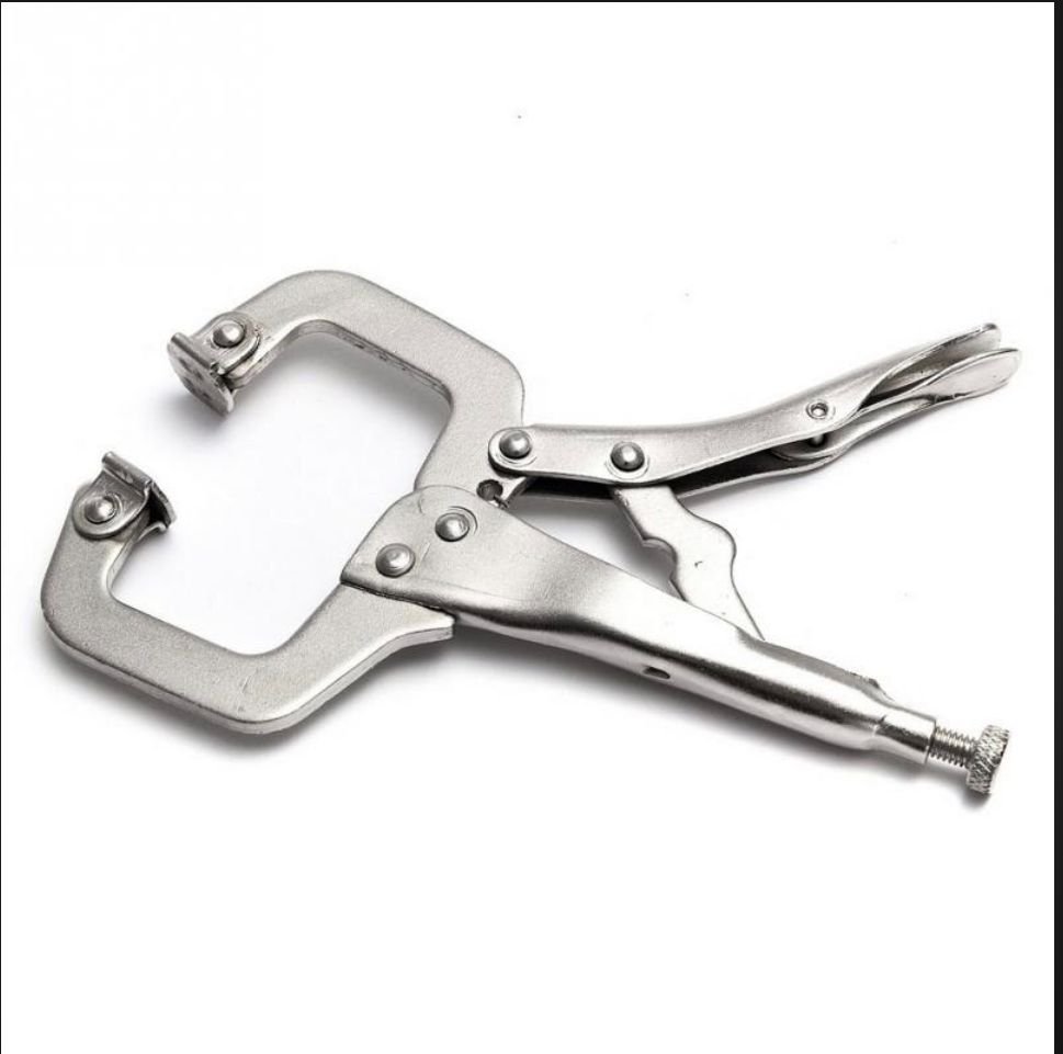

the vice grip clamps work good to.

I use a saw like retro pictured all the time. You can clamp together your patch over your repair and cut at the same time, that way they match even with zigs and zags. One thin cut you can weld together. I am like you, I had a welding class at a community college before MIGs were common. I bought a mig welder about 10 years ago and looked at all the instructional videos on line,etc. THEY SURE HELPED BUT IN A WAY MADE IT TOO (oops started yelling) complicated. Really just the best way to learn it is get some scrap, cut it and weld it back together. Glenn mentioned it's like golf, I agree. Sometime you will lay a perfect bead and think I am getting good, then you blow thru and mess it all up. Consistency is the hard part in golf, welding on and on... Good luck, you'll do fine.
