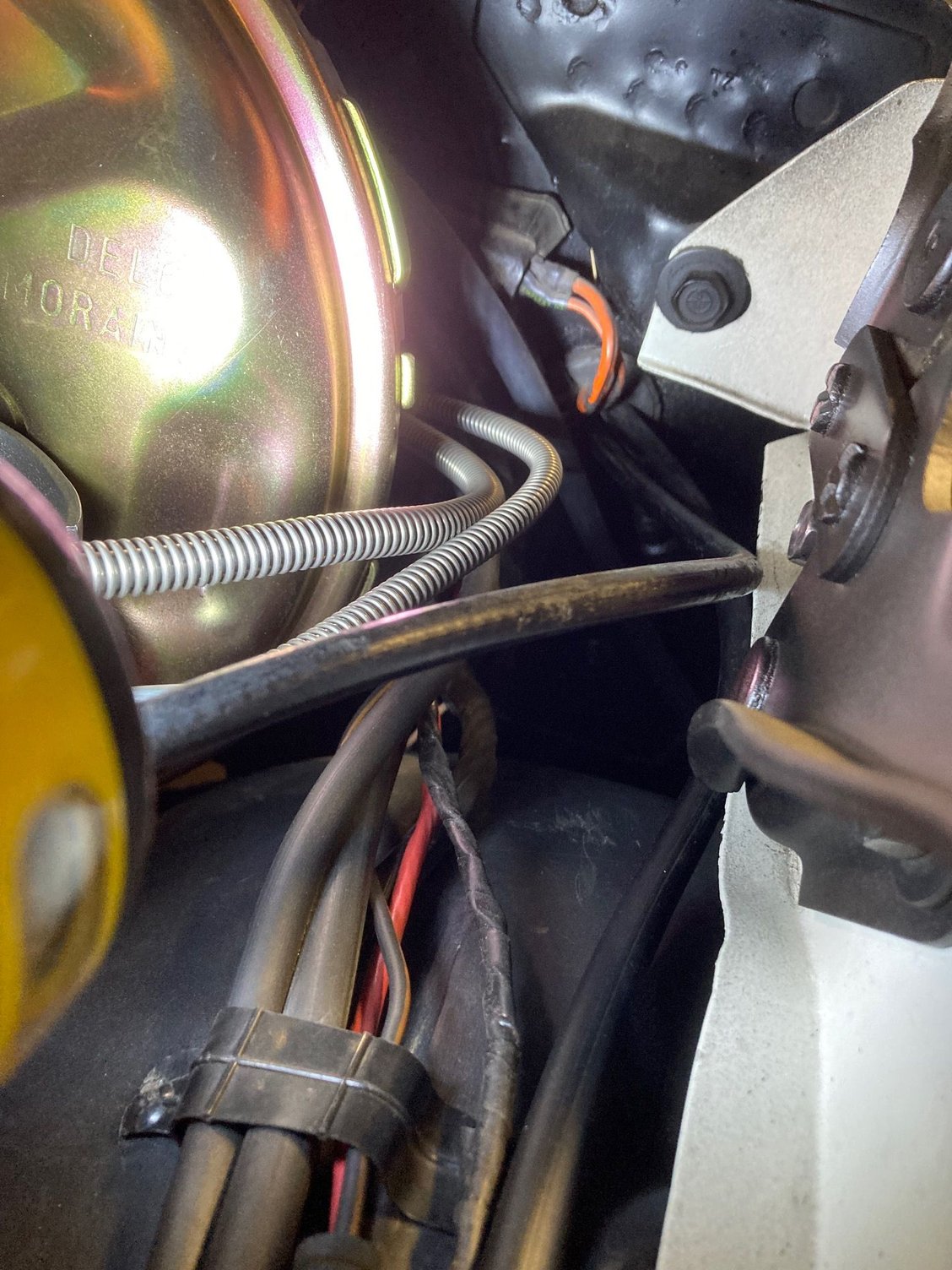

My '69 4-4-2 has factory cruise control. Here is a pic of where the cable from the speedometer to the transducer passes through the firewall. It is just to the driver side and low to the brake booster. I don't know if it's the same for '70.
Randy C,

Thanks for the picture.. looks like your cable is passing through the accessory grommet. My grommet is full because I have a convertible...

I didn't mention in the picture I provided that my '69 is a 4-4-2 convertible. It's heavily optioned, including A/C, pwr windows, auto trans on the console, pwr disc brakes, pwr steering, AM/FM stereo, SSI wheels, rally pack and even front seat shoulder belts.

Kool very nice, but I have a hood lock release, so the accessory grommet has the cruise vacuum hose, the electrical cable for the top and the hood lock release so it's full, so I need to drill another hole but cant located the dimple as per the instructions!!!
