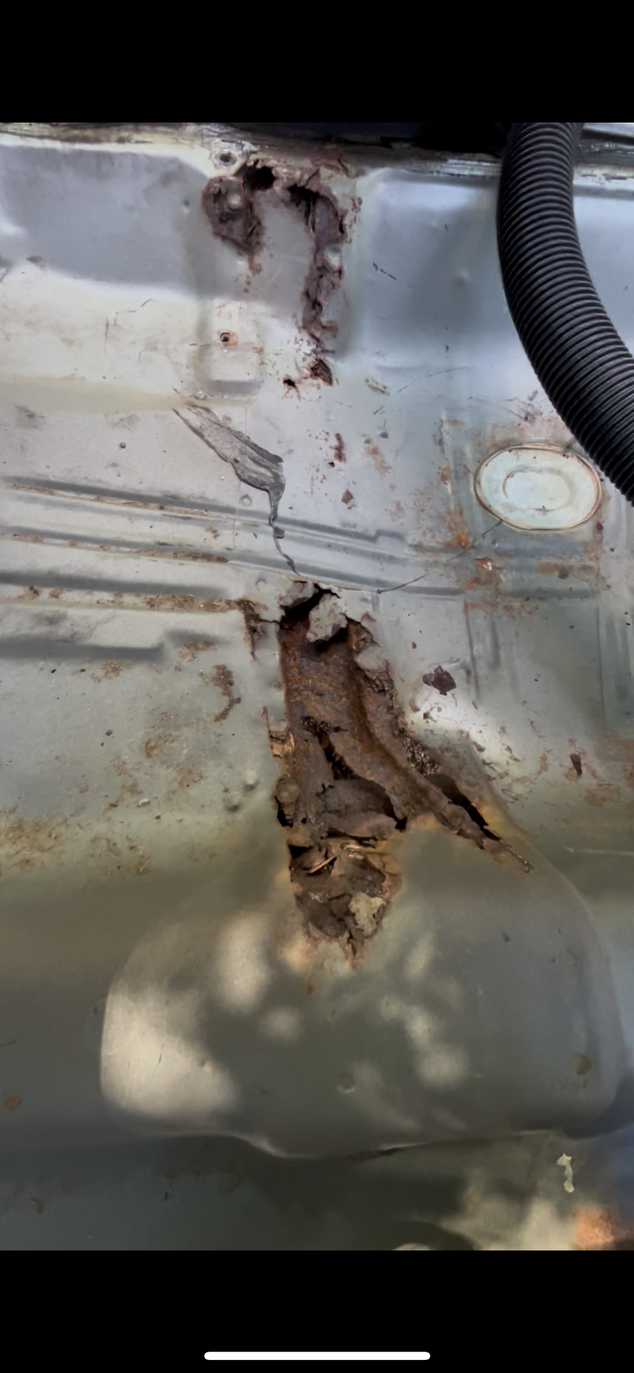

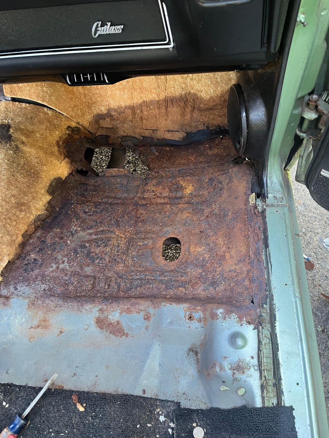

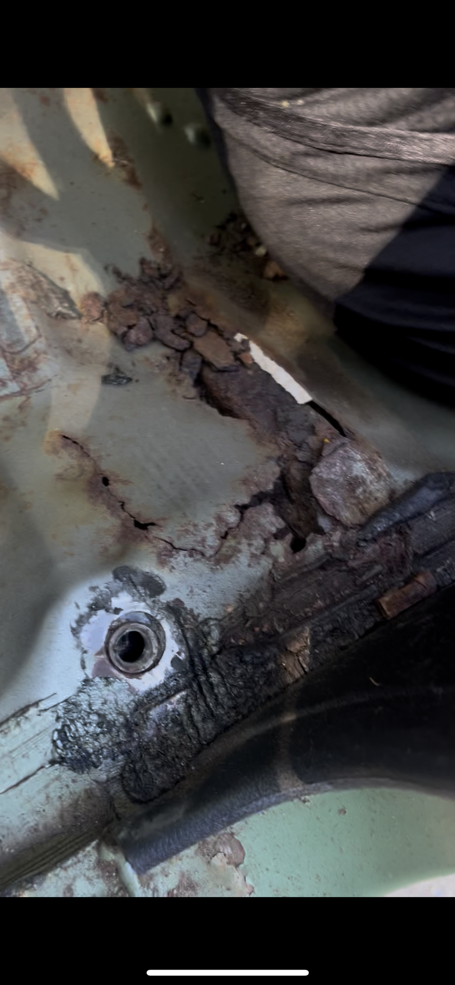

Hello,
I am new to the forum and new to classic cars. I bought a 1970 Cutlass sedan, and I need bodywork done. The crossmembers are shot, and so are the front floor pans. I have the kit, although it is for a 2-door (since nobody makes anything for 4 doors). I am not very experienced with welding, and I do not have the resources to remove the frame. I have to cut everything out and replace it from within. If anyone could give me any tips or steps I should take, that would be great. I'm a college student, so I want to try and do this on my own. I have all the tools I think I will need; Welder (flux core unfortunately), Angle grinder, spatter spray, etc... Please, anything will help! Thanks.
passenger side floor
drivers side crossmember

When you say crossmember are you saying the frame suspension crossmember ? if so I would look into another car. The floor pans will need to be cut out and new ones welded in place. As far as getting your floor pans to fit no they won't unless you want to cut & hack this up. maybe someone on this site can give you some idea's on floor pans. But again if the frame is rotted you are getting into a lot of work, time & money.

I may have misspoke, sorry, still learning the right terminology. I think it may be the floor pan supports? The seatbelts were bolted into them through the floorpans. The frame is okay.
Old Sep 23, 2025 | 12:12 PM
The front seat floorpans are the same as for the 2dr cars, so those are readily available. The floorpan crossmember is also the same and available. The rear seat floorpans are different due to the 4" longer wheelbase, but you may be able to use them in pieces, or possibly get two of the rear pans for each side and splice them together to make the longer 4dr pan. Floor pans are a great place to learn sheet metal welding because obviously it doesn't show once the carpet is in place.

On floor pans for novice welders get to good metal and overlap them a small bit then weld. Buttweldingfloor pans if you’re not experienced will be a most frustrating situation burning hold into the metal. Overlap , Stich weld, then come back slowly and fill in going back and forth to avoid the heat warpage and all.. then undercoat,put carpet down and your good to go.

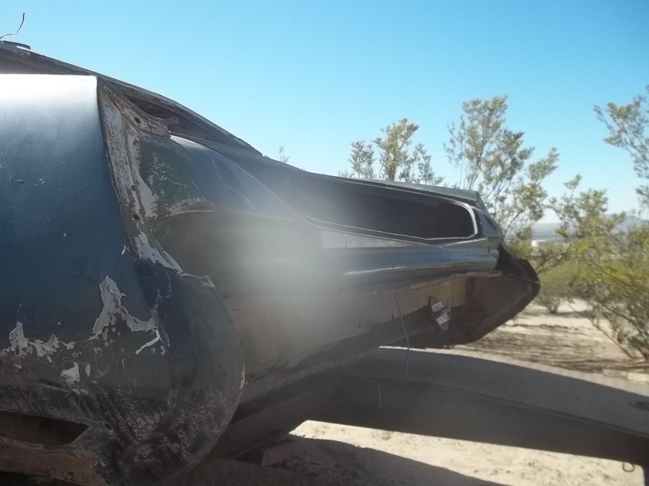

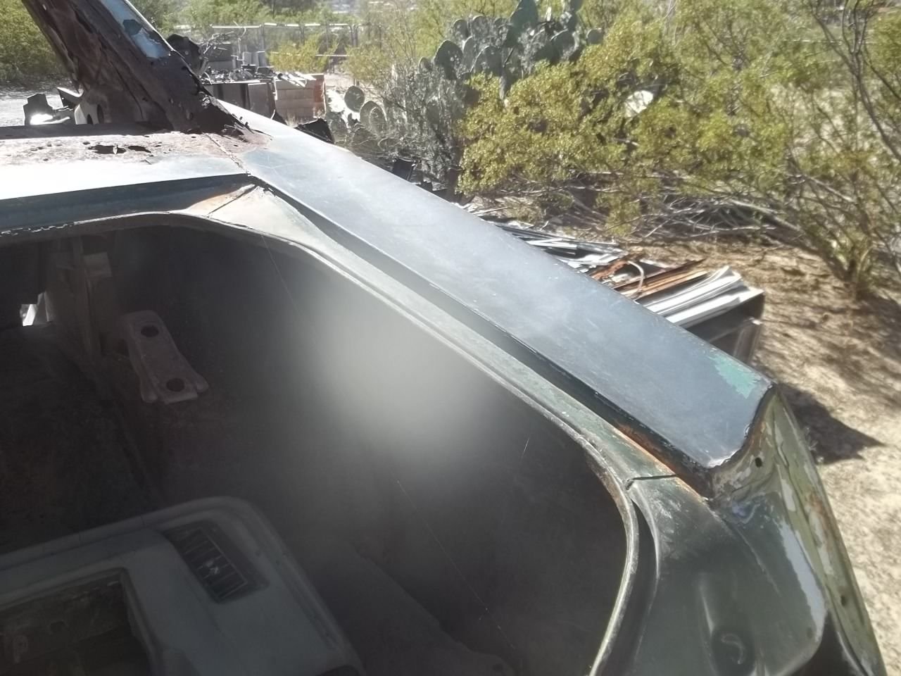

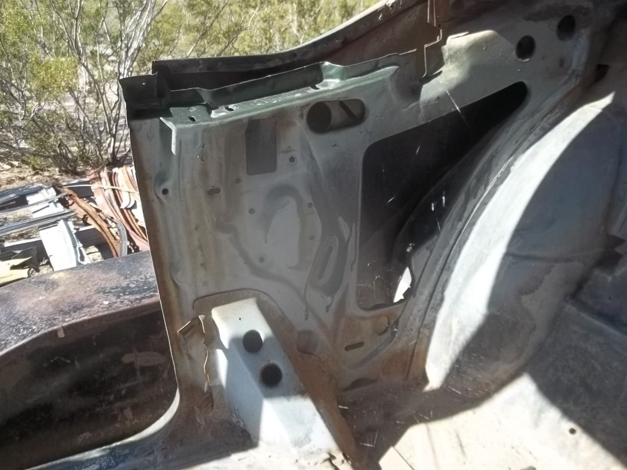

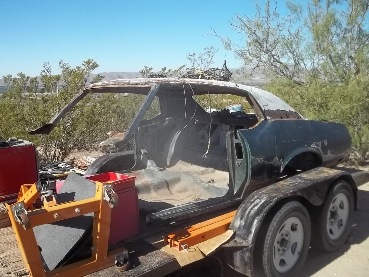

Recently reacquired the remains of a '71 Supreme body tub. Am going to offer up remaining pieces and or sections to anyone that might want them, or could use them. Certainly willing to sell the car whole, what's left of it. The car has localized body cancer, due to the presence of a long gone vinyl top, the rear window area, the trunk filler panel, and lower quarters are ruined due to this. Other areas are very usable. Yes this is a coupe, not a four door sedan, but if the footwells could be used, and perhaps the underfloor braces, let me know. PM if still looking for something. Have a lot of small bits scavenged from this car - dash pieces, hardware, etc. Dave S. internet seller since '01.
