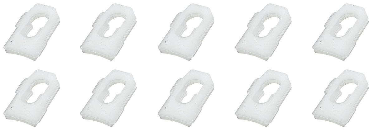

The little plastic retainers may be a problem. I don't think you will find those a any parts store. They are probably unique to the 72 Cutlass.
these look mighty close!
http://www.ebay.com/itm/68-69-70-71-...-/160736496085

There is a different kind of retainer for the bolt hole. It's a metal flap with a wire which wedges inside the trim, with a bolt running through it. Bolt goes into the hole and attach a nut from the other side. Your other trim pieces use this type. Really easy to mess with the ones for the quarter panels behind the wheel. It's also a pretty common type of trim hardware. That seller has that type - they're called Plate clips.
The clips you found should be the right ones.

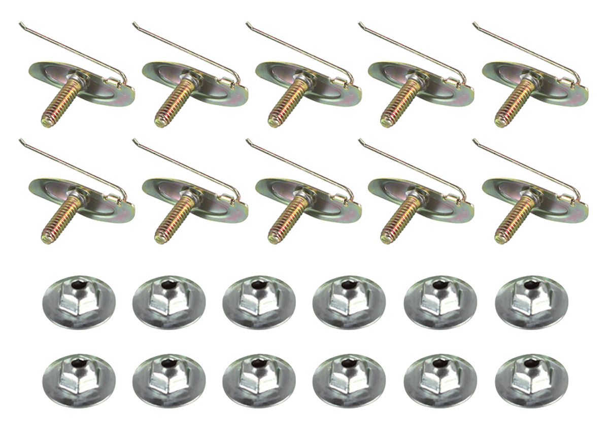

Are these what is needed?

Those will work. I prefer the flat clips with a metal wire instead of the plastic, but the function is the same.

yes, i believe so!
it looks like they screw into something in the door
i need 4 of them are those you show available?

You need 4x what I posted or 4 of these?
http://www.clipsandfasteners.com/Doo...0_p/a10617.htm
http://www.clipsandfasteners.com/Mou...h_p/a12962.htm
May want to make sure these are correct, just did a quick search for you and I found these.

Probably both - does the 2nd photo show a clip that goes inside the door and the screw replaces this "button" that seems to be welded into the door?

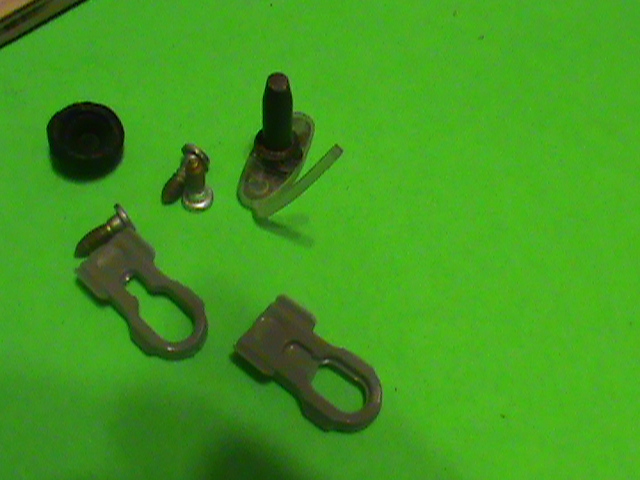

Question Weld Stud
More fishing around in the 1972 Fisher Body Manual reveals that it is indeed called a "Weld Stud"
If a weld stud on outer panel becomes damaged or broken off. use the following procedure:
1. Drill a small hole in the panel adjacent to where Original weld on stud was installed.
2. Insert a self sealing screw through original clip and into outer panel, or replace damaged weld stud with self sealing screw type weld stud.
A little Googling did not reveal too much in terms of a "self sealing screw type weld stud". Just a few Chinese manufacturers.
Any thoughts?

Those screws that come with the plastic clips have sealer on them and that is what is used when the weld studs are missing.
