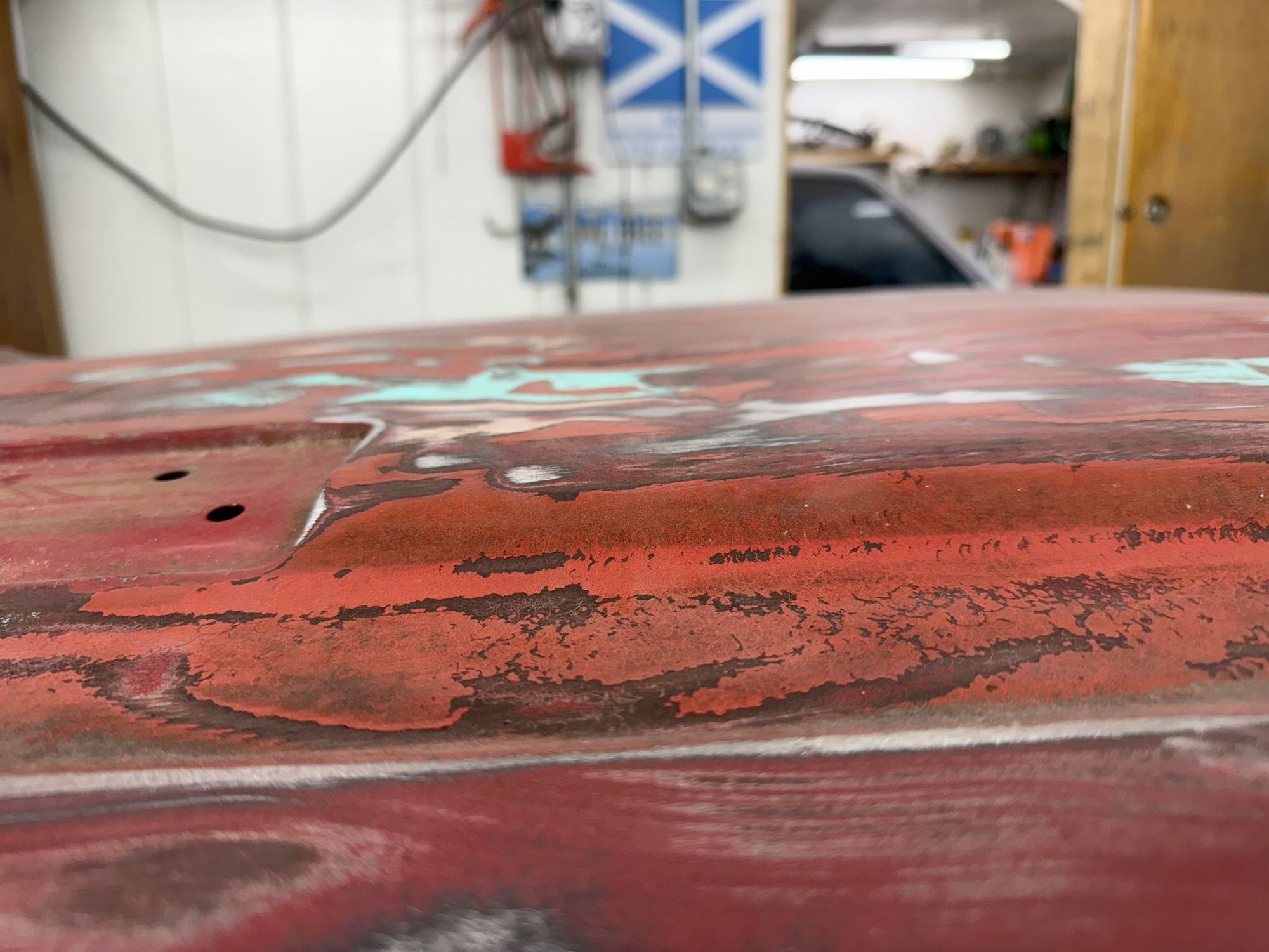

Question 68 442 hood issues
My 68 442 had a flat hood on it when I bought it. So a while back, hoping I would one day be in a position to redo the car, I picked up a cutlass supreme hood off ebay and stuck it in the basement. I knew it was in rough shape, but now that I am getting the car redone, my paint guy isn't sure its even salvageable. The nose is rusted out (the way they do), there are a lot of small dents, and someone gave it a skim coat of filler at some point. What concerns him the most is that when grinding the paint and filler off, the the center of the hood started to "oil can," meaning i guess that its sort of turned flimsy, and wants to bulge in and out. He's worried that if we use it, when its in the sun, it will flex and crack the paint.
Is this fixable? Is this a trouble spot common to these hoods? Do the louvers and vent add rigidity to that area once they're on the car?

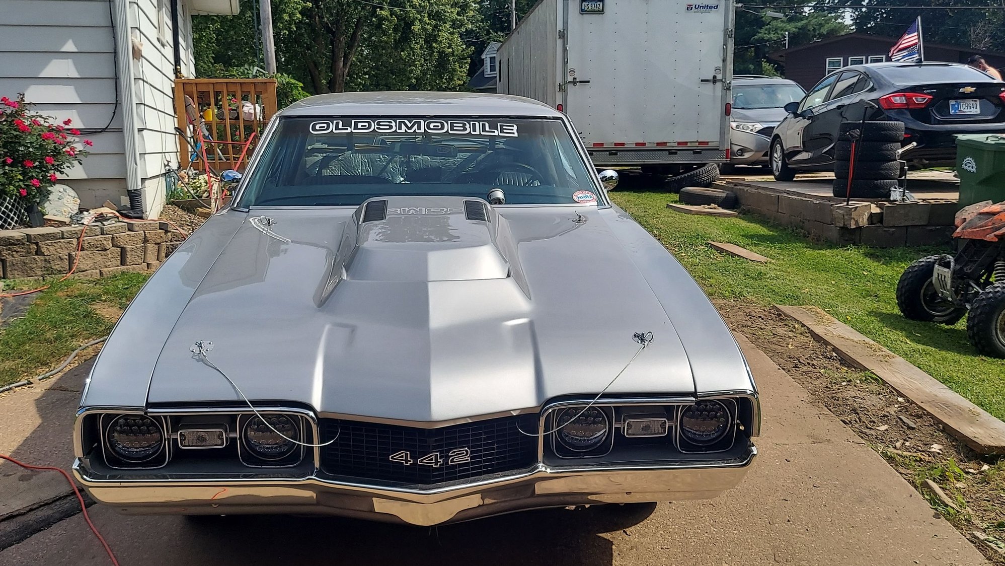

Originally Posted by rothlane'68
Fair enough, but they're not exactly plentiful. This one was hard enough to find and that was 15 years ago.
Yup, in for a penny in for a pound. Were you happy with your results though?
Yes I am.
Lucky I found a retired body man.
With some free time.
Old Apr 8, 2025 | 08:23 PM
rothlane'68's Avatar
Joined: Sep 2014
Posts: 180
From: Central Mass
Looks like it came together really well!
I hope my retired body man does at least as well as yours did.

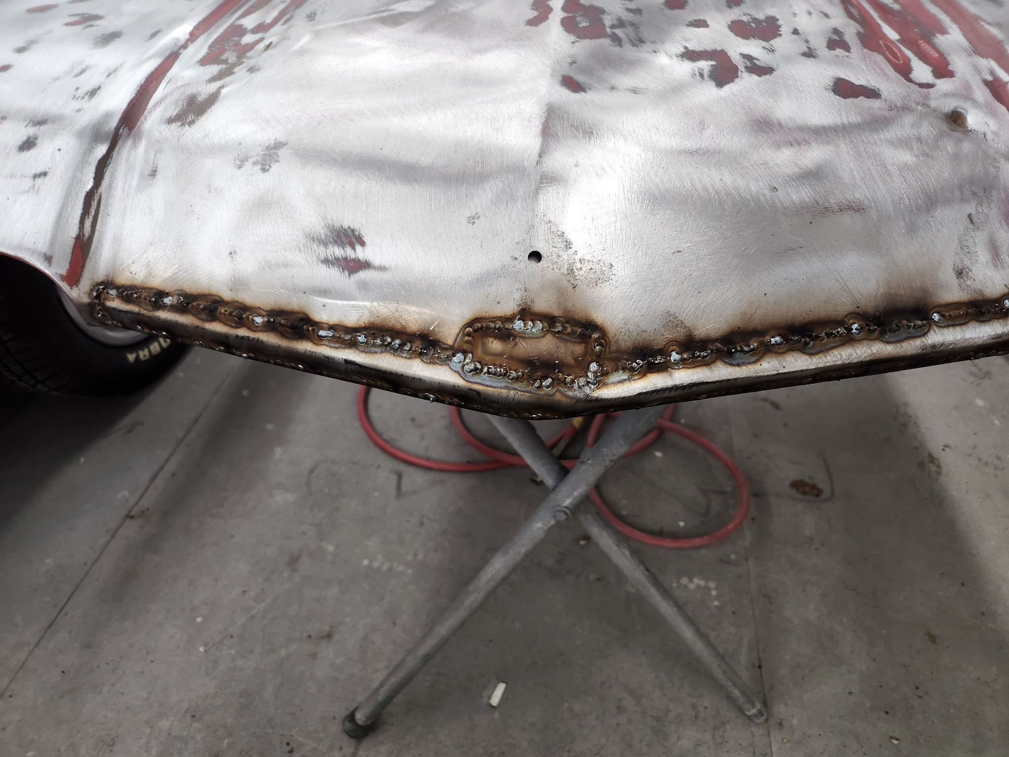

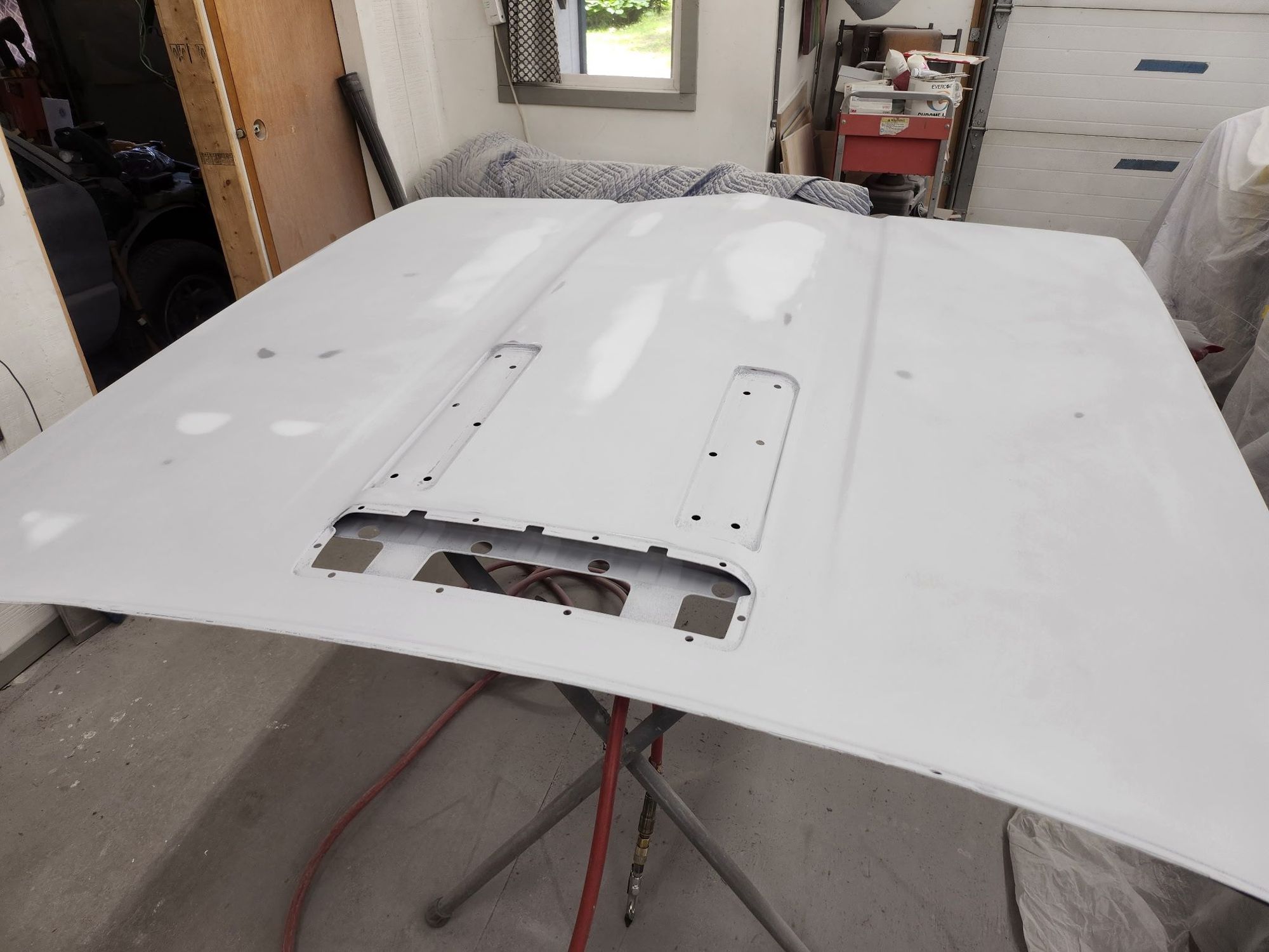

So given the choice between going fiberglass or trying to repair, my body guy scratched his head for about 2 weeks and decided to try a repair.
Heat shrink for the center of the hood, and patches in the front. Came out nice! Glad we kept it out of the junkyard.

Old Jun 14, 2025 | 04:45 AM
OLdGreenPaint's Avatar
Joined: Jul 2024
Posts: 318
From: Iowa!
Looks like the guy bent up a new piece of steel and did a cut out and butt weld process? Looks good in primer!
Nice to save the old steel as much as possible.
