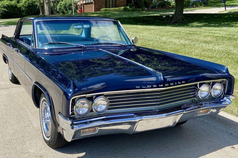

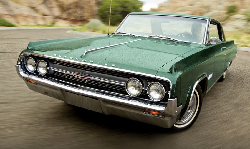

Front chrome hood lip on a 62 -63 interchangeable on a 64 ? Same measurements not sure same curve ? ,Thanks , joe

Three different part numbers so doubtful they interchange.
The hood lip mouldings for any 1964 full size Oldsmobile will work. Both the chrome and the aluminum pieces.
Grp 8.054 p/n 384643, front upper (chrome diecast) moulding 1964 all except F85.
384650 lower (aluminum) moulding.

Not even close.
