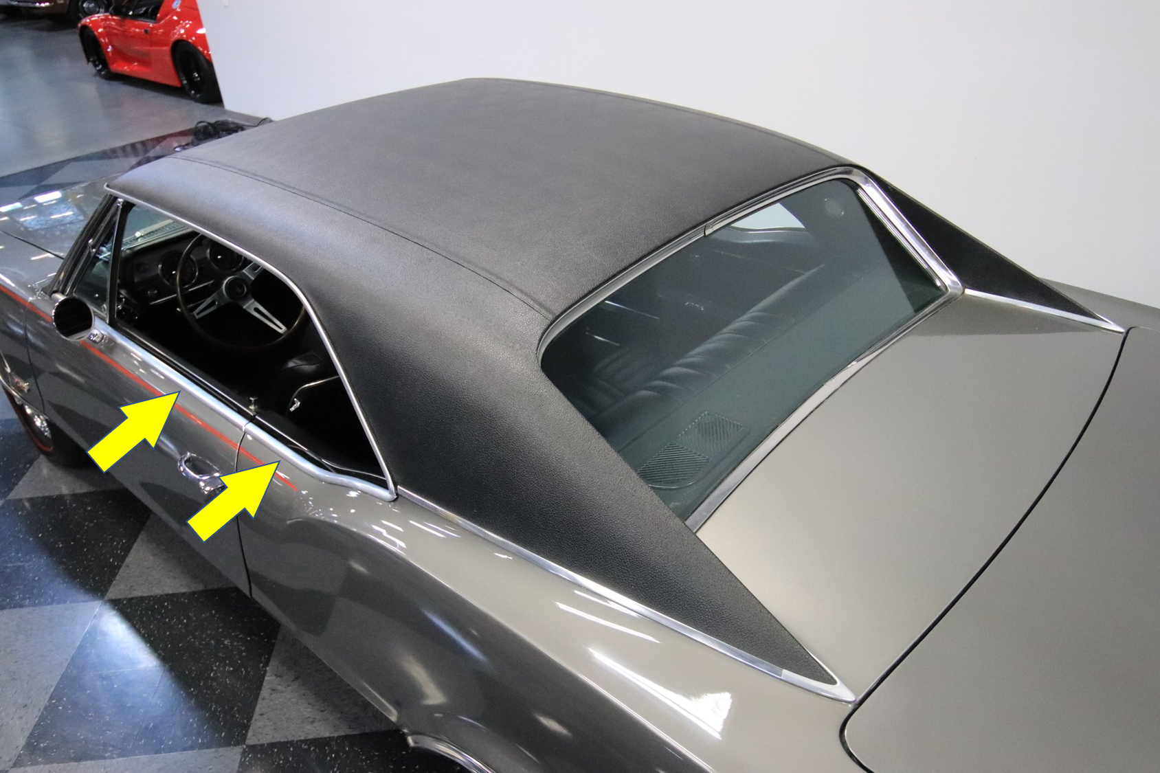

The "special molding" is the RPO B85 anodized aluminum along the beltline. Does your car have these or not? A photo of your car would help us provide you with useful info.
This is what the B85 moldings look like.

no, my car does not have that Aluminum molding, wish it did, that looks great!

I take it that that molding comes with cars that have a vynil roof?

Good thing it doesn’t have the reveal molding because you can’t get felts for those..

No it was just an option that could be ordered.
