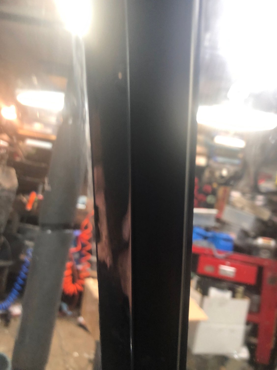

Obviously, there is a technique to adjusting windows I haven’t mastered. I have fiddled, tweaked, cussed, screamed, everything I can thin f to get the windows to open and close smoothly, and fit well. And I’m still not very happy.
I started with the quarter glass. They open a d close smooth, with the glass up the window follows the molded line in the weatherstripping. Same thing with the door glass. The problem is getting everything to open and close with the doors closed. With all the glass down, I can get each window to open and close and fit in the weatherstripping as described in the body manual. With the driver quarter window up, when I attempt to put the drivers glass up, the window wants to g up INSIDE the car, with the quarter glass weatherstripping outside
In tge 30 years I have owned this car, none of the windows sealed very well. I have replaced all the weatherstripping, rebuilt or replaced all the regulators and window guides, and still have sloppy fit.
Im done fooling with it for the summer. I’m seriously thinking of finding a competent body shop this winter and having someone who knows these cars to work their magic.
Anyone in central Indiana willing to help out a Olds fanatic? Or know of am someone or a shop?

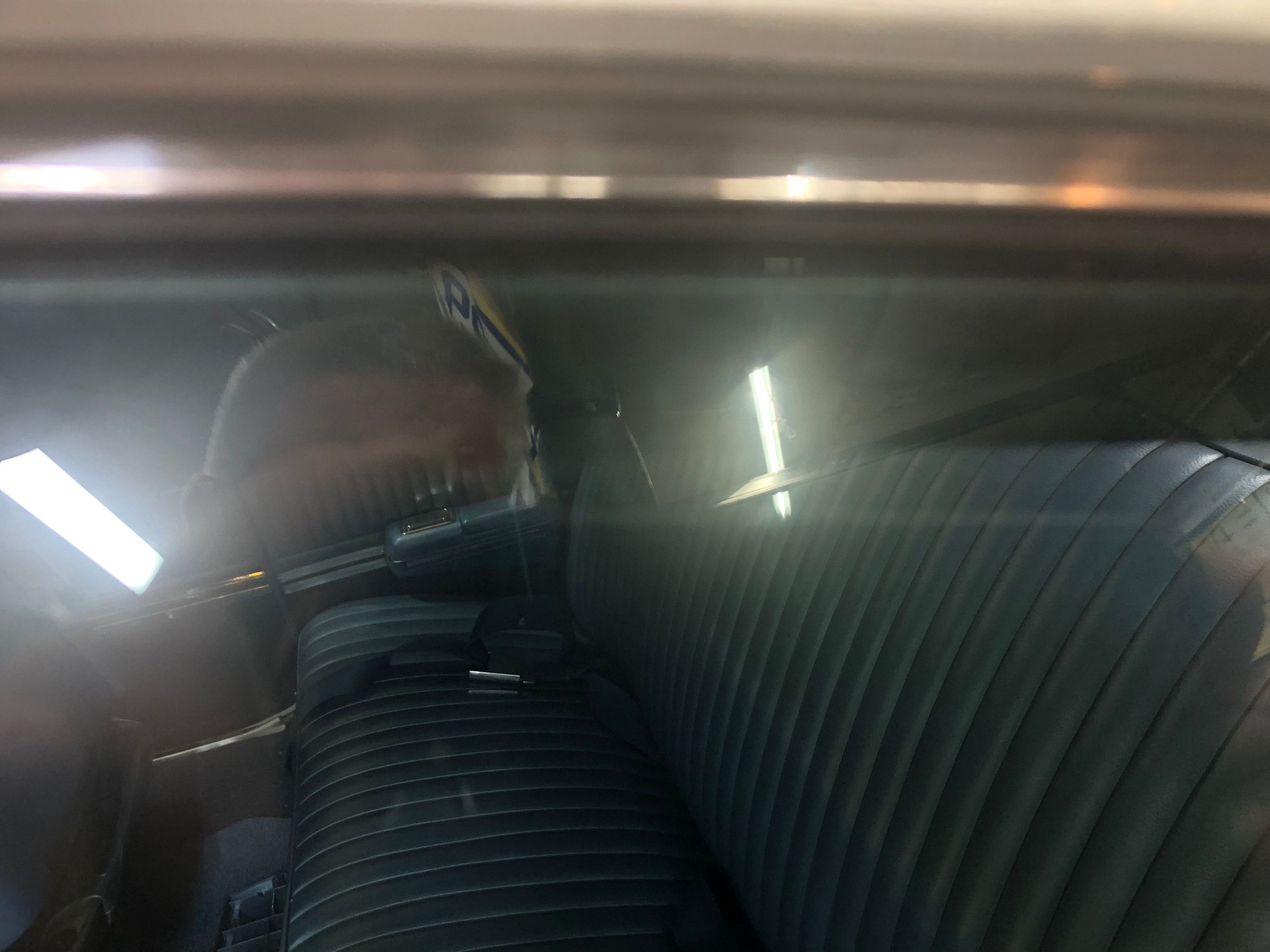

This is the quarter glass in the middle. The glass fits fairly evenly along the lip of the weatherstripping.

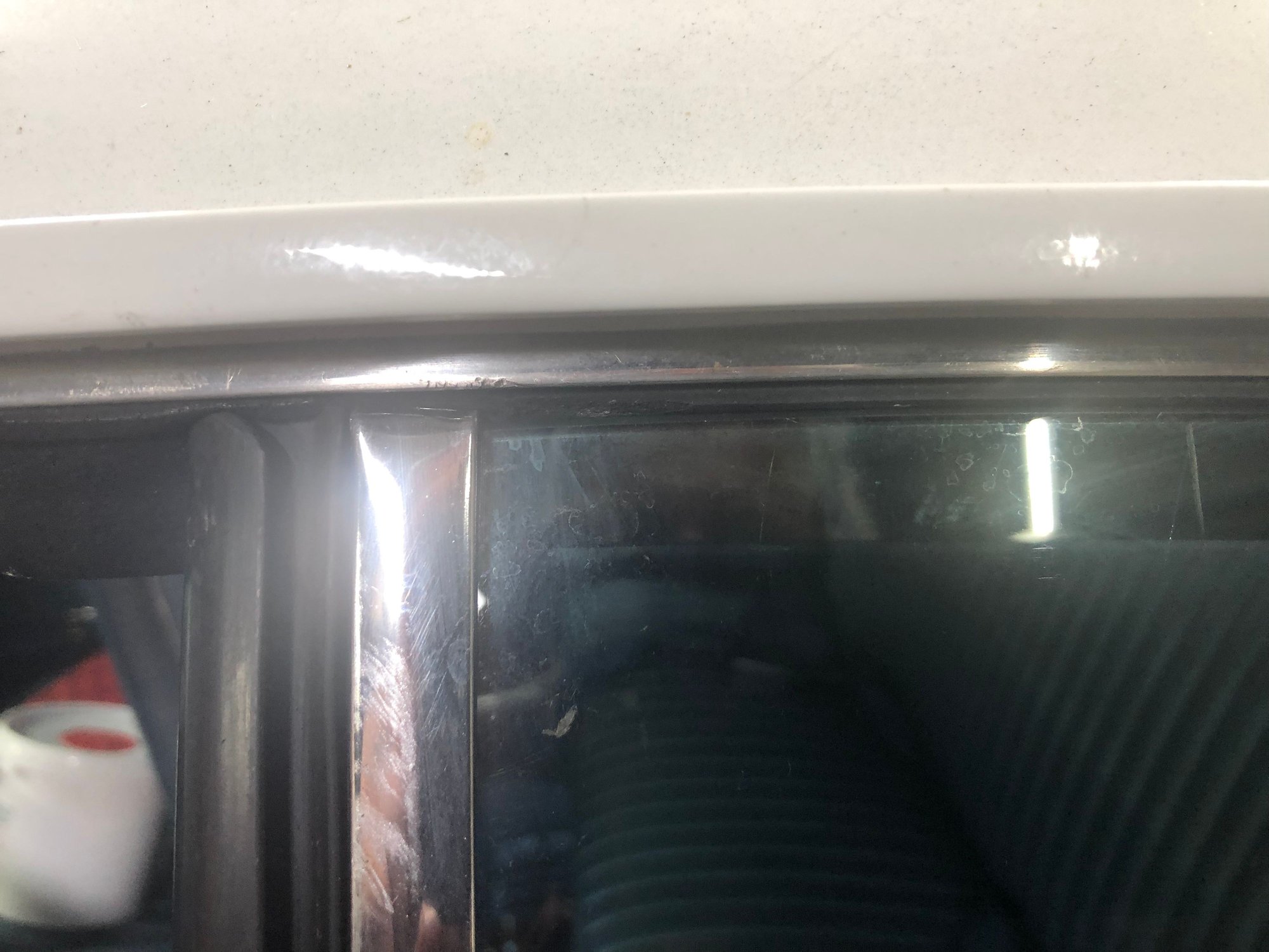

This is the drivers quarter glass where it meets the quarter panel.
This is the drivers quarter window in the fully up position.
You may be missing some of the felt bumpers that push the front window glass outward / outboard. They’re easy to lose.
Getting windows right (or close to it) takes time & patience. I have a few posts on what little know on window regulators and adjustment that describe what I’ve learned, right or wrong, over the years. I won’t rewrite all that here, but a few tips may help.
Starting with the rear quarters is the right move, unless you’re replacing door hinges. That’s a whole ‘nuther story. My logic is “you can’t move the roofline at the rear quarters, so make those windows fit first”. Then make the fronts fit the rears.
Adjusting In/Out
If you have trouble with the in/out angle when the windows are up, be aware that the adjustment screws at the bottom of the regulators affect the in/out-ness of the _tops_ of the window. As you turn those lower screws clockwise, it pushes the tops of the windows outward when they’re at the top of their travel. Sounds weird, but since the regulator channels are curved, those lower screws pull the window tops outward. When windows are in the down position, the rear channel locating bolts at the top rear of the door have more influence on the in/out-ness of the glass.
Also look out for in/out skew or glass toe-in/toe-out from front to rear. As they go up, both glass pieces should be parallel to the body panels and end up with enough weatherstripping gasket crush to form a water/wind tight seal.

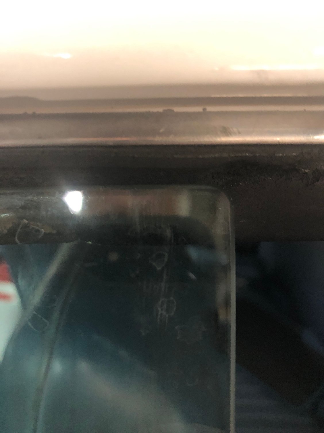

Drivers glass. It could go up just a bit more in my opinion, but for whatever reason the regulator won’t oust the glass any higher.

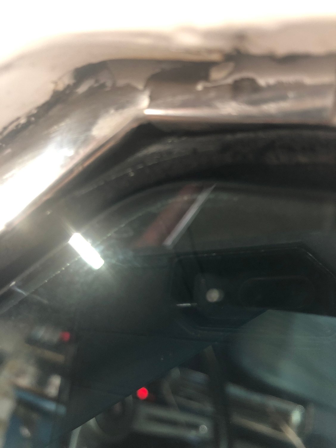

This is the upper

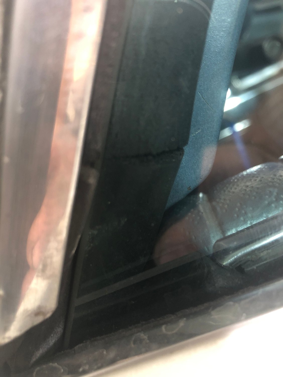

The lower corner, where the door, A pillar, and window all meet. Once again, fairly evenly contacting the weatherstripping.
And the problem I’m trying to overcome. With the quarter window up, when you roll up the drivers glass the window is on the INSIDE of the car. You can’t open the door, the door glass catches on the quarter glass. WTF?!

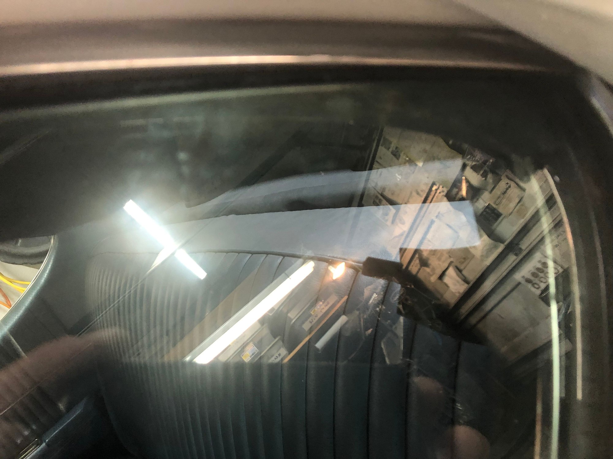

corner of the drivers window, where the glass meets the A pillar and roof. Once again, the glass fits the lip of the weatherstripping fairly evenly.

I saw the photos after I wrote that stuff above. Here are some thoughts.
Not a snark, but your sponge seal roof rail rubber looks a little worn. That makes your job harder since you’re trying to get glass to sponge crush rubber that’s further from the limit of glass movement. If you’re up for replacement, see if you can get a pair that have a proper corner on the front/leading upper edge instead of just one long extrusion. If want a quick fix, try my shimming suggestion above. Any foam rubber shim you get would go above the stainless steel that the roof rail rubber fits into. Rresh roofrail rubber = tighter seal
For that front driver’s window at the top, my first move would be to loosen the travel stops, if you have them. They are the vertical pieces of aluminum or steel probably with 7/16’s heads which may be preventing full crush of the window to the sponge rubber. In my cars there are front and rear stops. See your Fisher Body Manual for where yours are and what they look like. The idea with the vertical stops is to wind/crank the window exactly where you want it for tightness, then secondarily tighten the stops - maybe even a 1/8” low to make the window just a tick tighter.
Make sure that the rear quarter window is pushed rearward enough into the sponge rubber to make a seal, but not so far that it prevents the rear window from crushing into the upper roof rail rubber. It looks like you might have an 1/8” to 3/16”s to work with there.
Make sure that the rear window is adjusted to crush inward a little tighter against the roof rail rubber. This may ease the front/rear interference problem. If the rear window is tighter inward, the front doesn’t have to be so far outward to clear up when raising. This is especially true of the rear window leading edge which (against my advice above) you may be able to **** inwards a degree or 2 to make the clearance problem better. If front and rear inward tightness are a little different, that’s o.k., but not much more than a few degrees.
The last trick I’d recommend is see if the trailing vertical edge of the front windows are parallel to the vertical chrome edge of the rear quarter window. If they’re not parallel, your front window is cocked up or down on the fore/aft axis. Again a degree or 2 of up/down cocked attitude may be fine, but not 20 degrees. In fact in my cars the roof shape more or less requires the windows to cocked down to the rear just a few degrees. Your car may be different.
Across all these adjustments very fine movements matter. That’s a part of what makes it so time consuming. I walk away when I get frustrated and come back when I’m calm. Put the radio on on the background, have a snack, and take your time.
