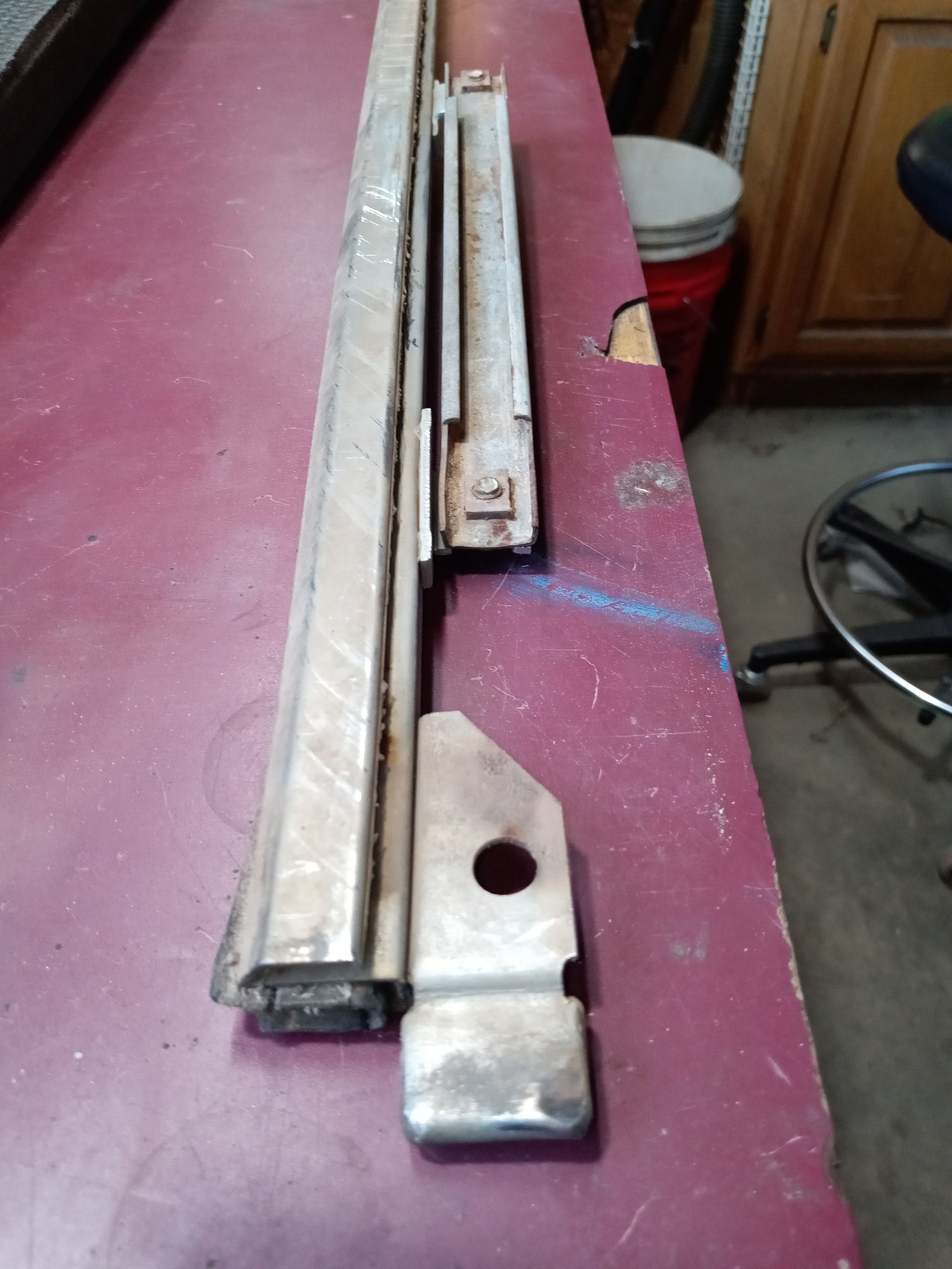

I got it
Is this it? Don't know about the deflector but this is the sash and the two connecting bars. If you want it send me your shipping address and I will find out how much shipping would be.

That's it Dan! How much are you looking for? My address is: Robert Green, 6 Thames Reach, 80 Rainville Rd, London, W6 9HS, United Kingdom.
