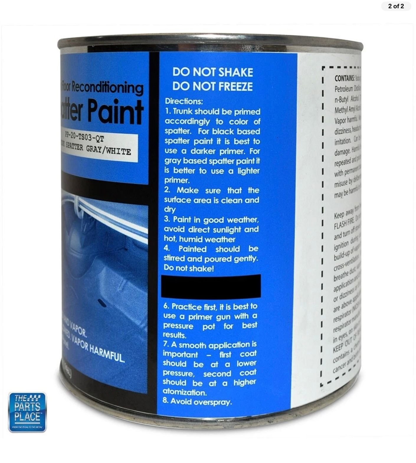

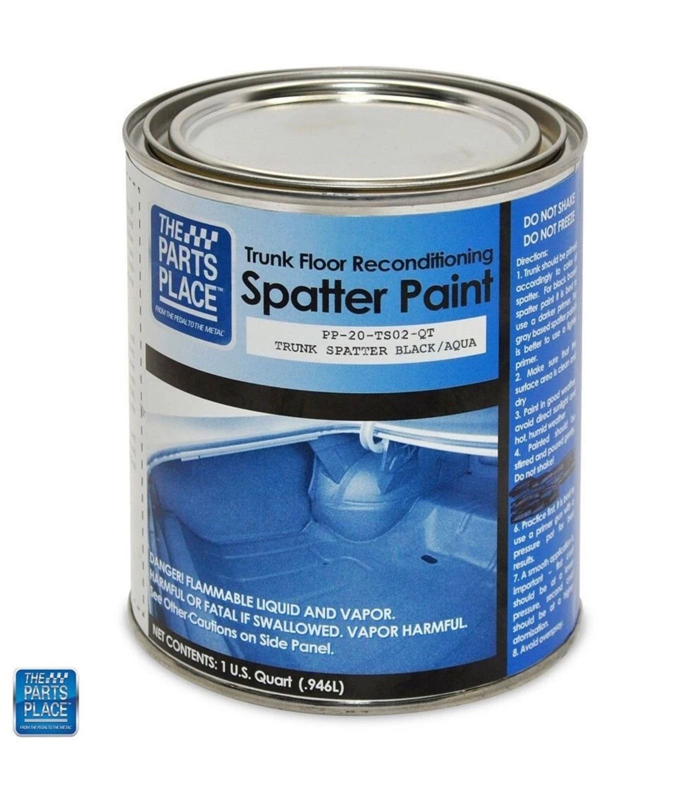

I use this stuff from the parts place. No clear and it holds up well. Probably not an exact match to the factory colors but it looks good
Did you spray it with a schutzgun or HVLP gun?
Old Nov 27, 2025 | 04:14 AM
rkk69olds's Avatar
Joined: Oct 2010
Posts: 172
From: Melbourne, FL
Hvlp

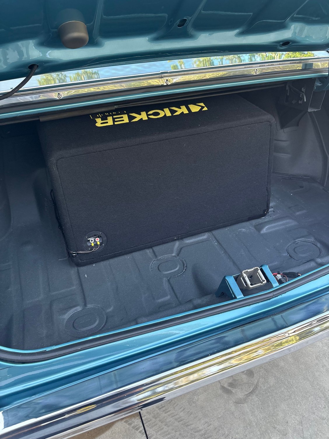

That's what I used and just used a spray gun with the largest nozzle it came with. I don't have specifics but it was a hair smaller than was recommended and still turned out. I wish all car painting was that easy lol
Look here for pics https://classicoldsmobile.com/forums/body-paint-66/1970-olds-442-trunk-paint-options-188303/?utm_source=share-link&utm_medium=button&utm_campaign=share&utm_cont ent=post#post1658982
