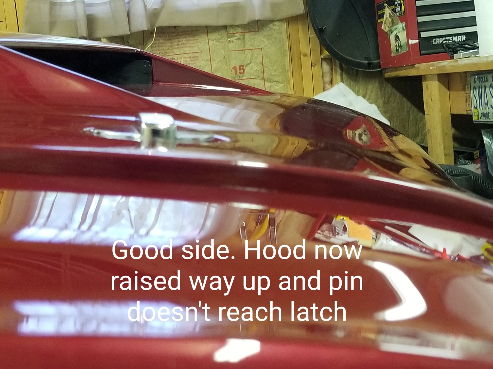

First time owning an OIA hood. Fiberglass with steel frame. This was repaired once before I purchased the car but I'm getting some hairline cracks /fractures in my paint (possibly fiberglass itself) again around one of my locking pins. The hood does drop lower on that side a bit . The other three corners are lined up pretty decently. Is this cracking common? Will an adjustment of the rubber stopper on that side help this? One concern is will the pin still reach it's bracket if I raise the rubber stopper a bit. Any tips would be greatly appreciated. I'll include pics.

Regarding fit...
The factory OAI hoods didn't fit that well from the outset. Your hood droop is not unusual.
If you look closely you can see your chrome trim on the hood is mis-positioned, making the droop look bigger. If you correct the chrome trim placement, the droop appearance would be within normal range.
Don't use the hood bumpers to try to correct this; that will cause stress in the fiberglass. Adjust the bumpers to have light contact. And make sure you have the third bumper (near the latch in the center).

That's interesting. Thank you. I don't believe I have the center bumper definitely going to look into that.
But what about the cracking/fracturing in the paint around the lock. That's my true concern. Is that common? Should I be trying to close that hood more gently. Maybe dropping it from a lower height or not dropping it at all? What's causing that fracturing?

Good pictures.
We can see some possibilities for the source of the stress cracks.
In the first picture, there is a crack in the hood frame, starting at the round cushion pad and extending back beyond the hood-pin retainer. Also appears to be a delamination between the hood frame and the fiberglass. Look to the right of the hood retainer, near the edge there is what could be a crack. Examine that spot.
In the second picture there is evidence of heavy contact between the hood pin retainer and the core-support bracket. The upturned edges of the bracket have been hammered down in two areas. The aft bolt of the pin retainer has contacted the bracket.
That contact would cause the stress cracks on the fiberglass surface and in the hood frame.

Engr
The crack in the hood frame must be welded. A Corvette repair shop or a skilled welder can do this without damaging the fiberglass.
The hood pin engages the core-support bracket about thirty thousandths forward of center. Sometimes you can adjust the hood pin retainer to center it better. At worst you will need to nudge the hood back at the hinge. Use some modeling clay to see where the pin engages the retainer. This will prevent contact between the pin and the bracket.
The impact between the bracket and retainer is more serious. You will need to adjust the hood hinges to give more room between those parts, even if other parts of the hood wind up too high.
Remove the rubber bumper, put your modeling clay in the area where the retainer bolt hits. Close the hood gently and engage the pins. Adjust the hinge until you get clearance between those parts.
The delamination between the hood and frame will require adhesive to repair. This is another job for a Corvette shop.
