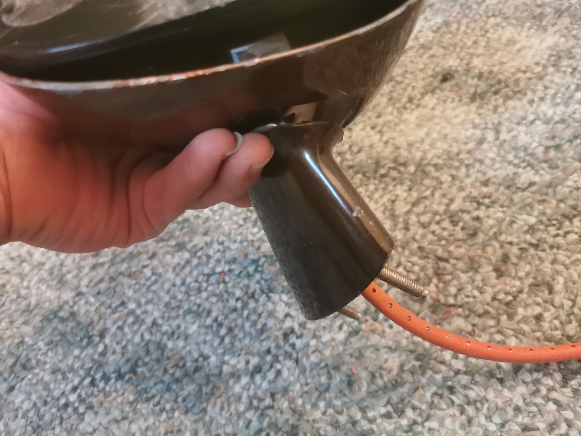

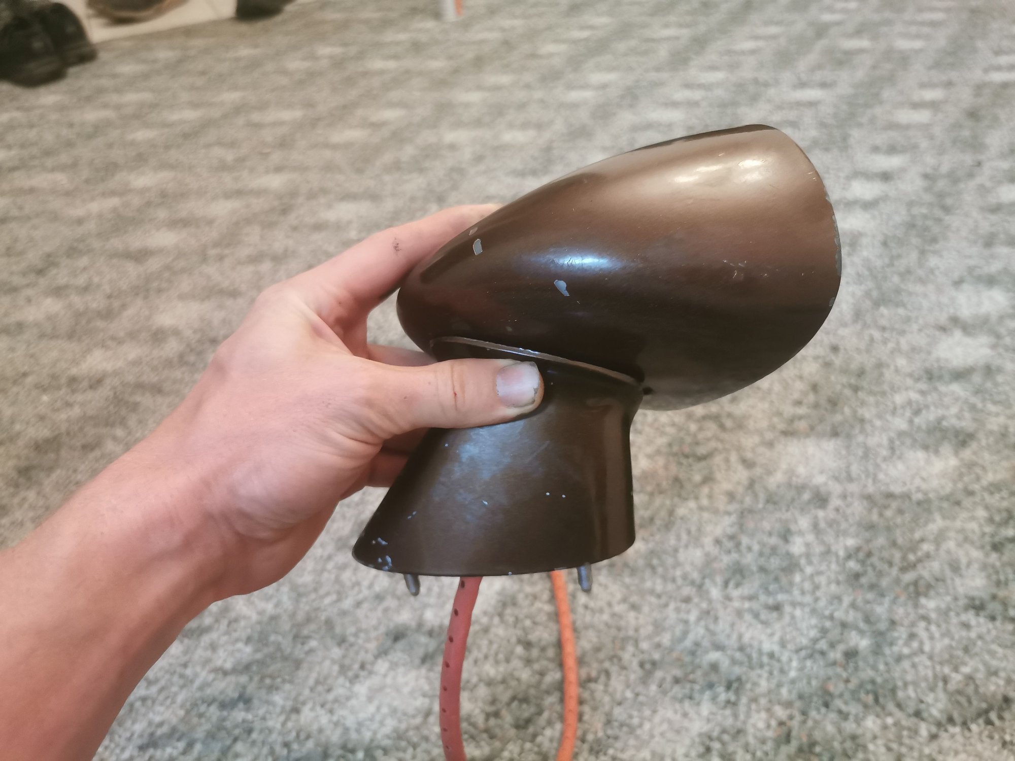

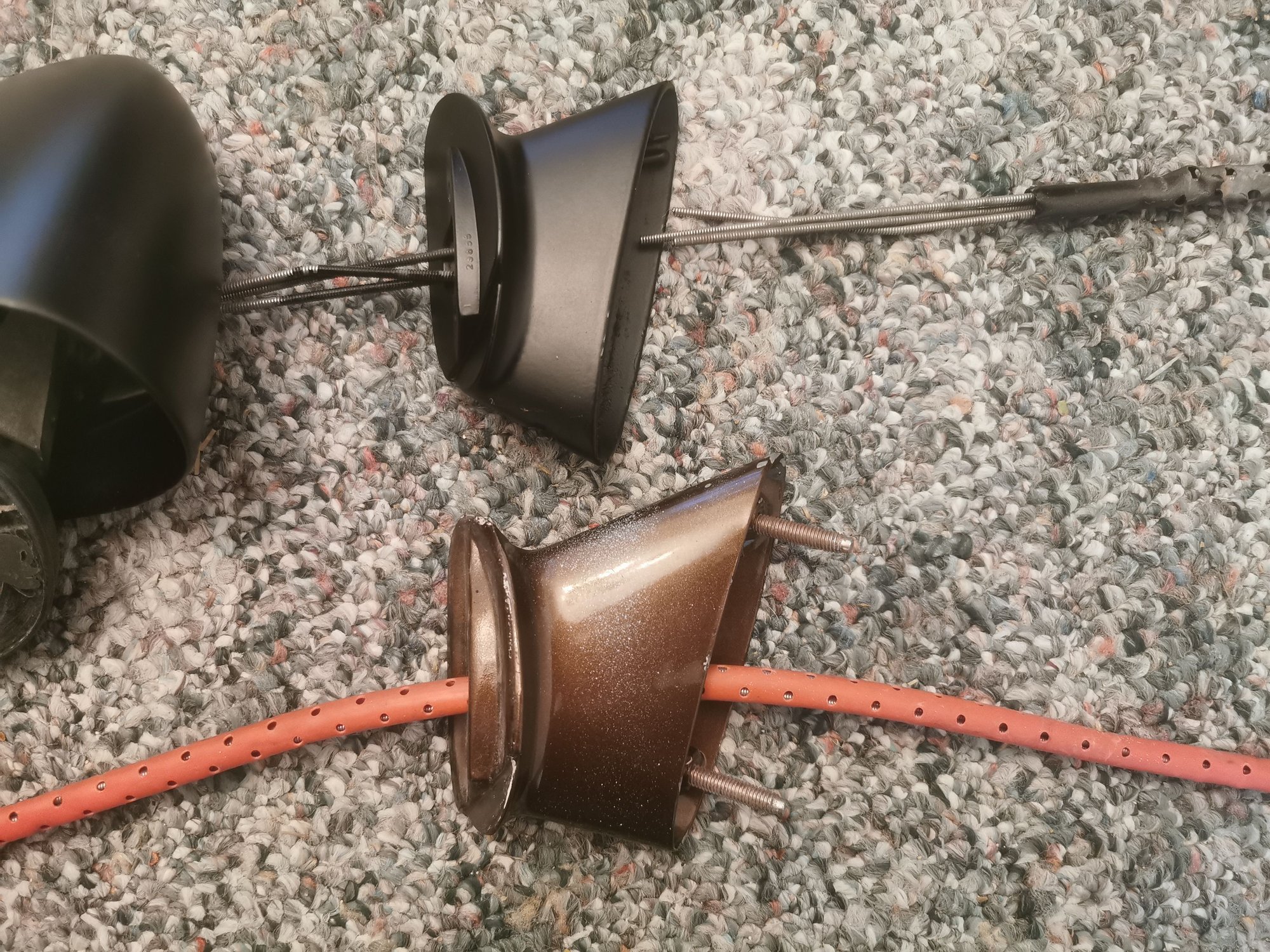

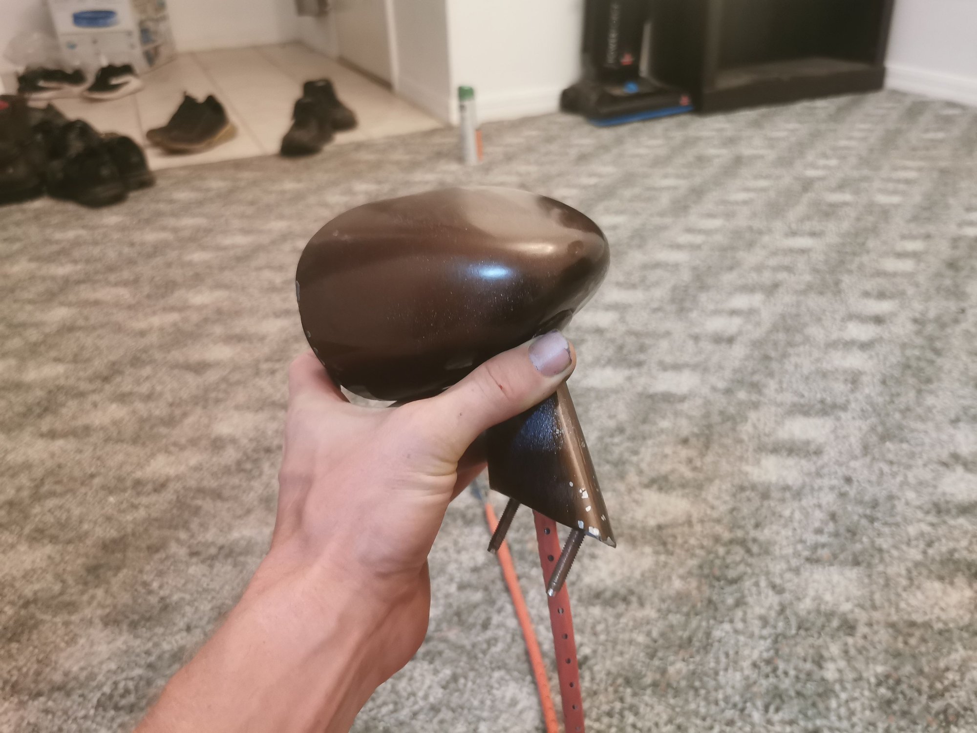

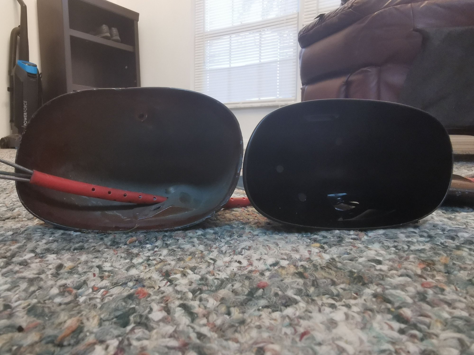

Hello thank you for reading and sorry if this has already been asked but does anyone know if any 1972 oldsmobile cutlass had mirrors like this brown one? The black one was on my 72 oldsmobile cutlass supreme and I bought the brown one to use the remote for my black one but it won't work because it's bigger and
Different and the guy I bought it from said it fits 72 oldsmobile cutlass. Is this true? Did they have different styles? I'm wondering if this was my mistake or if the guy lied to me and it's not even for a 72 cutlass. Thank you dearly guys

They look similar to 71-72 mirrors, but the Cutlass mirrors don't mount with long studs like that; they mount onto a base that is attached to the door.
Pictures on this site show the mounting scheme:
https://www.opgi.com/mirrors-hardwar...e-c241517.html

That looks like a later 70’s early 80’s cutlass mirror. They look similar but the parts are not interchangeable. For your 71/72 mirror you can use 70-81 Camaro/Firebird sport mirrors for parts.

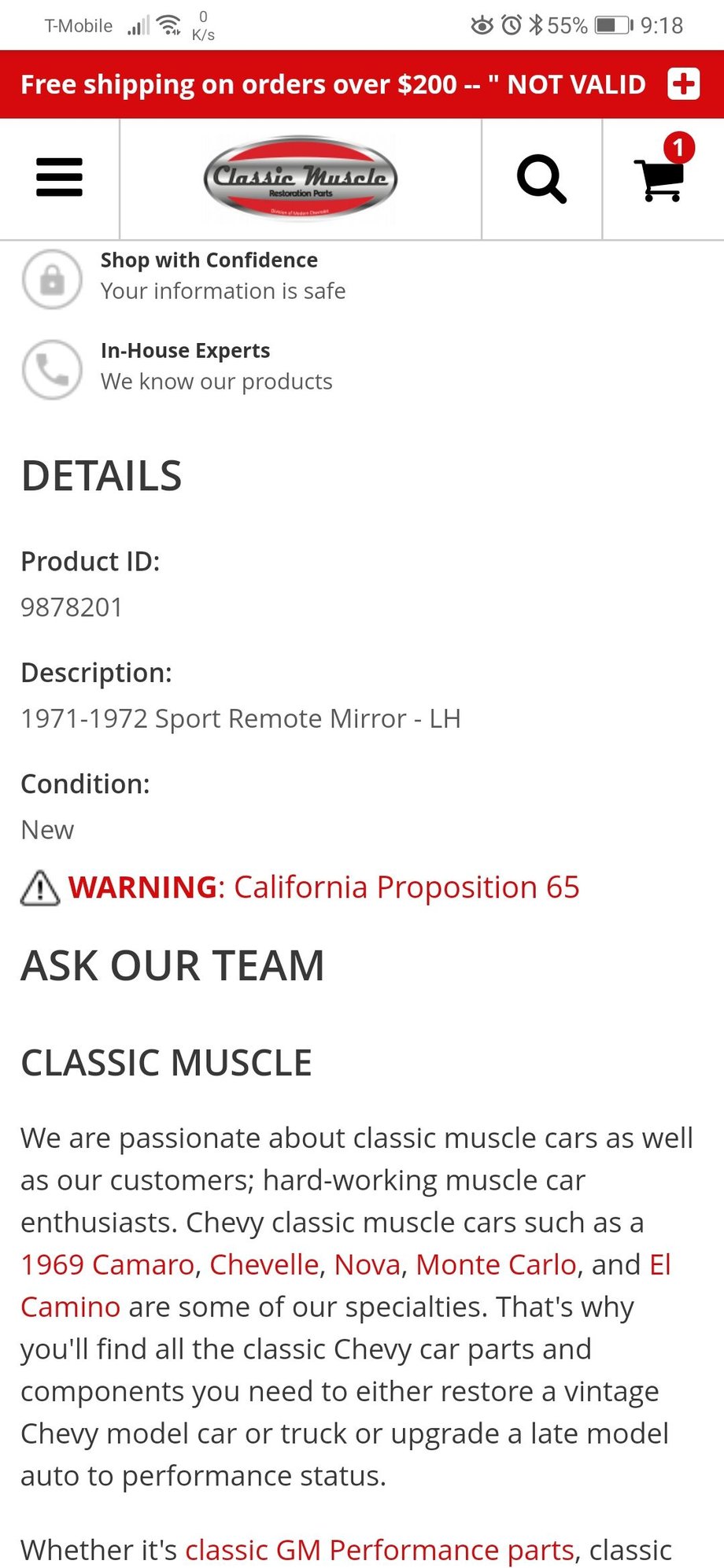

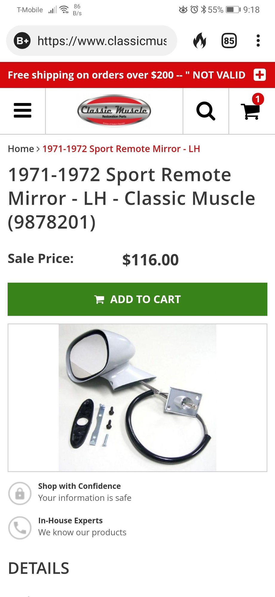

Do you know if this Is the right replacement? Since opgi is out of stock I think I'm gonna bite the bullet and order a brand new one

That one is correct. You might want to do some research, I know the 70 only repro mirrors have issues with paint not wanting to stick. I’m not sure if these have the same issue though.

I think 4speed has it right later 70’s early 80’s cutlass mirror.
