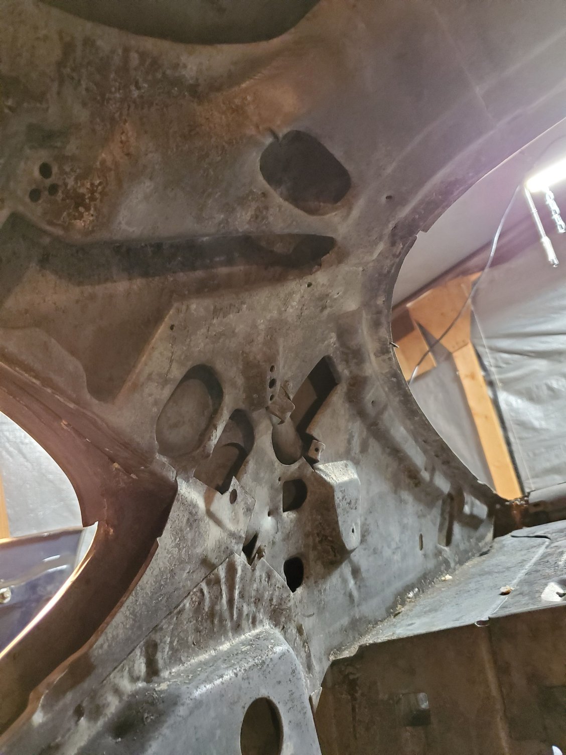

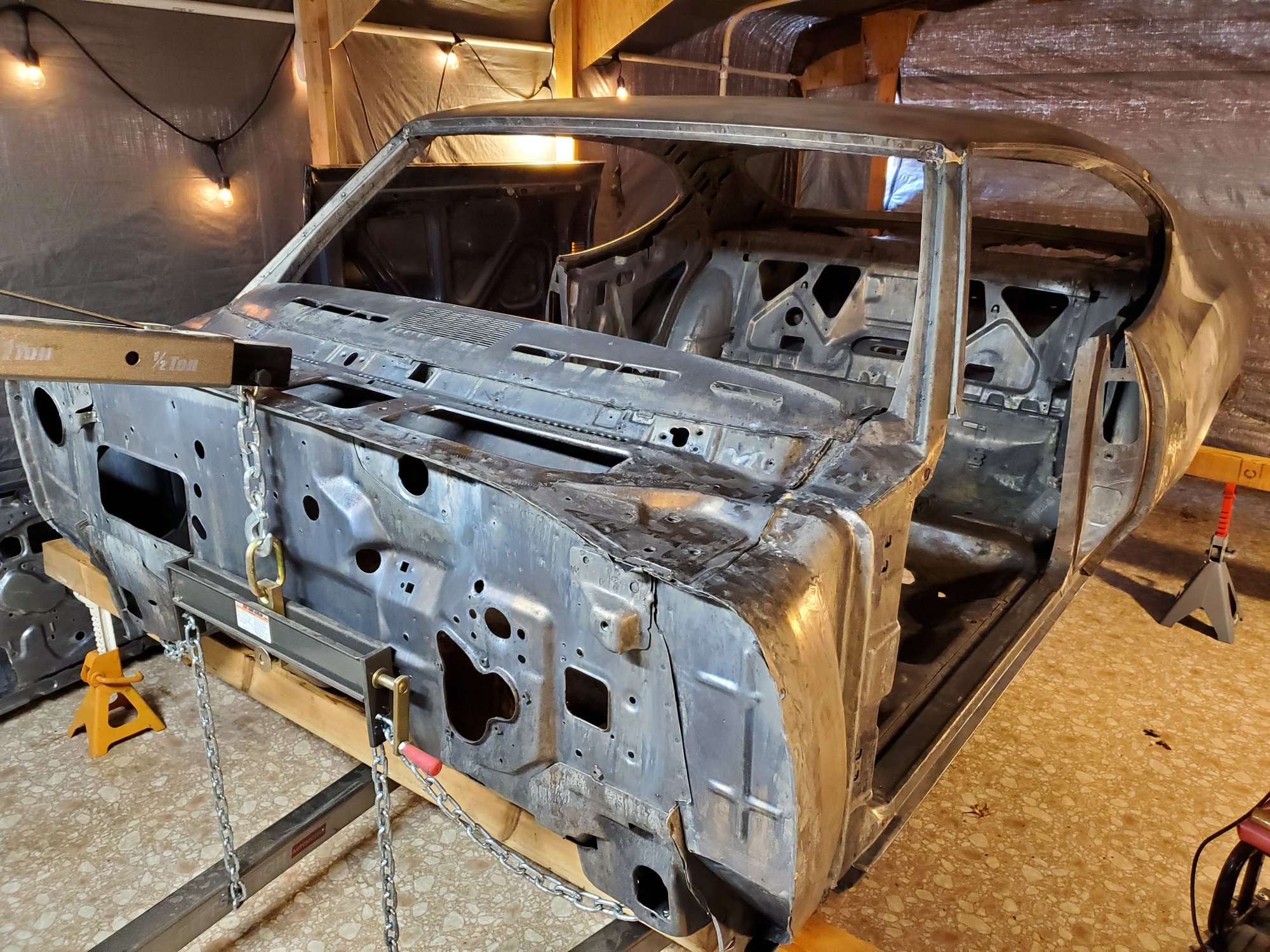

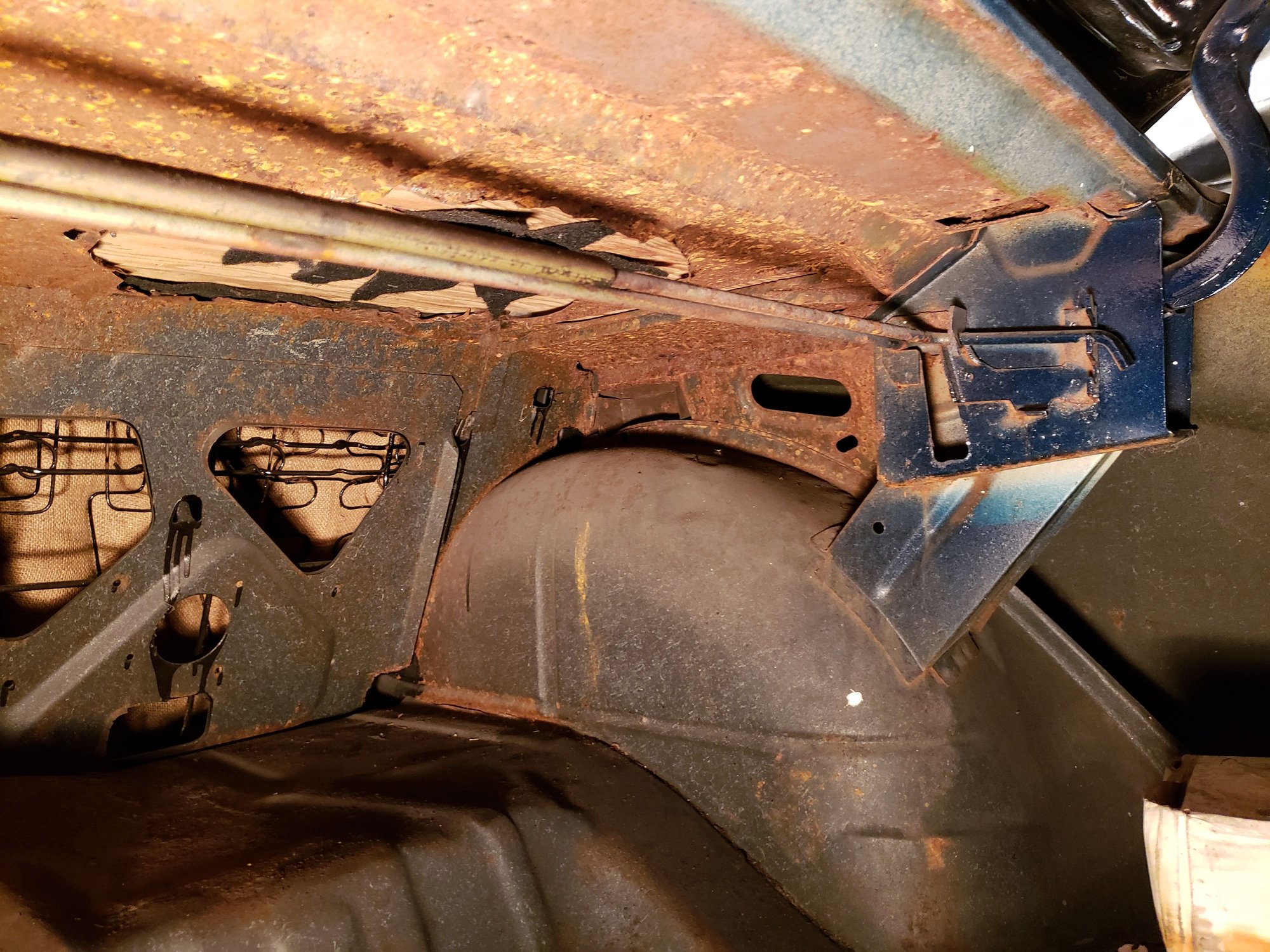

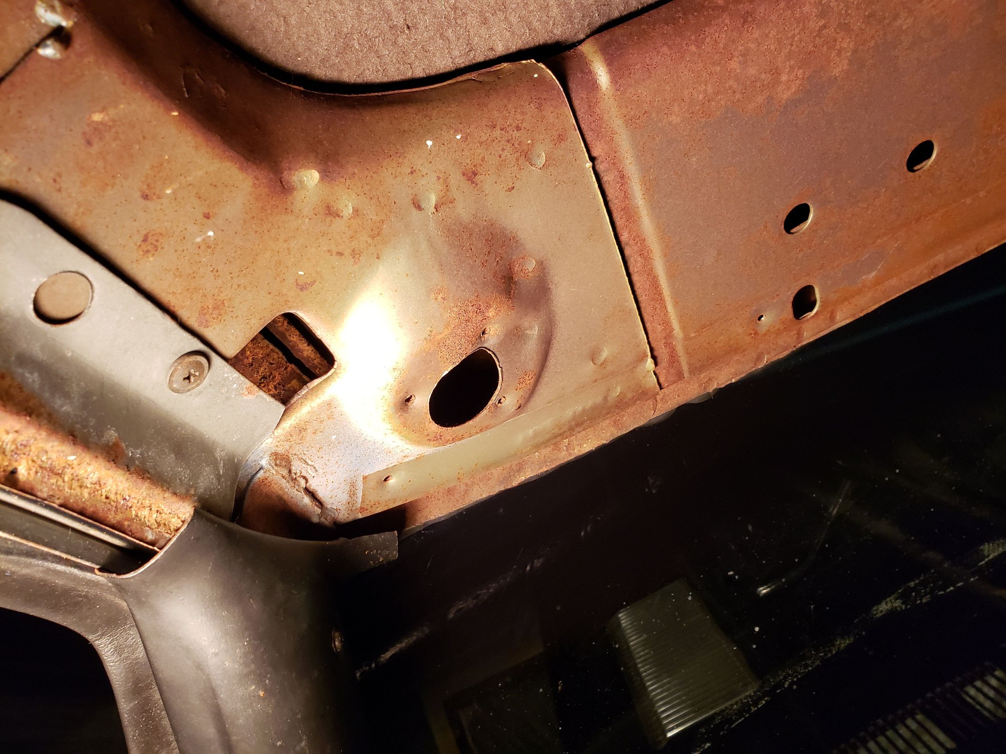

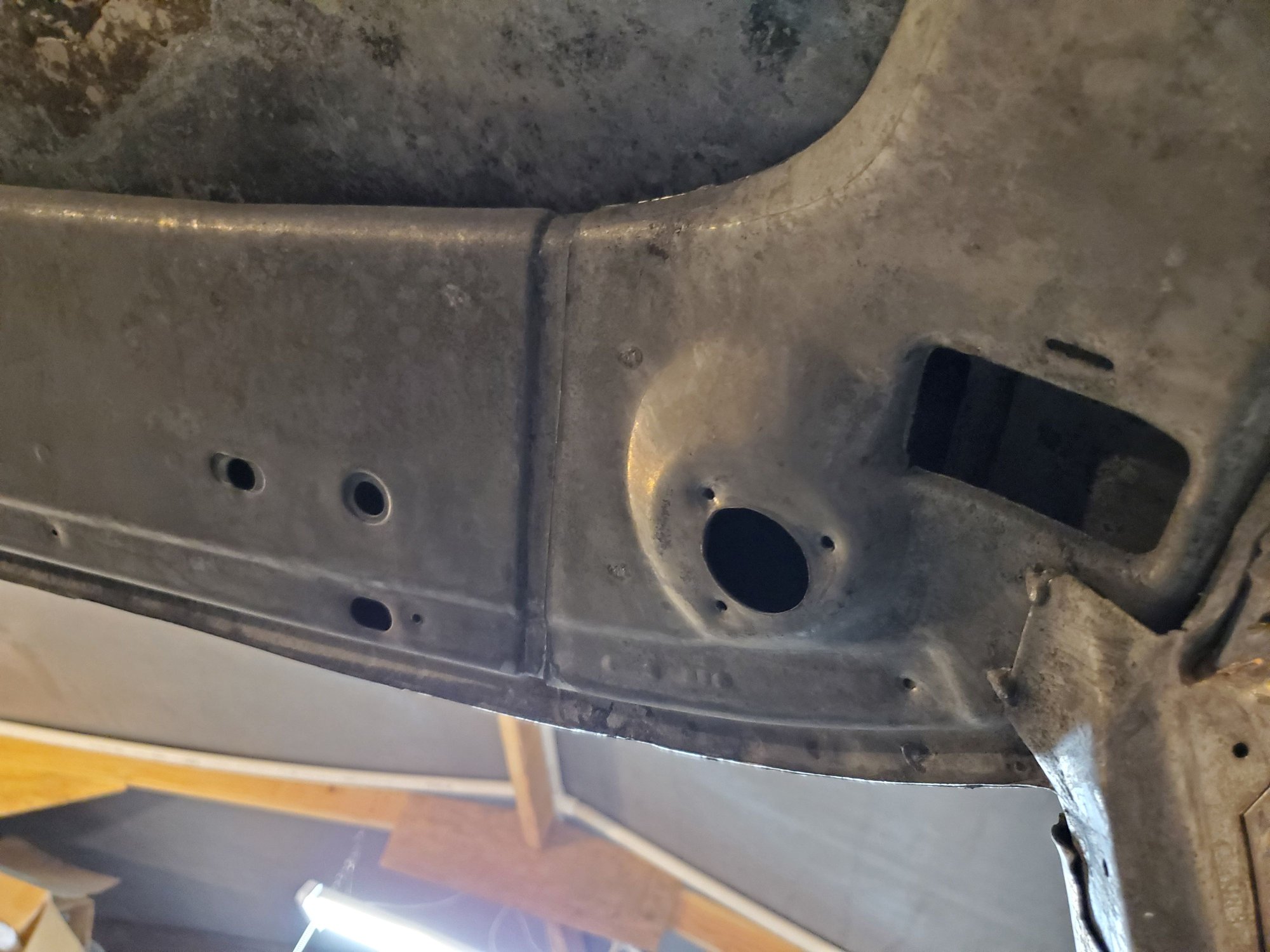

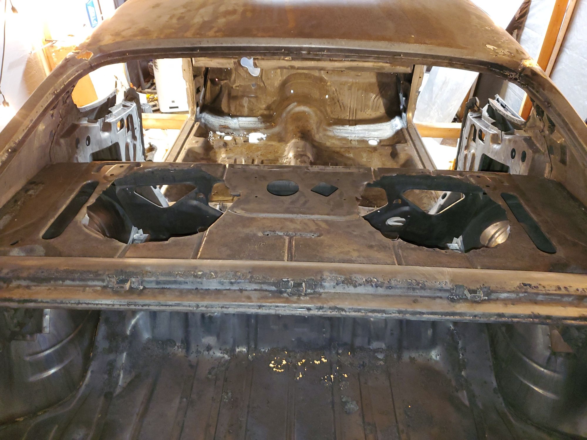

I got the car back from the dipping facility today, they actually dropped it off in an enclosed trailer at no charge. It is a multi-stage process starting with an caustic bath that eats the paint, a pressure wash, acid bath that eats the rust, another pressure wash, then it gets hosed down with a rust inhibitor and finally dried. After looking it over I am glad I had this done. If anything, its the peace of mind that you know exactly what you have and all the crevices that you can't reach have been cleaned out. My car had a lot of surface rust that looked bad but after getting the car back it is much less intimidating. There were several spots that looked a lot worse than they were. With that said, I'm going to be replacing a lot of sheet metal. Here are some before and after pics.

In one of the "after" pics, the roof looks rusted but this is just the lighting. I am told that the rust inhibitor should last a year if the parts are kept dry.
