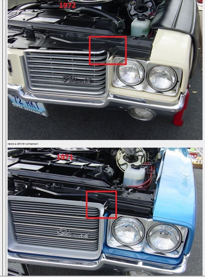

Sounds like you need a 72 core support if you want to keep proper grill mounting. A 71 will work but I think you'll need a 71 grill because a 72 grill doesn't mate happily with a 71 support. I haven't tried a 70, to me, they are unique to 70 only. Look at the pictures to see the "bump" on 72's. 71's don't have that.

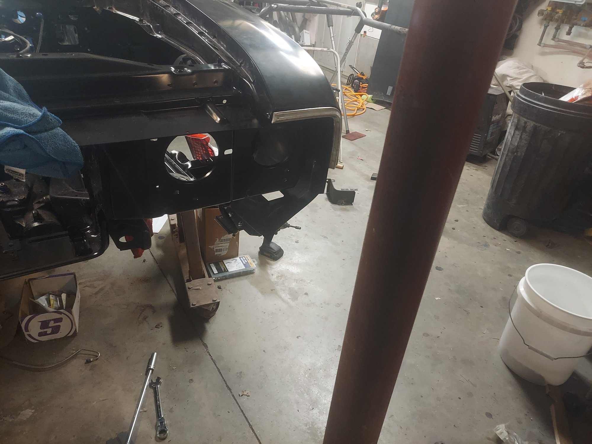

I am going through this right now. On my 70 cutlass drop-top
I have a new "70-72" core support it has 70 fenders to core support spacing.
I believe the hood latch location is different as well.
I'm in the process of removing the support from the 71-72 new fenders and replacing it with the 70 support.

The 1972 radiator core support has a raised area to allow for grill fitment.

Just found out the profile of the fender is also different between the 70 and 71-72
I had a beat-up eyebrow and decided to see what it would look like blacked out.
You can see the difference in the profile the 70 has the chrome eyebrow the blacked-out one fits the new fender brace.

No it isn't. In fact, Olds superseded the 1970 fender part number with the 1971-72 fender as soon as they came out. Your trim piece is bent. The problem isn't the fender.
That's what I thought.
I am surprised the bent trim matches the profile of the new fender support almost exactly.
I had to bend the fender slightly to get the 70 support lined up and the chrome trim matches.
So other than the crinkle bumps the fenders 70- 71-72 should be the same?
How are you supposed to mount the fenders to the core support?
The bolt pattern on the 70 is approx 4 inches apart whereas the 71-72 fender is closer to 3 inches.

baffle that bolts to the front of the fender.
The new fender had the baffle tack welded in and the holes to mount to the core were close to 3 inches apart.
The 70 baffle bolts in and have the holes approx 4 inches apart.
You can see the measurements in post #3
