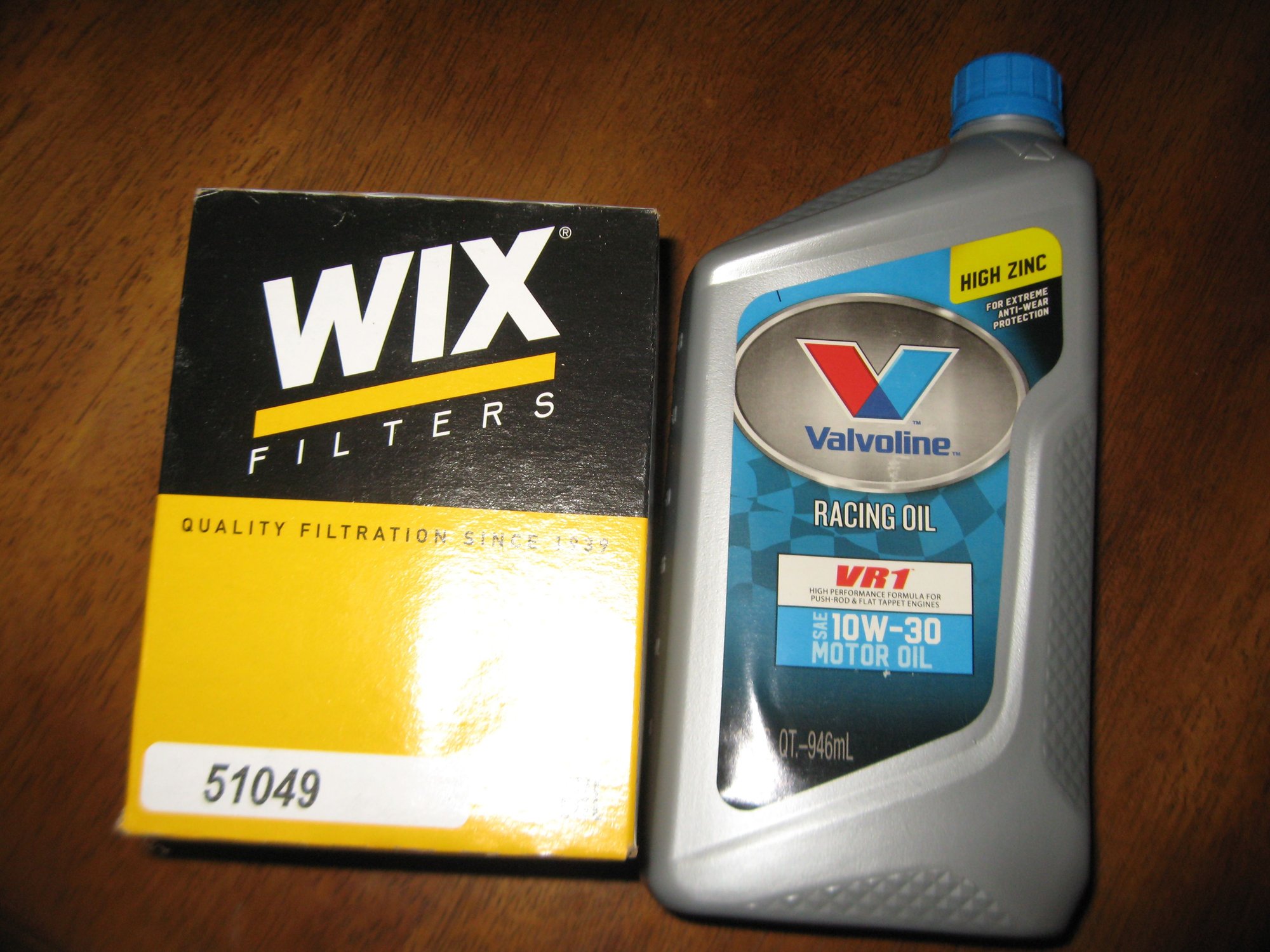

These are what I use in my Oldsmobile.

That is exactly what I use tru-blu. I have used Wix filters for many years. NAPA Gold is supposed to be the same filter. I would never use a Fram filter. Way back they used to be good but not anymore.

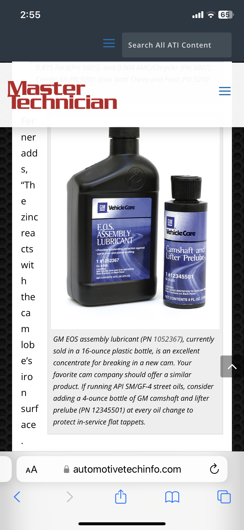

Old Dec 11, 2023 | 08:42 PM
gs72's Avatar
72Cutlass S
Joined: Jul 2011
Posts: 1,201
From: Bakersfield, CA
Old Dec 11, 2023 | 08:43 PM

Right, wrong, or indifferent..I use Amsoi Z-Rod 10w40. I'm fairly certain it has a Wix filter on it (usually I run STP, that's why I'm not sure) but remember years ago reading a filter comparison done by Herb McCandless. He swore Baldwin filters were far superior to anything else on the market. I personally haven't tried them, but know a few who have and so far have agreed.

Plenty of informative threads on this subject, bearing clearance stock vs race, heat of use , plenty to read if someone is interested.
​​​​​​Dulalec Ultra 15w40 has high concentrations
